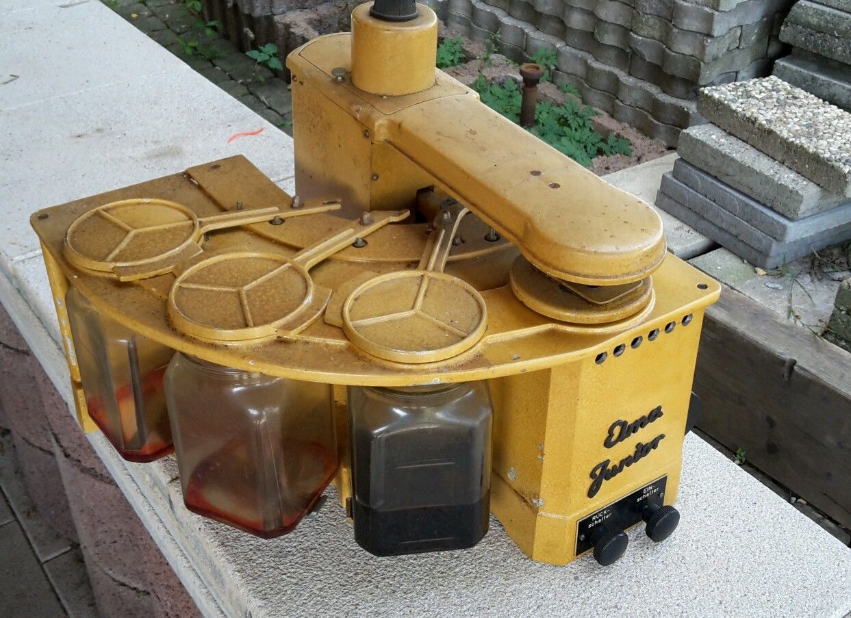

Are there any of you who use a Elma Junior cleaning machine?
I need some technical information and possibly. pictures or video of a working machine!
