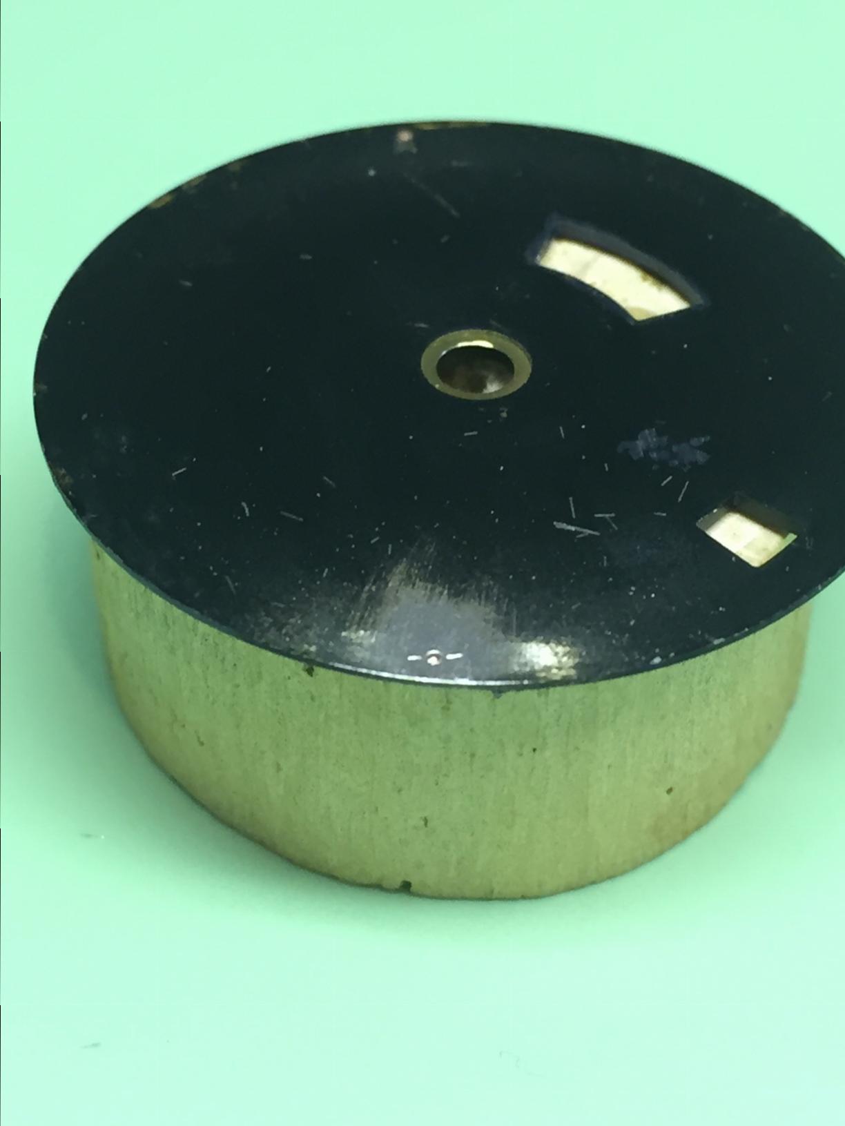

While waiting for my flux to arrive from Germany, I did much experimentation on junk dials. I finally found a solder that worked. I ended up using a solder paste that I found on Amazon. This makes the job real easy as you don't need to cut up and align little bits of solder. I used a small applicator to apply a dab of paste to the dial and the foot. The paste has flux in it so no need to flux separately. When soldering you need to keep the current flowing for a few secs. You can see the paste boil and then you'll see a flash of shiny metal as the lead melts. When that happens - heat off!
For the feet, I used 20 gauge copper wire.
Pic is from my Baume & Mercier GMT Capeland that had the dial glued to the movement!

the  original pins were brass wire soldered on a brass dial,  or the like.  to  re locate the pin  or pins is near imposible..   so;  double back tape (spots mentioned above)  is the way to go for one or all pins.  vinn
I have a mixed assortment of Bergeon, copper dial feet, they've been somewhat helpful, but without soldering them in place somehow, or unless there's a particularly good industrial cement out there, the feet won't be very secure and may snap loose during the fitting of the movement/hands. (not being supported by the frame and case, this is when they're most vulnerable) A lot of people really like the dial stickers but I've worked on so many watches that weren't running properly, offered to fit a new movement to the watch, and after taking the hands off seeing that the canon is grinding up against the inside of the center dial hole and finding the movement wiggles on the dial... I really try to stay clear, I'd rather try a fix that was more all or nothing than have a situation where the movement might drift slowly out of place and start malfunctioning, leading to confusion/complication.
Edited by Ishima
I did do a lot of experimenting & research with this & the issue is you have to generate heat without staining the dial side. I found the best result was to have the dial side on a damp sponge & to use solder paste. However it still was not perfect the resistance machine is the way forward but a lot of money. My advise is to clean the inside of the new dial adjust the new dial feet to the correct height then attach them to the watch. Then the dodgy bit. Attach with a glue such as JB weld & put a piece of thin plastic around the feet (in case of spillage) and attach the dial & leave for 24hrs.

I do similar to clockboy and glue copper dial feet. I use the same technique, except that I cut a small piece of plastic and pierce a very small hole in it before putting the dial foot through the hole and screwing it to the movement. This ensures a tight fit of the plastic around the dial foot, to prevent spillage. I use fast drying 2 pieces epoxy resin.
This technique was learned the hard way. Believe me it takes a lot of effort to remove the resin once in the movement!
