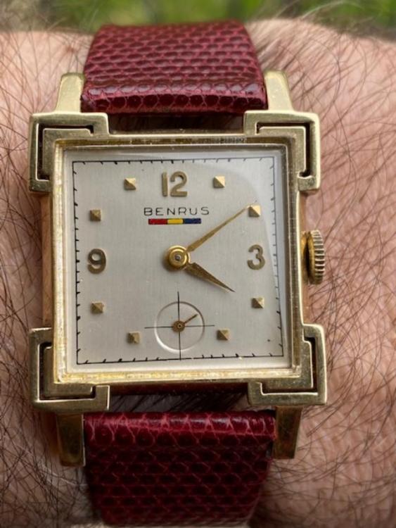

 I really like the 1940's art deco style but it's hard to find a large case. This one is unusual in that it's 28mm.
It's one of my top 3 & I probably wear it as much as my black strap watch because oxblood goes with almost everything.

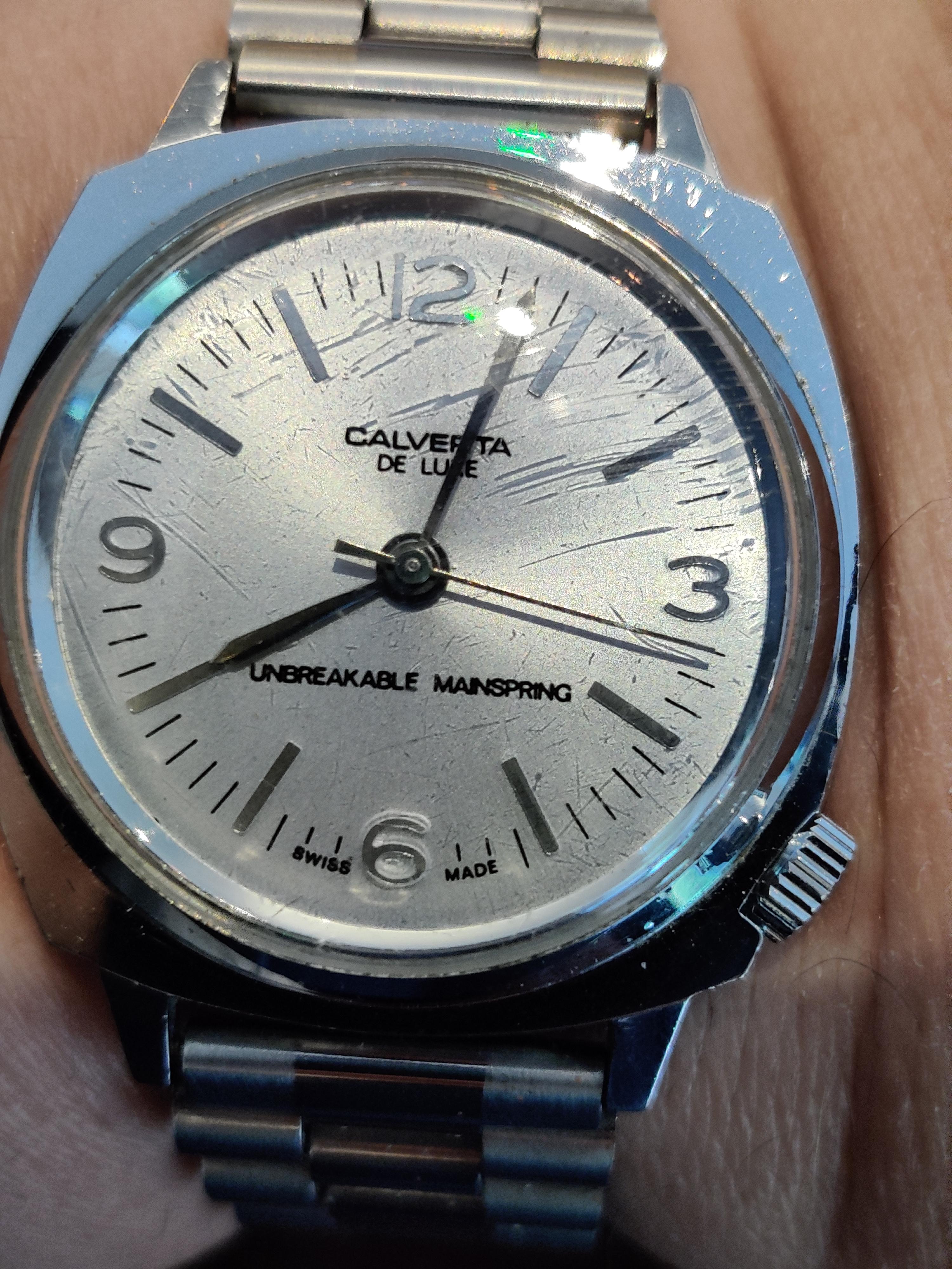

Thought I'd show the watch I've been wearing for the last few weeks, picked it up and gave it a bit of a clean and a strap I had and so far it's keeping great time can't find any info online about the make though ☹️ (if anyone knows anything I'd be happy to know)
Tried taking the scratches out of the crystal with polywatch but no joy so that might have to be replaced.

Did you hit it with sandpaper first?
For this one, I would work it over with 800 grit (or maybe 600) and then follow up with 2000.  Then polywatch.
The thought of taking sandpaper to a crystal is terrifying
I know it would work but it's still terrifying

isn't just the sandpaper, you have to use a rotary tool also. Unless you want to spend 4 or 5 hours at it and end with sore arms.

With a crystal like that I would start with a small piece (1"x1") of 180 grit wet & dry working under a running tap, then work up through 400, 800, 1500, and 2500, all under running water. Then polish with Solvol AutoSol. Maybe 10 minutes max start to finish and will look like new.

If that is about a plastic crystal most of the time sandpaper is not needed, abrasive compound works good.
Even for mineral glass in my experience of doing many I have found that stepping through so many grades of paper is a waste of time and money, two grades plus diamond paste are enough.
