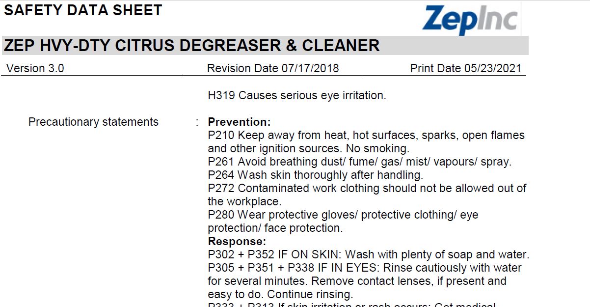

The cleaning method must be not just work setup friendly, but also girlfriend-friendly. XD  Somehow I don't think she'll be too keen on having me store jars of lighter fluid around the apartment.  And the cleaner I use is not ammonia based so I don't worry about the safety of the procedure on the watch parts.  I've done about a dozen watches with this stuff (https://zep2.zep.com/product/zepcommercial/heavy-duty-citrus-degreaser),
Expand
Having just now looked at the material safety sheet for your cleaner I recommend you don't read it if you think ammonia is bad for your health. Then you have to keep us up-to-date on how well this works.
Expand
To be fair, I never said ammonia is bad for your health XD
Correct me if I'm wrong, but checking the SDS, the only thing listed as a potential hazard is the fragrance, which falls under an allergen.
Even then, I searched for each ingredient manually.  Sodium hydroxide is possibly a hazard if touched, and I couldn't find a lot of information on Trisodium NTA, but otherwise, the remainder of the ingredients I couldn't find anything significantly hazardous.  Some of the ingredients are used in cosmetics and as food additives.

Are we looking at the same safety sheet?

  On 5/24/2021 at 6:22 PM, JohnR725 said:
It's usually what everyone complains about is the smell of Ammonia.
Expand
My mistake, I was checking the ingredient list.  There is the SDS, which is what you have posted.
