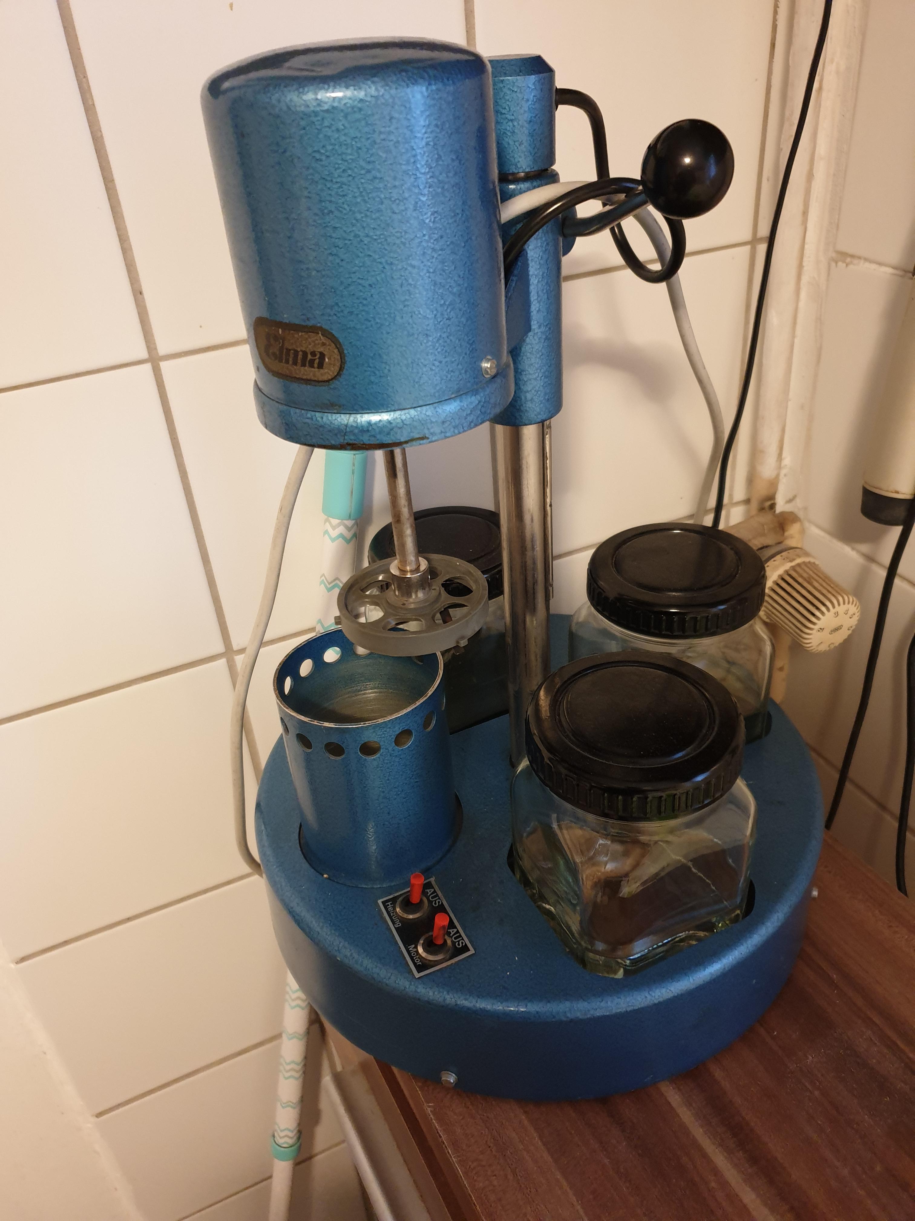

I also have an old Elma, which I got at an Ebay Auction. I use the machine to clean the movements.
I bought the fluids from elma. 1st Jar for a cleaning solution and the 2 others for the rinse.
The parts come out if the machine really clean and shinning.  Its beautiful!
