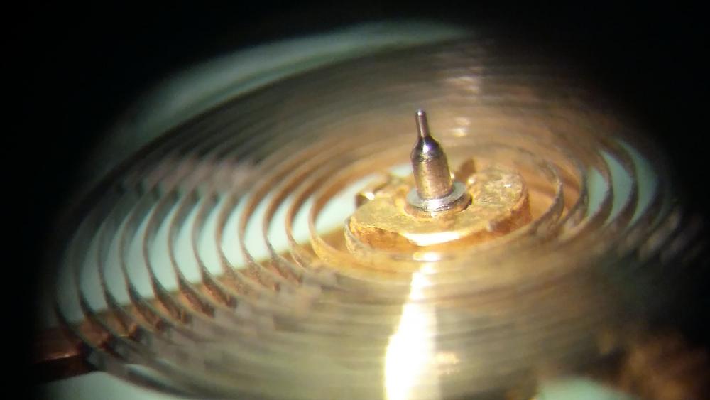

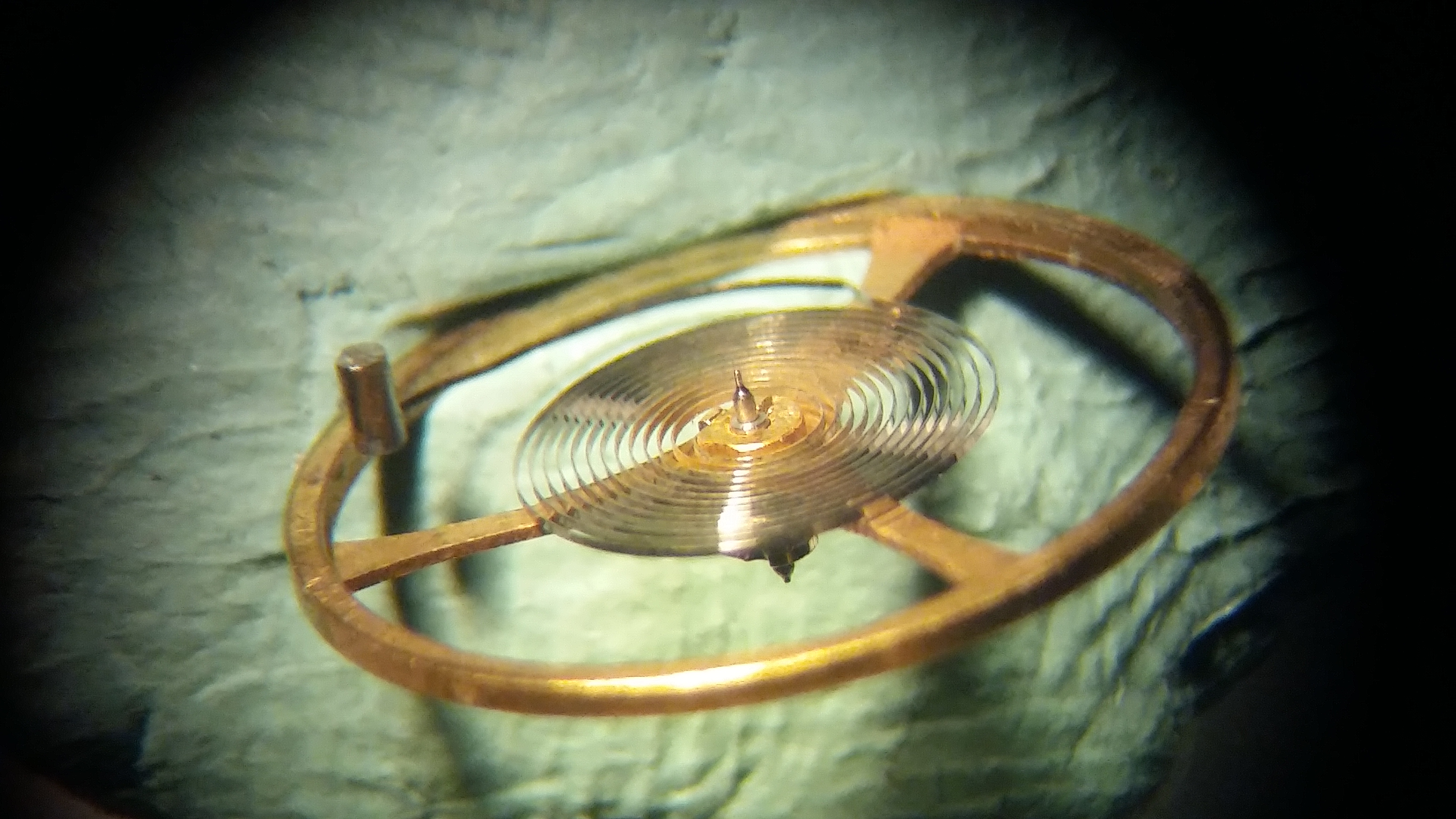

So I got myself a sorry-state russian microscope (4x-100x) (I believe it's been dropped, so I fixed the broken stand, I cleaned it and I aligned the glass prisms the best I could - work in progress). For more details on the microscope model, checkout http://microscope.modelengines.info/.
Samples below. The pictures are taken with a phone by putting it on an eyepiece. The subject is a beat-up balance wheel from a Poljot 2209. Looking through the microscope, the image is clearer, with better contrast and, most important, stereoscopic.

I have now cobbled together a eyepiece adapter for my MBC made from a old canon extension tube and a turned aluminium tube that fits over the eyepiece.
Using it I have found the 8x eyepiece to be optically better than the 14x at low magnifications the fall off around the edges is very pronounced with only the central portion of the frame sharp as in the example below1_zpsalbllgnn.jpg
But this improves as the magnification increases,
Contrast and sharpness are good Russian optics have always been good, having taken a lot of equipment and manufacturing facilties when germany was split after the war, but there is no depth of field to speak of so focus is very shallow in all these pic I have focused on the top of the centre wheel pinion,
The scratches on the top of the pinion are pin sharp but focus falls off on the screw heads,
