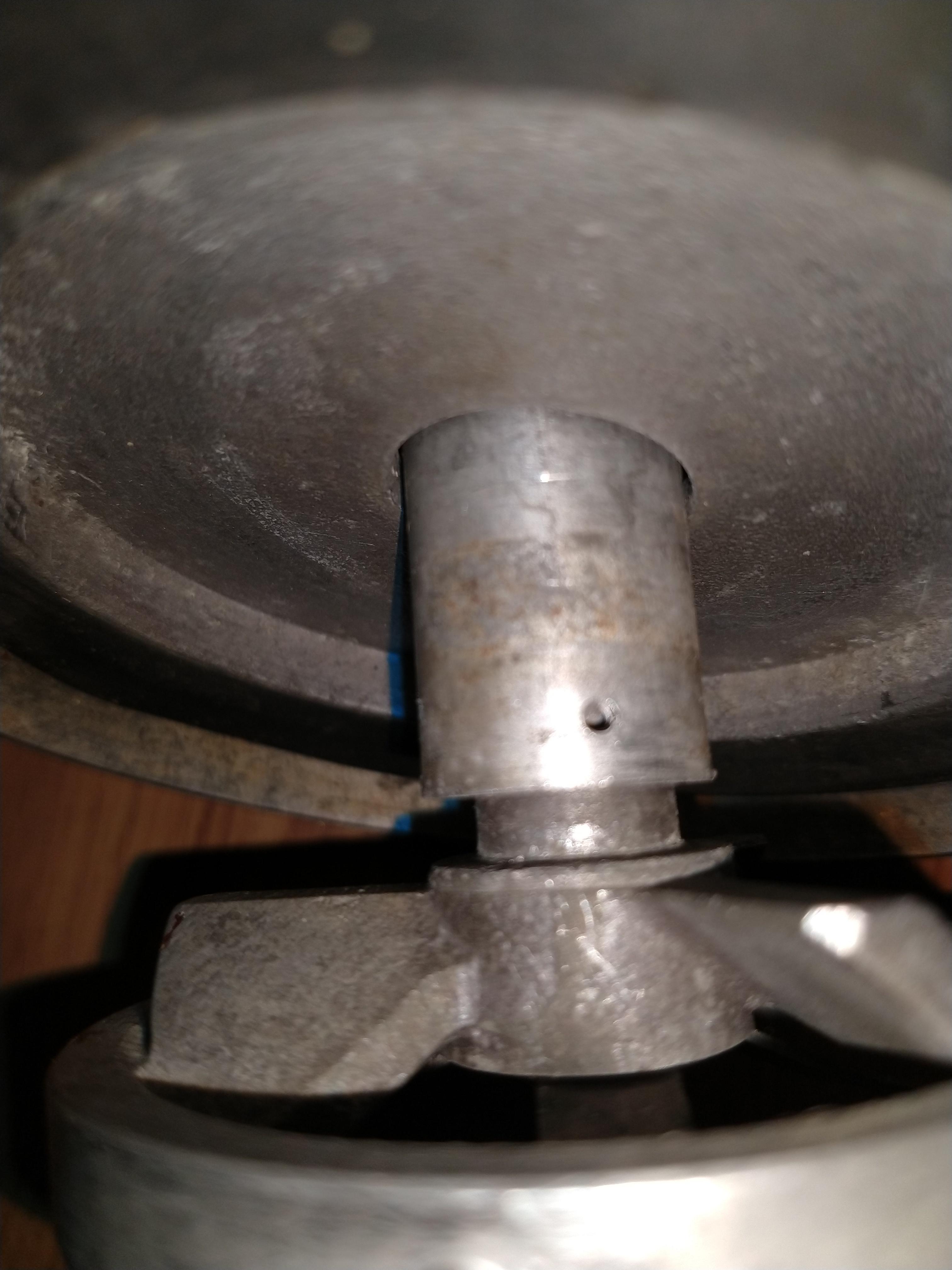

Good Afternoon I hope you are all keeping safe and well during this tough time.Can anyone help or suggest how I can remove the basket shaft on my National Watch Cleaning Machine.I have obtained another larger diameter basket assembly and shaft and I want to install this on my machine.I have removed the grub screw that secures the shaft and tried gently pulling the shaft from the motor but it will not budge.I have soaked the shaft through the grub screw hole with Plus Gas Quick Release fluid and still no movement.So if anyone has any suggestions for this problem I have I would be most grateful for any help.Regards to all and keep safe.Seth.(Photos enclosed)

Hi there Many thanks for your reply I will try this if all else fails but I don't want to damage the motor shaft with too much heat.Regards,Seth.

Hi there, Many thanks for your reply I have had the machine completely stripped down and rewired  and it's running like a dream but as I have said I have obtained a basket assembly with 3 baskets that have various compartments in them but the holder on the machine is too small to fit the new basket assembly.I have obtained a spare shaft assembly that fits the new basket assembly and is the same physical dimensions as the one on the machine so all I want to do is swap them over,but I cannot get the old shaft off the machine.It is a hollow shaft that fits over the motor shaft then there is another larger hollow cover shaft with the cleaning jar lid on.So unless I can get the shaft off the machine I am unable to swap them.Regards,Seth.
OK. Not sure how to help then. If you already took it all apart, just do that again!
It is possible the motor shaft rotated in the hollow shaft, and now it's bound up. Burrs around the threaded set screw hole can gall the shaft as well. You will need to use a puller in that case, or risk damage to the motor shaft.
Is the hollow shaft steel? If so, you could make a heat shield for the motor, and heat the hollow shaft with a propane or MAPP gas torch, then carefully pry between the motor housing and the shaft end. Still dangerous for the motor, unless it slides off easily. Aluminum can also be heated, but it is more difficult to tell when you are "too hot" with aluminum...
Hi there Many thanks for your reply and help,I presume that the basket shaft is some sort of alloy as if you look at the third picture (will enclose it for you) the basket head is all part of the hollow shaft.The motor shaft is steel and the cover shaft with the jar lid/ cover cannot be removed until the basket shaft is taken off the motor shaft.At the moment I have a stripped down movement in the cleaner so I will have a good look at the machine again in the morning as I have plenty of time as I'm retired.Regards,Seth.
Yes, if that set screw dug into the steel motor shaft, and raised a burr, it will be difficult to slide off, as I imagine it is a somewhat snug fit to the shaft, so it doesn't run out when the screw is tightened.
You may consider a new set screw as well, since that one is pretty badly beat up.
It appears to be an aluminum hollow shaft, so be gentle when heating it.
Right now when you try to twist the old basket assembly, the motor shaft rotates and you can't apply any real torque to break up the rust and dirt in the joint.
See if you can remove the motor housing until you can get a grip on the rotor shaft. Then you'll be able to slowly jiggle and twist the basket assembly off. Use plenty of penetrating oil, heat, a small hammer, tempered with common sense.

Good Morning, Many thanks for your reply and help I hope you are keeping safe and well during this tough time,I am just having a cuppa and contemplating what the next move is going to be.I am thinking of using a puller that is used for pulley removal and making up an adaptor to straddle the basket head with a couple of legs that will reach to the motor housing.Then before I use any heat if the puller will grip the basket head and the screw of the puller is tightened up gently onto the adaptor I hope that the shaft will gently move if not then it's back to the drawing board and your suggestions.I purchased this machine and completely rewired it,fitted a new heater plate and it works brilliant but I want to use a 3 tier basket as used on the Elma cleaning machines.Regards and keep safe.Seth.
I've used gear and bearing pullers with great success on stuck impeller blades and bearings. Sometimes it takes several days to get really stubborn stuff off. I would fix on the puller, apply force on the centre screw and leave it. Then come back and spray more penetrating oil and apply more force on the screw. Normally works but requires patience if you don't want to break anything or bend your motor shaftm

Hi there Many thanks for your reply and help,I have taken the top motor shaft cover off to see if I could get to hold the shaft but all there is under the cover is a bearing.I removed the two nuts that appear to hold the bottom motor casing on but even gently tapping the casing it will not split so I am going to make an adaptor for the puller to try and shift the basket shaft.Regards,Seth.

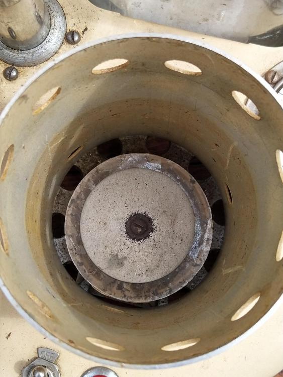

The one thing that is giving me trouble is the under side of the motor. When I got the machine home, I found a load of tar like substance caking the under side of the motor ( the lid for the jars when cleaning with the machine). My question is. If this tar like substance isn't suppose to be there, then what is. I haven't been able to find any images of the underside of the motor/ motor lid. Maybe cork should be used?
If anyone has the same machine, I would be grateful if the could post an image of their motor lid. Below is an image of mine. I have started to chip away at the tar, and softening it up with some acetone, nail varnish remover.

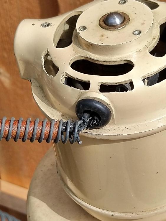

hi there Moose,  i know this is an older thread, but hoping you can help me?
I am restoring the same machine as this, nuv I have hit a snag; the wires for the motor have broken at the grommet entering the motor!  I have managed to get the motor apart to replace the wires, but it looks like they are attached the the magnetic windings and I can't seem to get them out of the case!?
Did you have to replace your motor wires and if so, how did you do it?
Many thanks in anticipation
Jon

It's like an incabloc.  The bushing is meant to be able to pivot and shift, hence the spherical outer shape.  The felt is like a spring to keep it centered and not rattle as much.  The bushing is not supposed to rotate with the motor shaft with the felt acting like it's the bushing.  It would wear too fast and get too hot and have too much friction.
