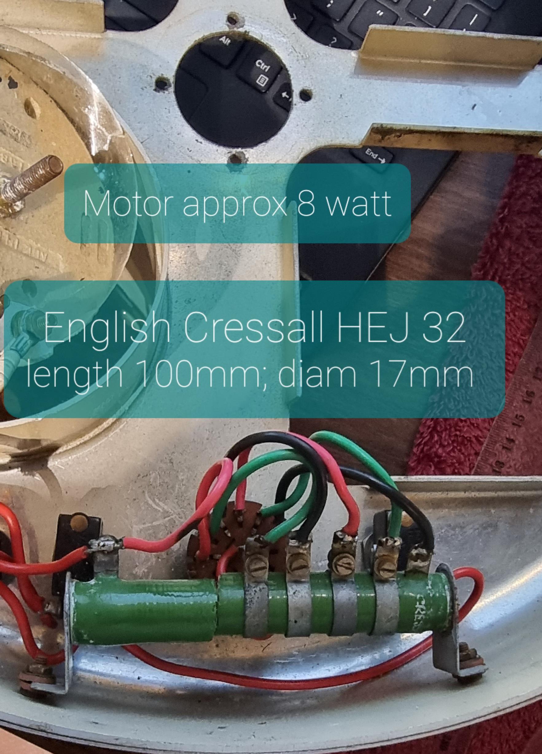

Hi all. I know that this is an older discussion, but to all those that own or have restored one of these machines (the 60's or 70's cream ones), I wondered what type of rheostat/potentiometer was fitted. Mine has a 5 tap variable resistance bar ( broken) but I wanted to change it to a fully variable rheo/pot.  It would be great to have sufficient detail to allow for easy purchase. I think I would need to include resistance (I am guessing 1.5k to 2k Ohm), but what sort of wattage. We are 240V here in Aus. Any details or links would be great.

Hi John
I recently restored a Mark V version of this and was also contemplating on replacing the rheostat. Turns out mine just needed a bit of a clean and worked fine after that.
The previous person who had been inside the machine helpfully wrote 2.5k on the rheostat, I measured it and it was accurate so hopefully that helps.
I'm in NZ so also 240V, I can't comment too much on the wattage, I did measure the amps being drawn at full load while I was doing the restoration but can't remember specifics. I can only say that it was quite low, my multimeter has a 250ma fuse and that didn't blow while running full tilt but did after a few "switch on" "switch off" cycles.
I can't help with your other two questions sorry!
Cheers
Thanks for the response Darthkram. In the pic below you will see what I am trying to replace. It's a long (broken) variable resister with 4 taps giving 5 speed positions. It's a 1.5k ohm Cressell.1765975683_RosenthalPot.thumb.jpg.2b721754f805f28b5a7e1a72695db538.jpg The other pic is the potentiometer from my Elma super elite. It is a 2k ohm pot and has a series of markings on it - P40; WM110. If anyone knows what those markings mean, I'd be very interested as it may help in swapping out for a little less worn alternative
