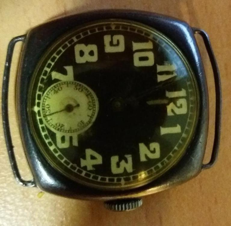

My only experience with watch work is replacing batteries and bracelets but I'd like to learn to service my own watches. I have a few with issues and would appreciate some guidance on which one to start with ie the easiest one to service, the idea being that if I don't stuff it up I'll gain some confidence to move on to the next one.
I have the pictured watches to work on, with the exception of the Seiko they are non goers,  the Seiko loses around 4-5 min a day. The unmarked "relic" with the Unicorn movement was found by me as a 5yr old (I'm now 67) while walking home from school, it was promptly taken from me for safe keeping only surfacing when my father passed away around 5 yrs ago, just as well as I seriously doubt it would still be around if I'd been allowed to keep it. I suspect that what is left of the lume is the old Radium type as I can't get a glimmer out of, I have read that this type of lume eventually ceases to work just leaving the Radium behind to continue giving off radiation for the 1000 or so years. With the exception of the Unicorn I took them all to a local watch maker he advised they were not worth repairing.
Any suggestions on which one to start with would be welcome - at present I only have basic tools, but will be taking a break from my model engineering hobby to make what I can. Lastly I have a now working Ultrasonic cleaner salvaged from a skip located behind a dentist surgery - is this suitable to use as a parts cleaner ?
You'll want to go with the cheapest and at the same time SIMPLEST of movements. I think the 2nd one will have the simplest of movements, don't know what the Cyma has inside.
