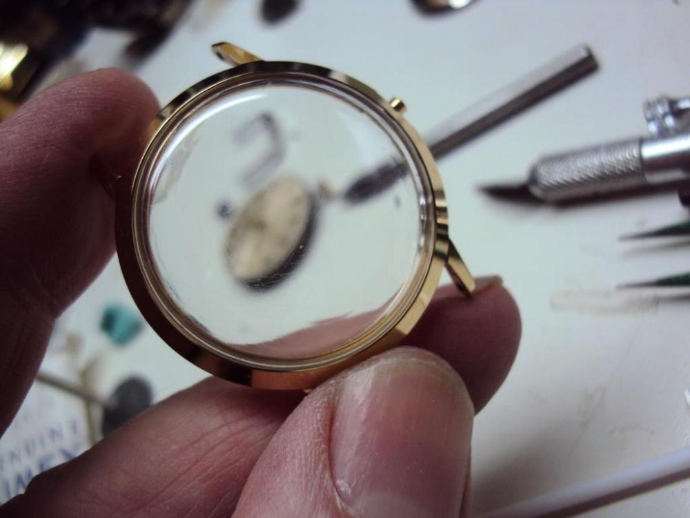

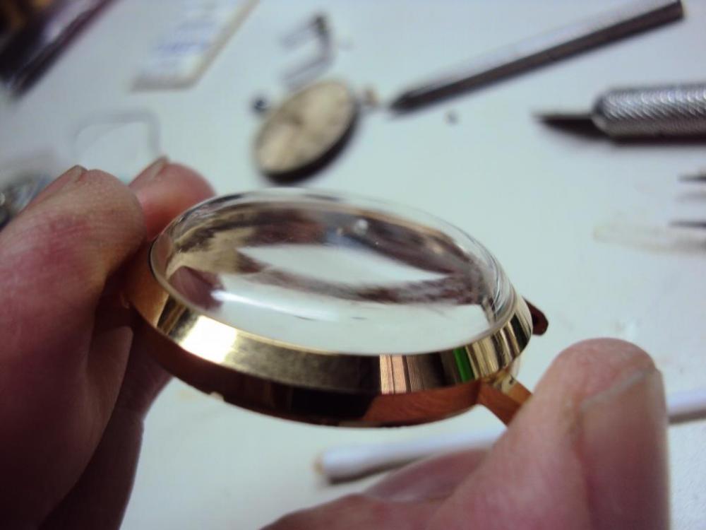

  17. That base actually holds the crystal in place and the metal sides space the compressor up slightly to leave enough plastic at the bottom of the crystal to insert into a case. Am I correct?
    1 point

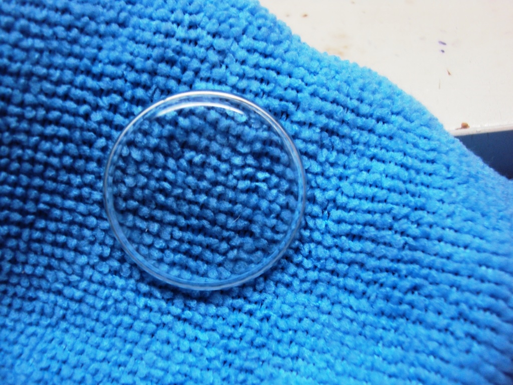

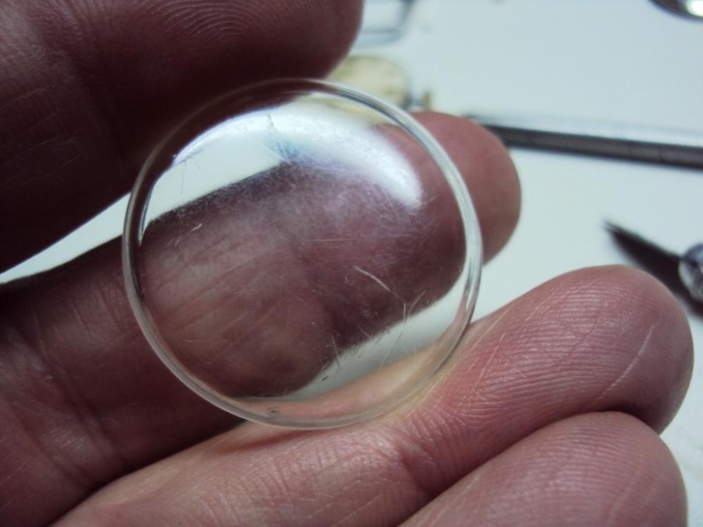

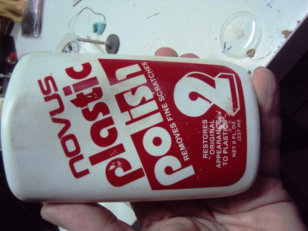

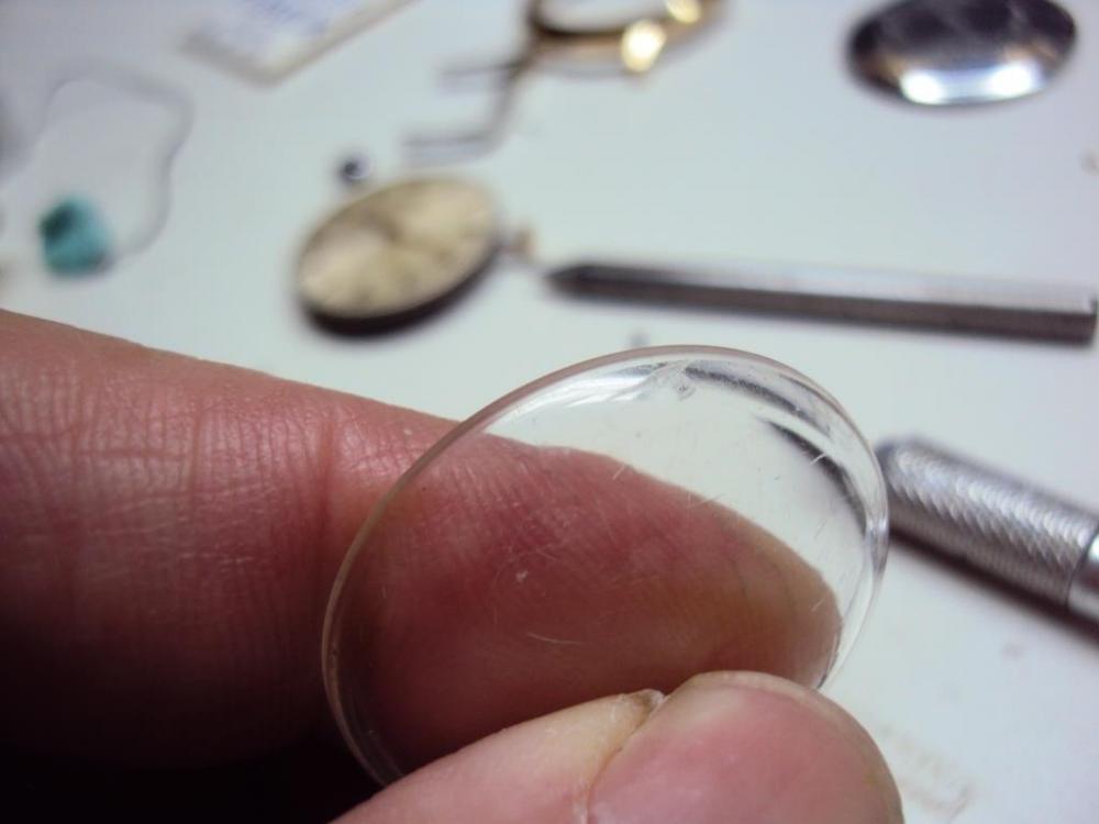

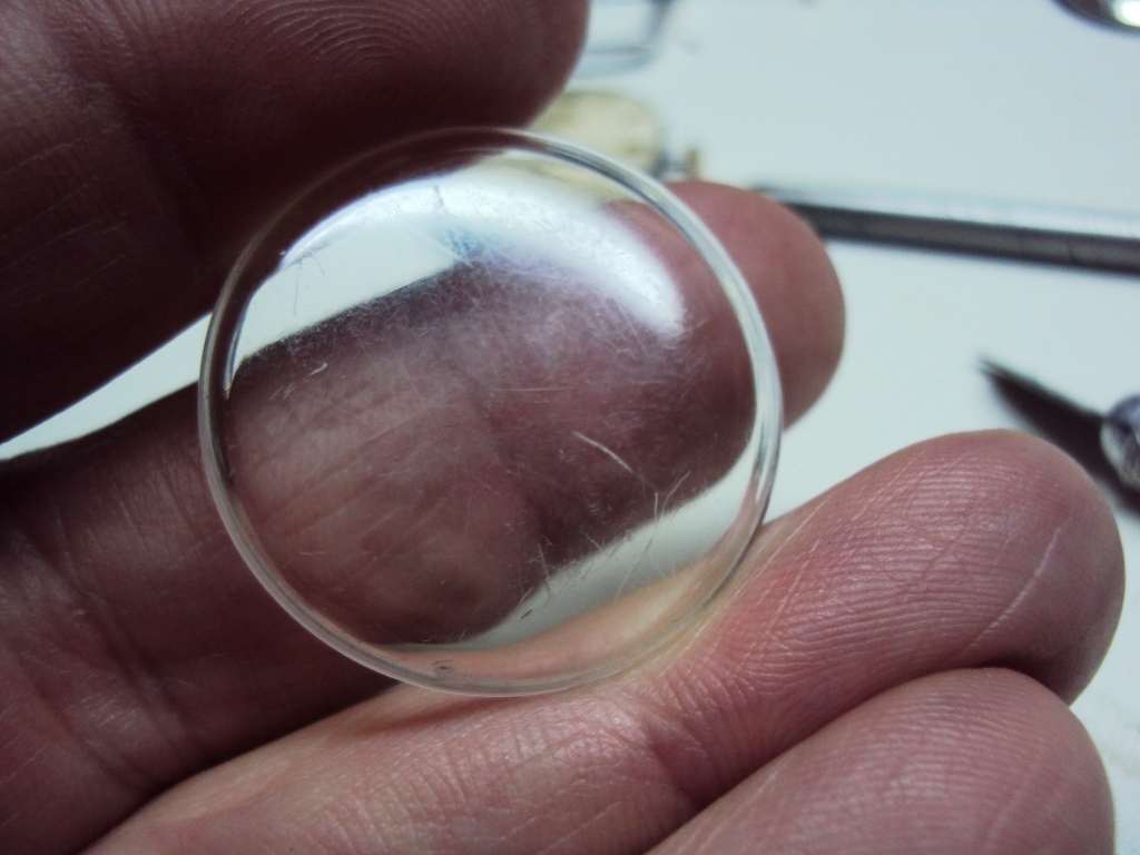

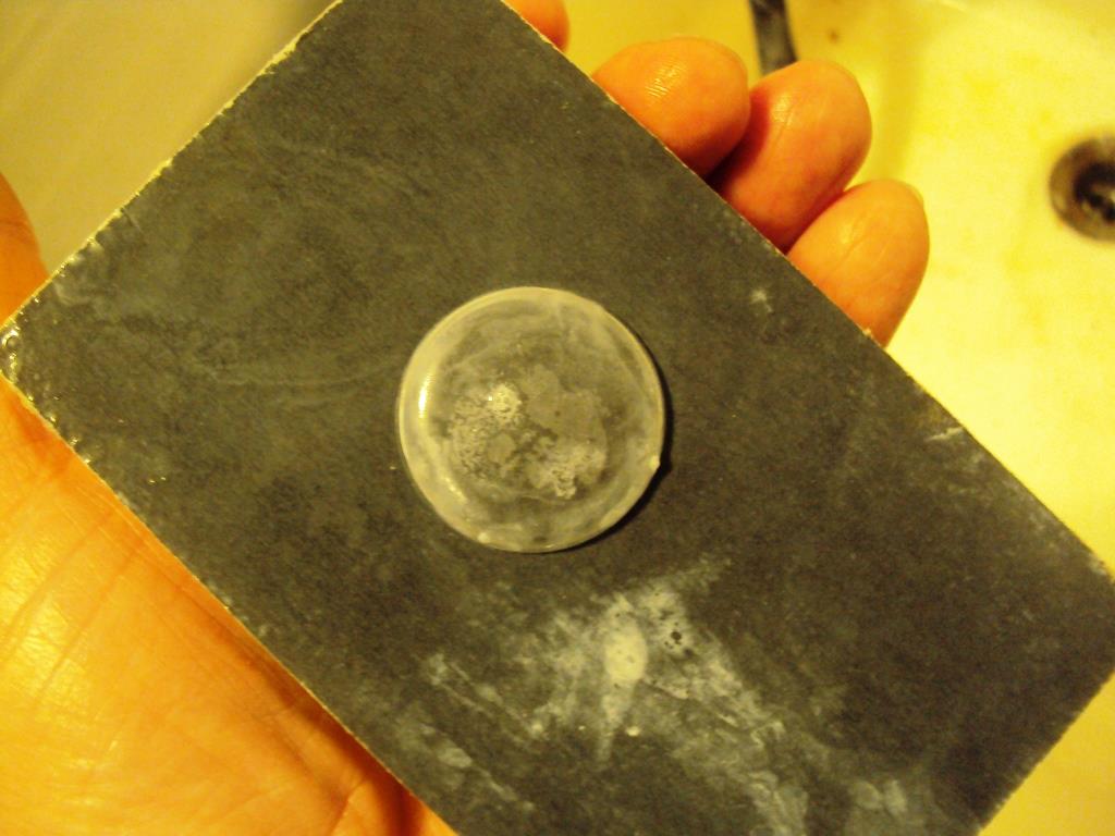

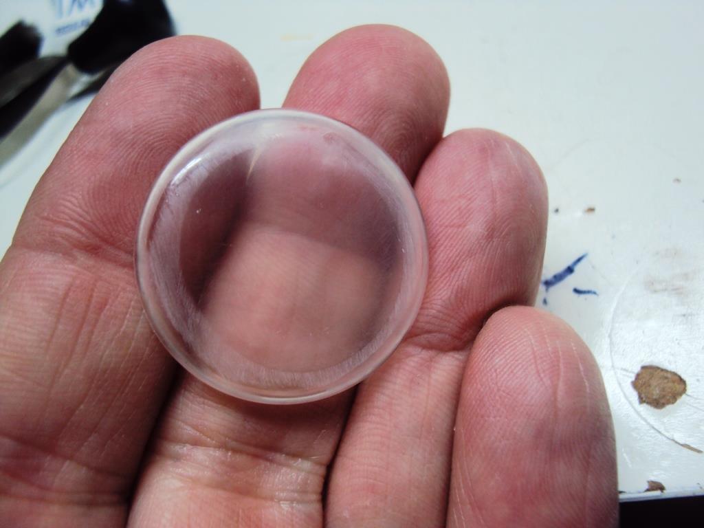

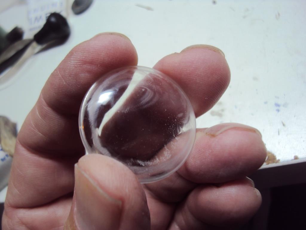

  18. Here is the process in pictures - This one comes from a 1964 Viscount (Auto Timex)
