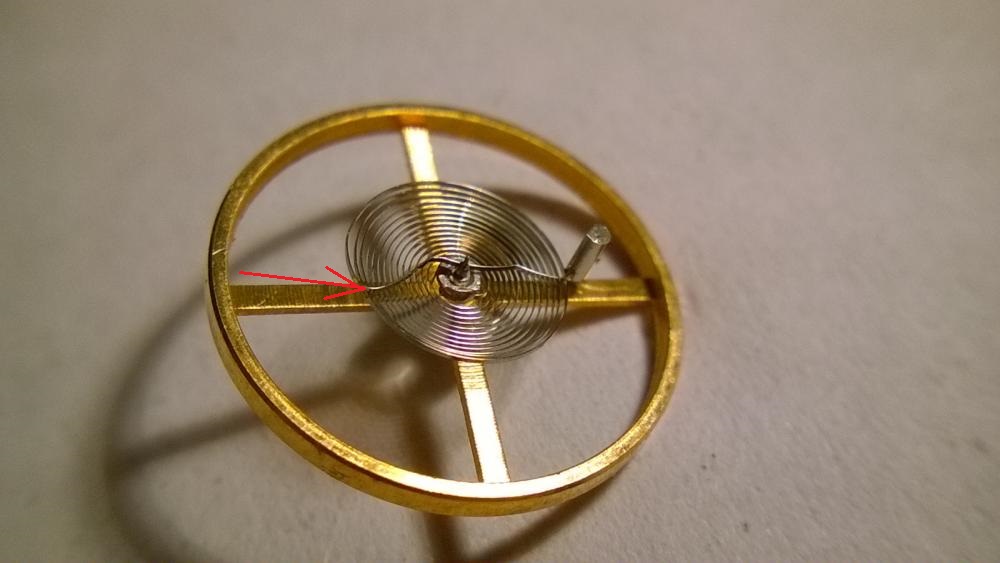

All right then.I baught some watches for practicing and developing my skills.The watch that I opened up is a russian "Raketa" with 2609.i movement and after some examination I have find out that the hairspring looks a litle unusual to other hairsprings.I unmounted the hairspring from the balace cock and voila it is bent.
I don`t know how severe is the bending but the pined pictures will tell.Any advice or tip is appreciated for startig to fix this bending.
Thanks in advance.
This will depend on your skill. Working on h/springs takes a lot of practice. It is very difficult advising when its just a photo and you can’t see the thing at different angles. If it were me. I would start around the red arrow. You first need to get it on the correct side of the B/staff, and then proceed to shape it into the curl of the rest of the H/S. Don’t forget I cannot judge if it is bent high or low once it is the correct side of the staff.
That is badly damaged. Good for practice, but I'm not sure with my skills if I'd ever be able to get a satisfactory result from that. Metals "work harden" when you bend them, so it affects the characteristics of the spring, even if you manage to get the correct profile. It will be easier if you can get another god hairspring of the same type to compare to.
