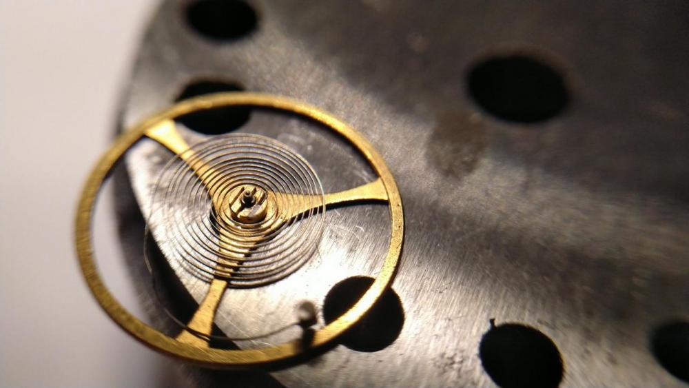

Bent hairspring
  • 4 months later...
Hello,
"Long time no see"
I apologize for my disappearance from the forum, I was busy at work.I am back and managed to disassemble and clean a Wostok 2409A which worked out really well. The main problem of this movement was the hairspring itself because it was distorted really badly. Before starting to sort out the bendings I demagnetized the hairspring and cleandit it with cleaning solution. After cleaning it recovered most of the bendings, and the endcurve is what remains to be fixed.The attached photos will show whats is all about.Probably it will not be as good when it was new but I will try.
