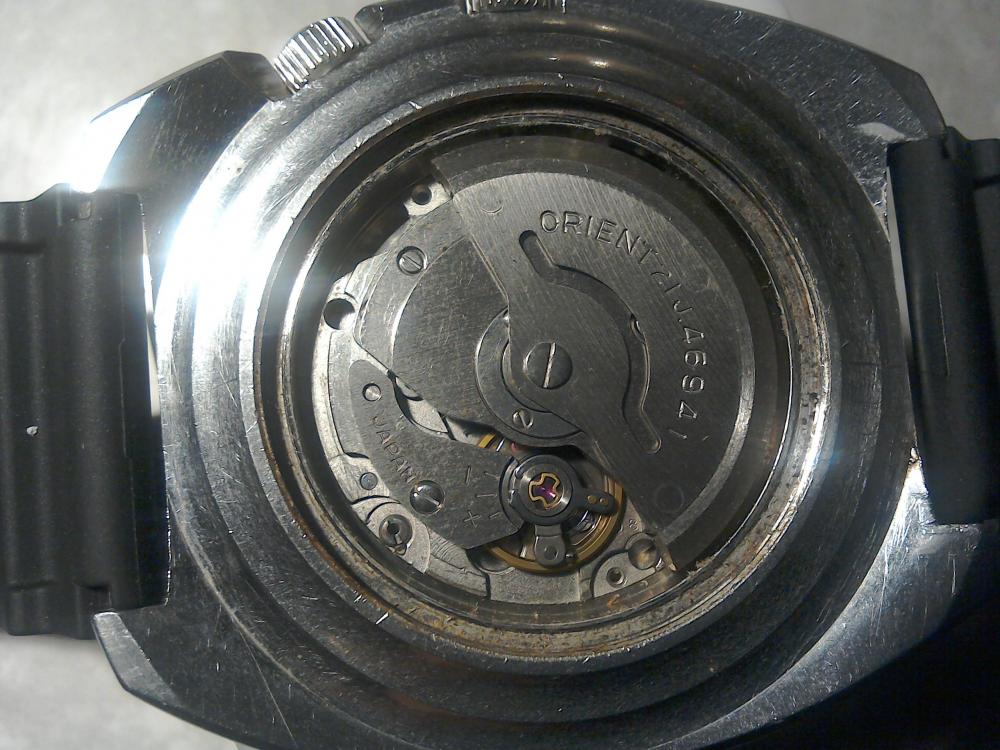

Hi Johnnie ,  are you going to do the crystal change yourself ?  If so do you have the tools and skills for this procedure which may include measuring the old crystal and case among other things to purchase the correct size you will need to order and install your new crystal .
I would look at a few good youtube tutorials to help . Good Luck .
Hi Recardo, I am planning to do it myself, that's an excellent idea about YouTube! Have no idea where to get a new crystal from as yet though. eBay perhaps? Thank you for the YouTube idea. :)
4 hours ago, Johnnie said:
Today's offering is my Orient watch, runs perfectly,,,, but needs a new crystal as this one is cracked and burnt ! Done before my ownership. Any suggestions where I can got one would be appreciated.
Hi again Johnnie , ...Do Look at the youtube videos first....
I can't tell if your watch has a removable bezel as that would be a small clue . Some crystals are held in by the bezel . Some are pressed into a rubber or nylon crystal gasket . Some are held in by a tension ring [armored crystal ] , that is either silver or gold colored ,...Etc .
Having said that and trying not to confuse things , you don't have to get a crystal that is a branded original . The tension ring type is an example . Measure your old crystal and case seat with a micrometer and order the size and ring color you need .
  In the United States I use Esslinger.com , or Jules Borel . In Europe , Cousins is the go to place but there are many more resources so you have to do good searches .
A new crystal isn't something that you would likely need to purchase from Orient. Remove the old crystal and measure it. On your side of the pond, Cousins UK will undoubtedly carry exactly what you need and likely at a substantial discount over the same item from the manufacturer.
Hi again Recardo& TexasDon, looking at the watch it doesn't look like the bezel comes off so I think the movement needs to be removed before the crystal can be removed. The crystal seems to have been burnt as well as cracked, also the dial itself seems craved and crinkled. The colour is there but looking at it there seems to be a clear coat that's lifting, possibly through heat. It works well and is keeping time very well so that's good. With a change of crystal and possibly a replacement dial it would be a nice old watch and I would like to save it. I will try and post better photos if I can. Many thanks for your help.
These Orients came in two sises, give OD. Genuine Orient crystals are rare, mass produced generic ones are slightly of inferior quality and do get passed on as genuine on ebay. You would know the difference if you examine two new ones side by side.

Hi NuceJoe, 44mm X 42 X 14.5 crystal measures 38.5

The crystal on your watch dose not magnify day/ date. Shouldn,t it?     I am not sure from the picture of your watch, if it has a tension ring. I bought and installed one, the envelope says 390 but measure 38.5 mm, fitted perfectly, got magnifiers and tension ring.
No mention of all dimensions you gave, just says Orient 390-123 made by sternokruetz of Germany. The best I could find.
Not to worry about the price.
Hi and thank you, no magnifier on my watch but not sure if it should have. Will Google it and see if it may have had one on leaving the Orient factory. Will look for the crystal you bought at Cousins. Thanks very much for your time and trouble.
