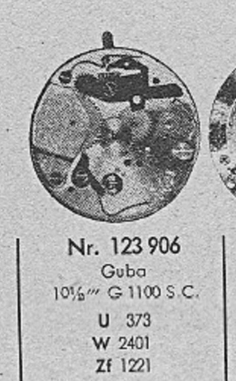

A little oddity today, this 33mm Vidar from the 1950s. Just for a bit of fun, I've refrained from naming the calibre in case any movement buffs would care to have a guess what it is. I certainly needed help with it from an expert. As a clue, it is not Roamer -associated.

3 hours ago, AndyHull said:
Russian?
Don't  think so. Shock  protection  looks wrong for one thing.not Swiss..German most likely.not enough Swiss cross pollination  to be French
1 hour ago, balaton said:
Nope. Sorry, Andy, not Russian.
I also thought it might be a UMF, but I can't see anything that matches from them either. The shock protector looks very familiar.
Regards.
To me that has a somewhat Kienzle look about it. Everybody always seems to think that Kienzle only made pin levers with low jewel counts but I have come acros a number of fully jewelled examples.
The reason I thought it might be Russian is because the shock protection looks similar to this little Sekonda ladies movement that I serviced a while back.
Kienzle is also a good guess. They did some fairly sophisticated stuff as well as the pin levers. I have a Kienzle automatic movement sitting in the todo pile at the moment (with a pretty spectacular hairspring salad as I recall).
Sorry Andy and Marc. It's neither a UMF nor a Kienzle pallet lever job. The anti-shock does have an echo of the Russian SU system, but I've never been able to positively ID it.
You should (hopefully) be able to expand the images for better detail.

13 minutes ago, balaton said:
.....and from where, dear Marc, did you get that from, pray tell?
B.
Much as I would love to be able to say that I managed to rake it out of the extensive archives stored away in my own memory banks......  I have to confess I kind of cheated :unsure:
I took your advice and expanded the image for a better look. Sadly the image itself offered no further obvious clues, but I did notice the image file name was "VidarGuba1100SC", so I googled images for Guba 1100SC and found a match. I'd have gotten no further than my original Kienzle guess otherwise as it does seem to be a rather obscure maker, not one that I have encountered myself.
Incidentally my original thoughts regarding Kienzle were down to the use of a single large bridge for the barrel and going train instead of two separate bridges, and the slotted barrel arbor, both features that I have seen on the fully jewelled Kienzles that I have worked on in the past. I wonder if there was any collaboration between the two makers.

Ha!  -  I wondered if my images named the subject matter which, of course, now precludes me from offering up any more of my little mysteries! Anyway, well done that man.
I'm a member of another watch site forum and had sought help with ID-ing the Guba (Gustav Bauer, as I'm sure you know). A fellow-member who also maintains an archive of movements not represented in Ranfft, Lorenz or Watch-Wiki found the attached image in a 1957 Flume but it was so rare that not even he'd ever seen one before. I was more that happy for him to include my movement and dial side images in his database.
I get what you mean about the Kienzle's configuration. Here's an image of my 17j 058b25 pallet lever job by way of comparison.
