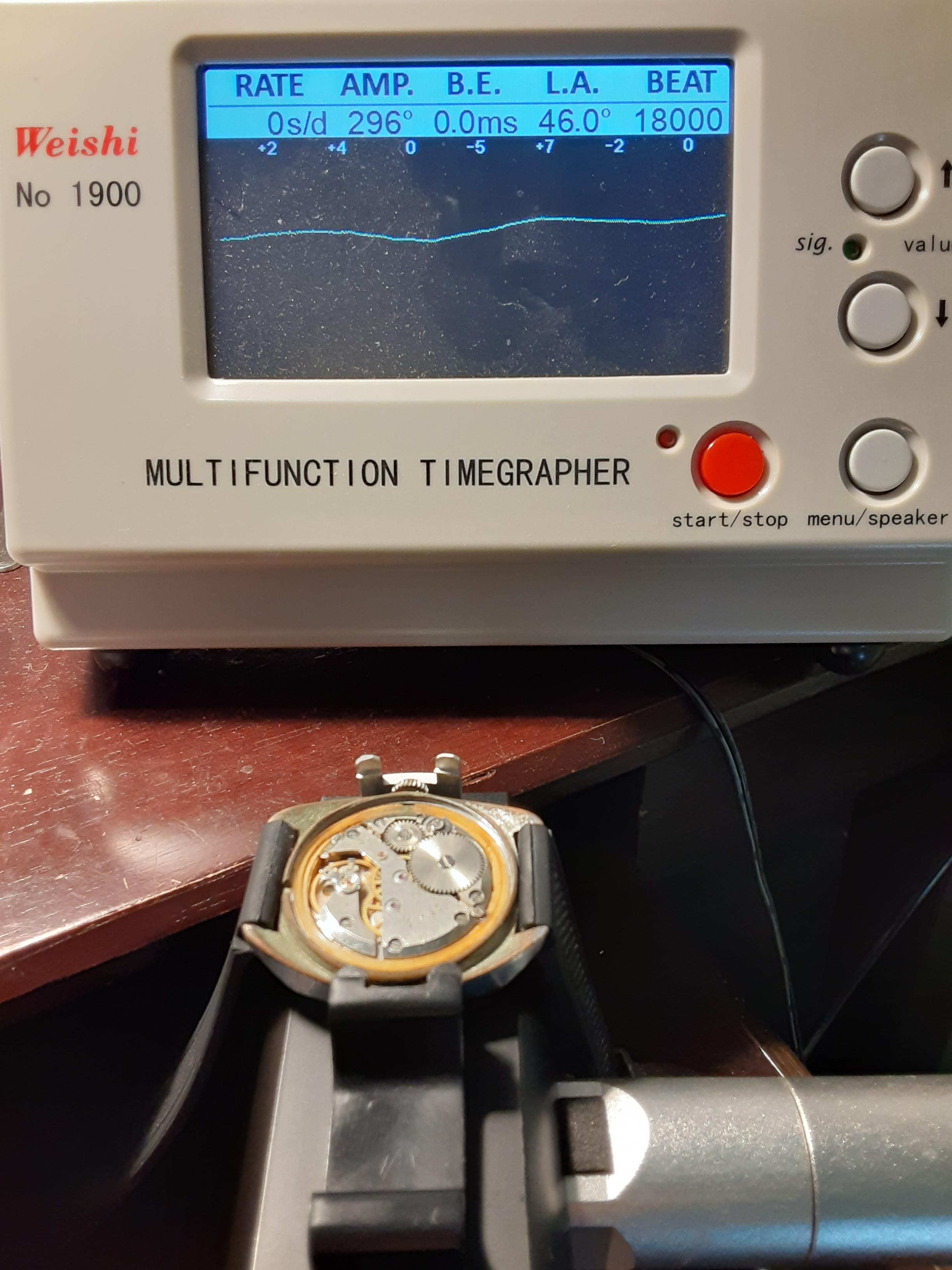

Just to prove yours isn't a fluke, here is my "almost COSC" 1970s Sekonda TV face, which I have literally just taken off my wrist, having worn it all day everyday for the last month, wound and slapped on the time grapher.
.. also giving a not too shabby performance.
