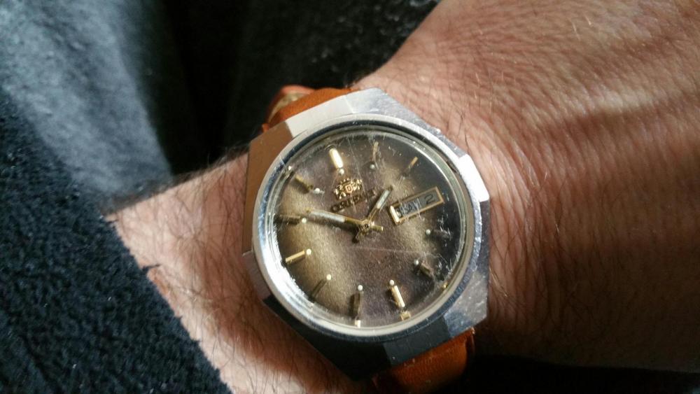

It is a "Two for one" day today, and speaking of unaligned dates, I finally got round to sorting the sticky day disk on this bright yellow HMT Rajat, so it is getting a bit of an airing along side the "Dimetron".
This picture gives a slightly better impression of the shimmering blue sunburst  dial of the Dimetron and the almost fluorescent yellow of the HMT. Its all so bright I think I need to wear shades.B)
5 hours ago, yankeedog said:
you should be able to do standard round crystal,no?
Yes, a standard round crystal will fit but it I'll be keeping this one for now as it fits with the design of the case lines.
I'm not a huge fan of the faceted crystals typically but this one fits the case design. A replacement nos one would be nice but I'll tty polishing this one of not when I can get some buffing wheels and compound to try it.
