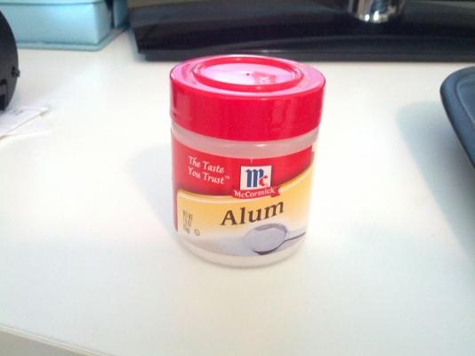

Well, it does Work! (thanks Rob for the tip!) After less than 3 days the stem is totally dissolved! There was a bit of black grit in the tube, but after a quick ultrasonic bath, the crown has no signs of the broken stem inside!
The only noticeable affect on the crown is a slight darkening/staining of the surface. I'm not sure if this is a result of poor quality stainless steel(cheap Chinese reproduction) or if this will happen to any stainless steel. I d0 think I can clean the surface back to, or close to the original satin finish.
One of my other concerns was that this crown has a spring inside to allow for a water-tight seal when the crown is seated home by use of the crown guard lever(remember it is a Panerai replica). As I cannot inspect the spring to check for damage, There does not appear to be any change to the spring strength itself.
The process I used was to dissolve about a tablespoon amount of Alum in a small amount of water ( I will not attempt to explain the amounts further in metric or US measurements as I'm sure I will confuse everyone reading! :huh: ) and kept it heated by sitting it on a radiator/heater for the duration. I had to add water once as it will evaporate quickly under these conditions....

Is this the stuff? Alum (aluminium potassium sulphate) 250g
I am thinking of giving this a crack myself.
I wondered the same thing...I warmed up the water in a microwave, but that was the extent of that!
As far as the Alum itself, here in the US, she found it in the supermarket. It's used in canning vegitables and pickles! Makes them stay firm and crisp! I believe she only paid a couple of dollars for a a couple of ounces (60g)...
