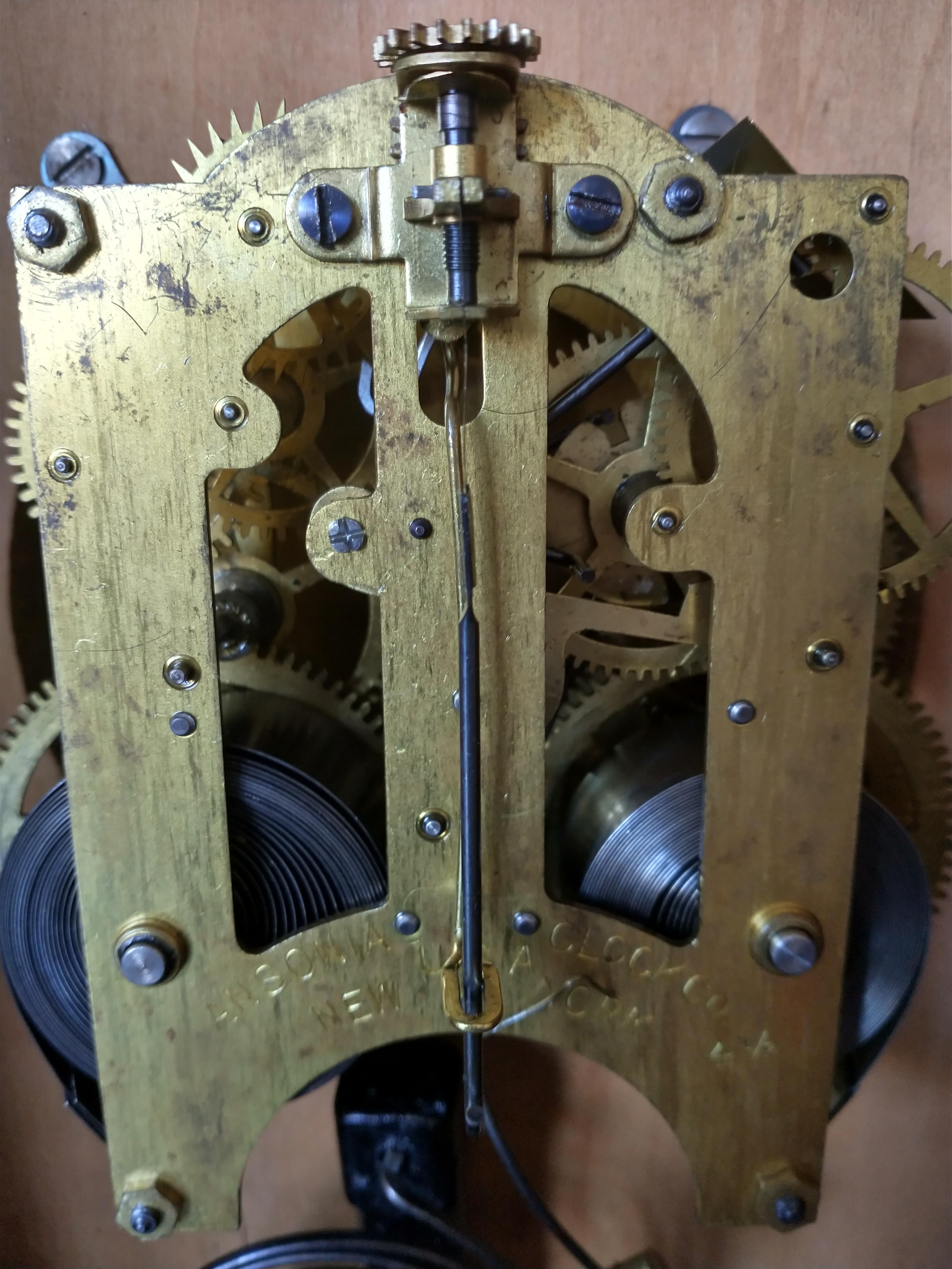

Hi    One ansonia, one William L Gilbert connectcut  reg 1903     not had any of his to work on,  Done plenty of Ansonias though.  You might find the attached handy for the Ansonia.   Lookforward to seeing the french clocks usually good quality.

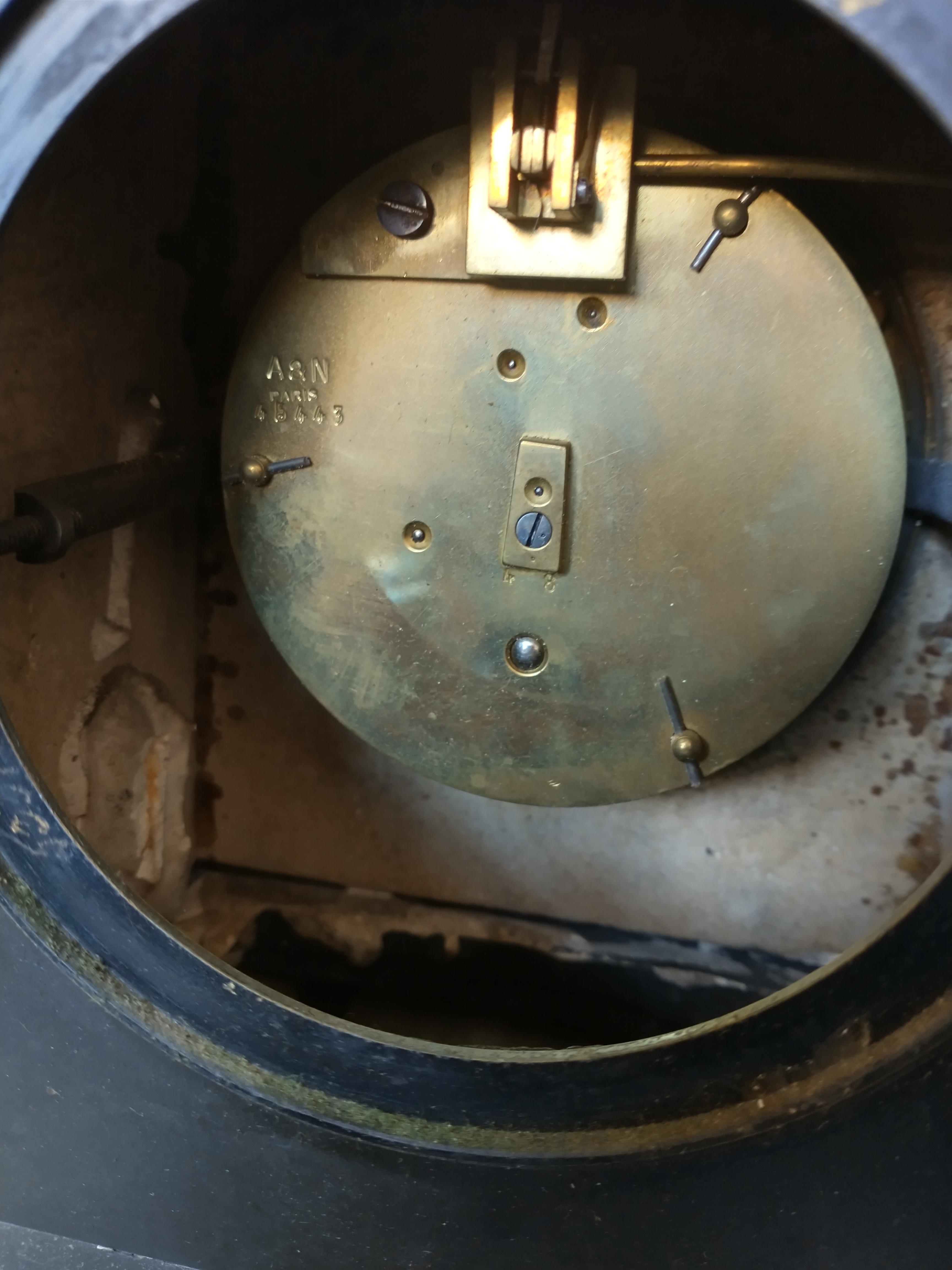

A & N Paris from what I have found out it looks like A & N bought movements from Paris and assembled them in London. The number is just a movement number.
The second French timepiece looks like 1882 in the round stamp. As you look at the back plate the 3 numbers on the left is the movement number and the original pendulum would have the same numbers stamped on the pendulum bob. The 3 numbers on the right are the length the pendulum should be, it is in french inches.
The Ansonia is just a typical common strike movement.
William L Gilbert clock is the interesting one out of the American clocks. It has full plates which you don't find in most American movements. It is in the style of English and German strikes, the springs are in barrels which with the American clocks they tend to be the open type.
The A & P is the one thats got the same number on pendulum as the movement, unfortunately the other one didn't have the pendulum with it so i need to have a look for one. Yes i was surprised to see the barrels in the Gilbert clock, didn't no that about the full plates though.
