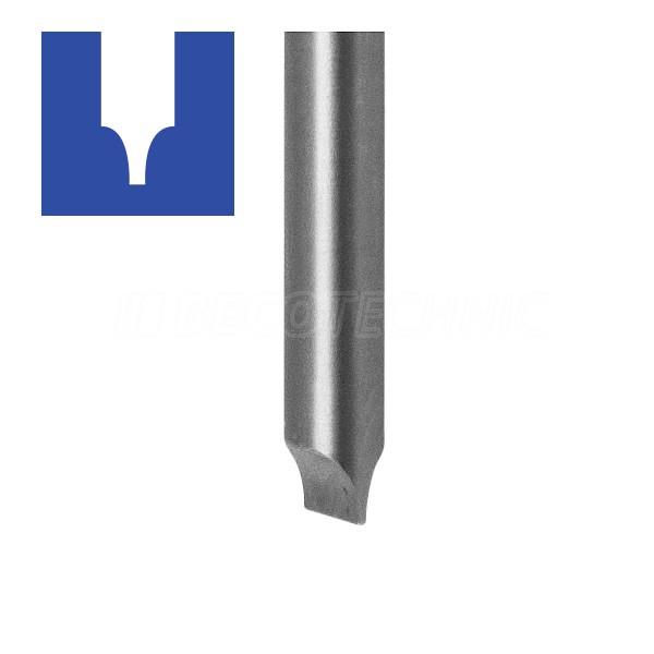

In school we uses this one, also to make hollow blades on a screw driver.
https://www.beco-technic.com/werkzeuge-verbrauchsartikel/schraubendreher/zubehoer-fuer-schraubendreher/schleifwerkzeug-fuer-schraubendreherklingen/schleifwerkzeug-profi-fuer-schraubendreherklingen.html
But is very expansive.
This one is cheaper, but don't know if you can use it on al screwdrivers from the Bergeon set, because it only have 3 holders.
https://www.cousinsuk.com/product/screwdriver-sharpener-tool-horotec

On 10/3/2018 at 2:57 PM, Tmuir said:
Hollow ground screwdrivers are really only of use if you work on the same model of watch all the time.
The reason is if your flat ground screwdriver is too thin you just stone a tiny bit off the end to make it fatter.
On a hollow ground screwdriver you need to remove a lot more material to make it fatter, and then hollow grind it again to suit the screw you want to undo, so its harder to swap between brands of watches that you need to adjust your screwdrivers for.
If you worked as an 'in house' watch repairer of an expensive brand of watches, and always did the same movements then hollow ground is the best, but for most of us that works on what ever watch comes our way the flat ground is best being a compromise between time taken to reshape screwedrivers and the risk to 'chewing' screws.
I agree. From what I know, The British Horological Institute and watchmaker schools in the Netherlands teach to work on watches with flat ground screwdrivers.
Hollow ground is useful for screws made of a softer metal such as gold and convex screws that you sometimes see in older watches and also sometimes used as case screws.
The first thing we do in the watch corse is make all students screwdrivers hollow... ;-)
Edited by Koen
Well because with hollow screwdrivers, you have more grip the teacher say ( Omega service center ) and les chance to slip away or to damage screws...
You don't want to damage movements, especially now with open case backs. But thats what we learn the first lesson, I am only the pianist. ;-)
See above the good postings by Tmuir and measuretwice. Parallel blades drivers aren't given that much importance, for whatever the right and wrong reasons. Good that you are being exposed to comparison at school so you can base your own judgment, I want to do the same.

What is a hollow screwdriver?

Again, what is a hollow blade
31 minutes ago, Nutiborskoku said:
I also find it odd to immediately have everyone's screwdrivers hollowed.
Quite normal in watchmaking schools, one have to do a lot of filing and tool making before undertaking actual horology subjects.
Good for building dexterity and machinist skills but really there is whole lot more than that to make, at least, a good repairer.
