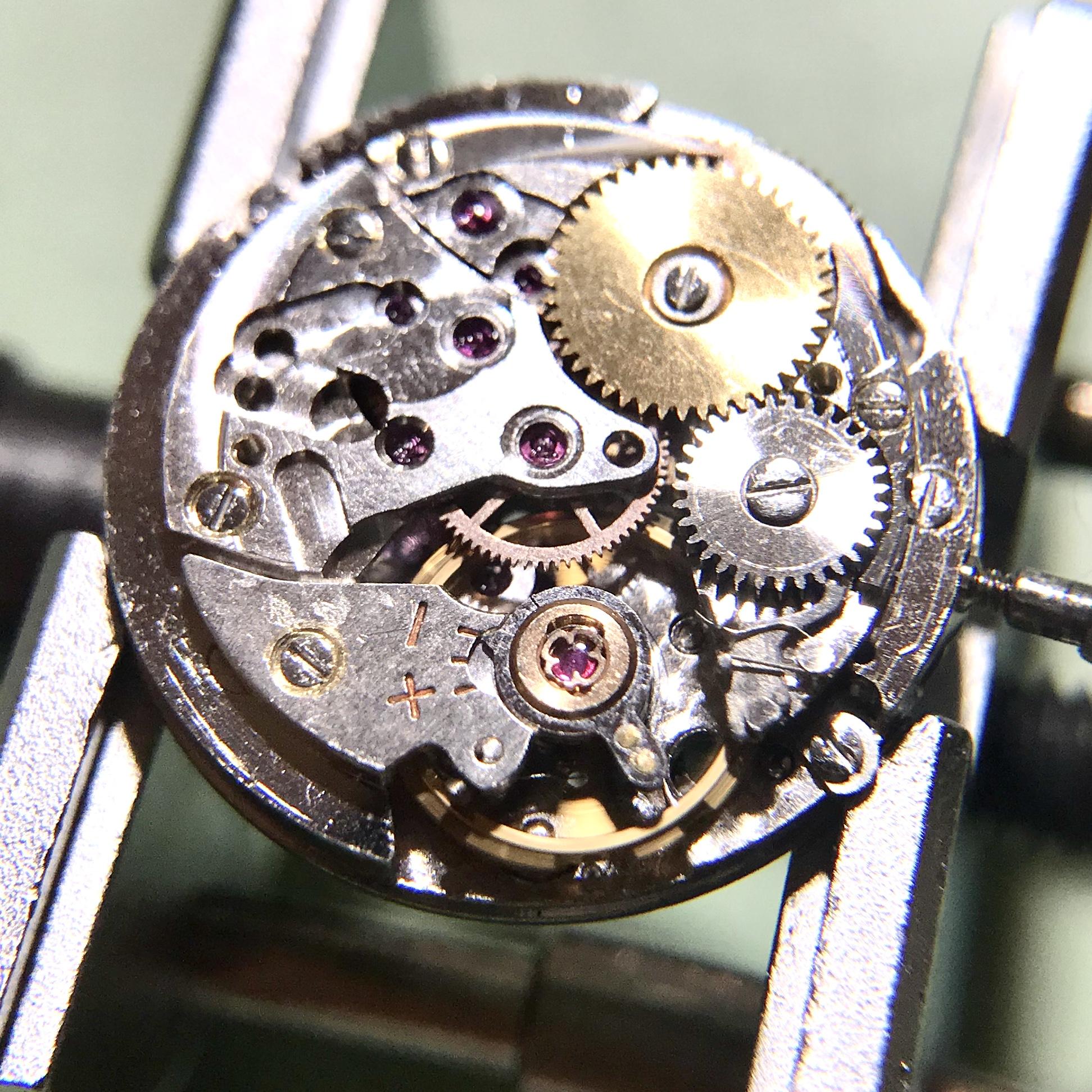

Hello,

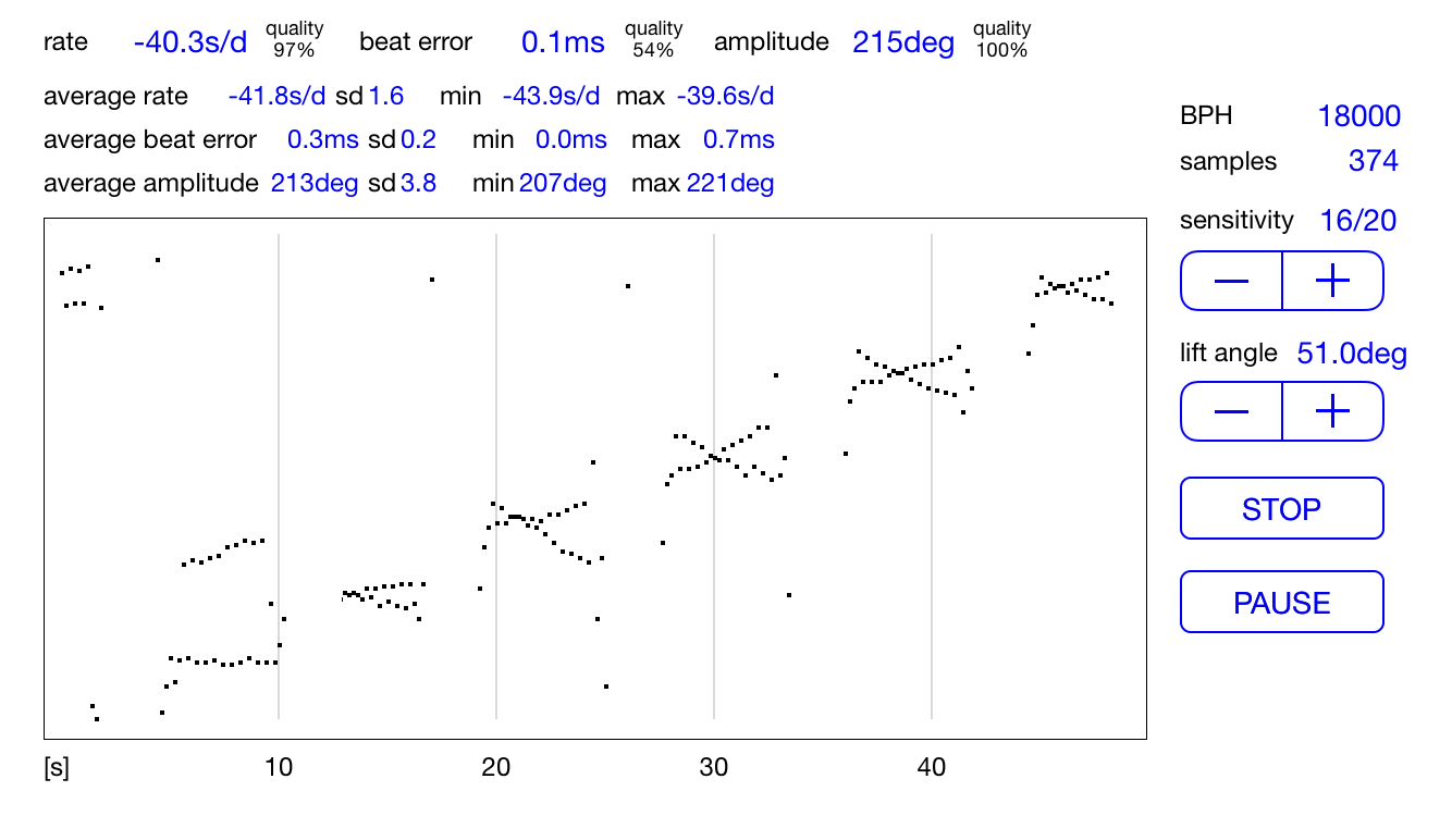

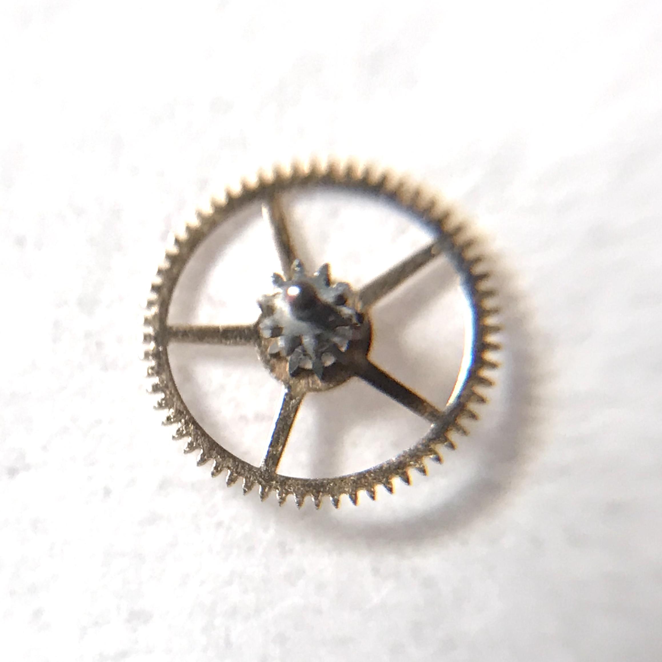

I’m currently attempting to clean up a 1964 Tudor Princess Oysterdate 7981 with a Tudor 2447 movement. I purchased it knowing I had to replace the stem and assuming a cleaning was in order.
Well, it cleaned up nicely. On my inspection, I did not notice broken jewels, worn wheels, or otherwise. I did, however, notice the bottom cap jewel for the balance was worn and the Hairspring slightly misshapen (touching coils). I replaced both. There is very little information on this movement online. As I have been able to research, it appears this is a modified ETA 2369 with 18,000bph and lift angle of 51.
Annoyingly, the beat error is regulated by turning the Hairspring collar - very tedious but I got it to an average of 0.3ms.
on the timegrapher I am getting a very strange reading - a pattern of “X’s” every 8 seconds. It indicates the watch is losing 40 seconds a day but the reality is it’s gaining time (2-4 min per day).
I replaced the escape wheel thinking something could be wrong there but the readings did not change.
Can anyone advise on what I should be looking for? I’m a bit at a lose.
Happy to post pictures of any part, please just let me know.
Thanks in advance!
Edited by mzinski

Yes, it is an iPhone app called Timegrapher. While it’s not a dedicated timegrapher, I have been able to use it to successfully and consistently regulate a wide variety of movements (7750, 2784, 2824, 2836, 7420, 1120, 3135, 1215, etc). Of all the movements timed on this app, this is the only one to produce such a strange result.
Since it's regularly happening every 8 seconds I'm thinking a gearing problem; the 4th wheel has 8 teeth in its pinion, which will equate to 7.5 seconds per tooth "in action"- but it would be odd that all the teeth on that pinion or the 3rd wheel that drives it would be damaged and damaged equally. Though if for example the train bridge was removed with power on the watch the 3rd wheel teeth may have zipped accross another component raising burrs or something.
Is the train nice and free with the balance and fork out?

I'm going to take a wild guess that this is a hairspring issue.
The coil may be touching/sticking every few seconds, this in turn may cause a sudden shift in amplitude, which then flattens back out, then as the amplitude recovers, the problem repeats.  What makes me think this is a likely candidate is that I can't see any gear that has the exact number of teeth/period required to cause such an stable effect. Rebanking would suggest a much higher amplitude than the one you are seeing, hence my thoughts that it is probably the oscillator, and in particular, the hairspring.
Clean, demagnetize and carefully inspect the hairspring for flatness and concentricity.
EDIT: Also check the end shake.
Video the balance in operation, and play back slowly (1/16th of normal speed or less) and you may be able to spot  if I am correct.

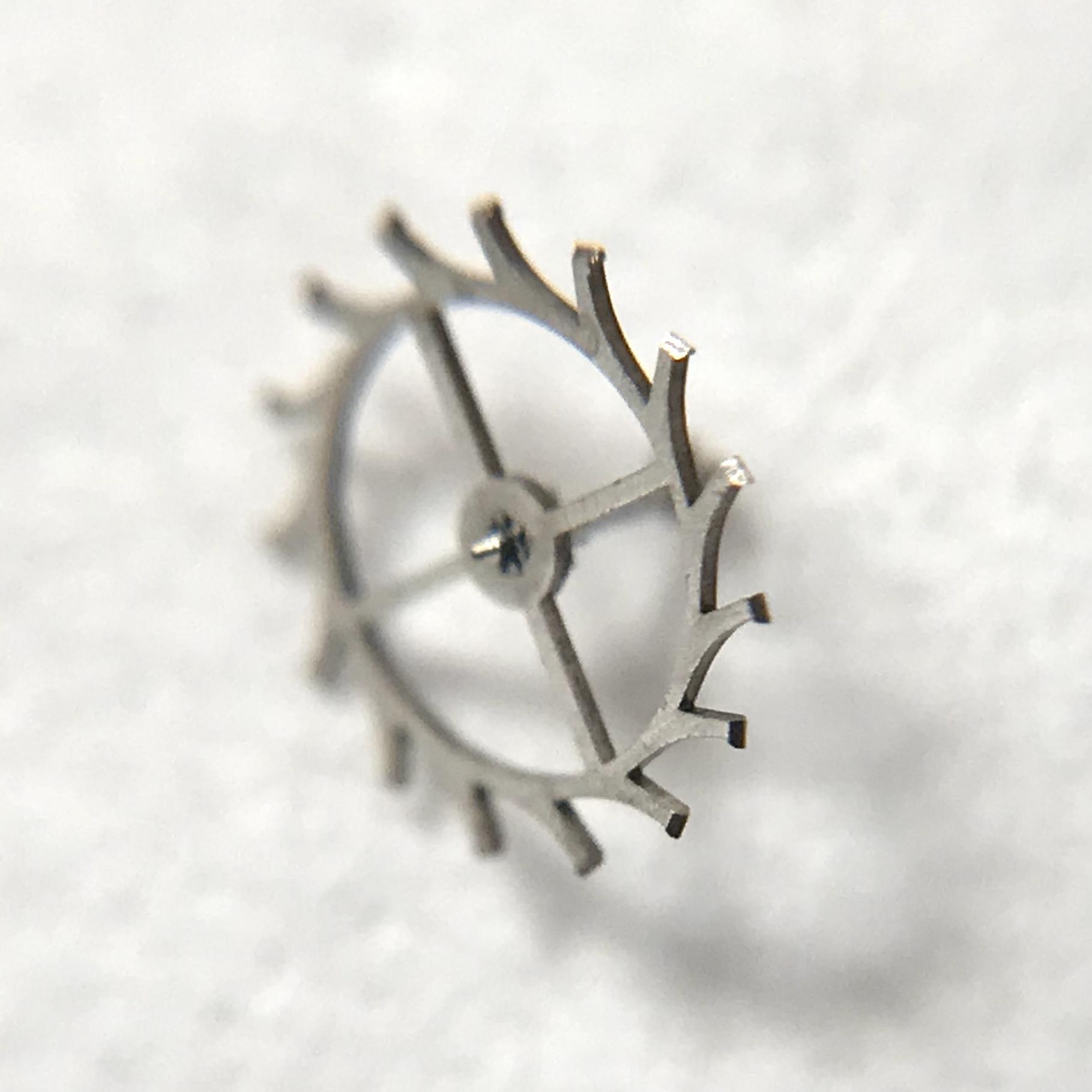

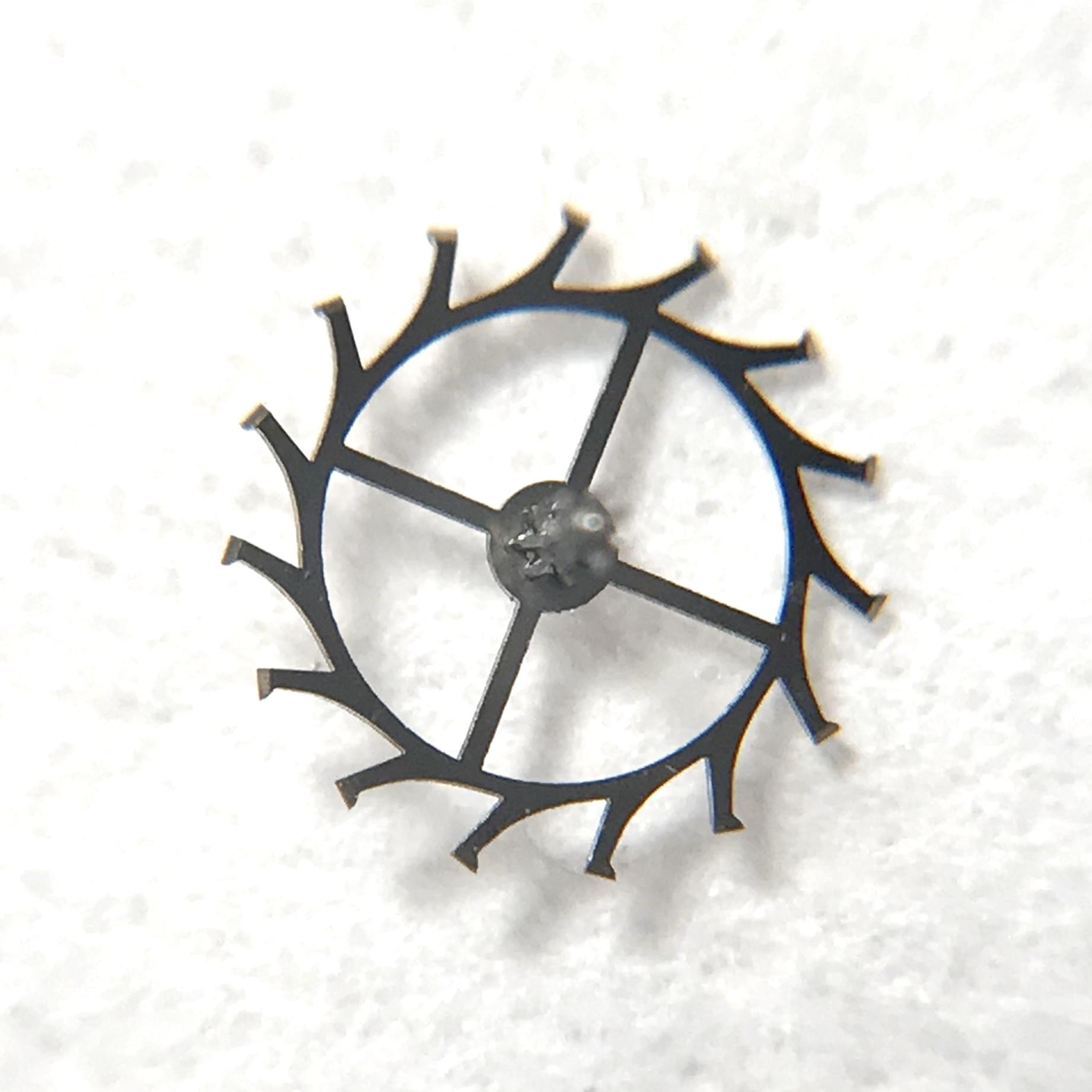

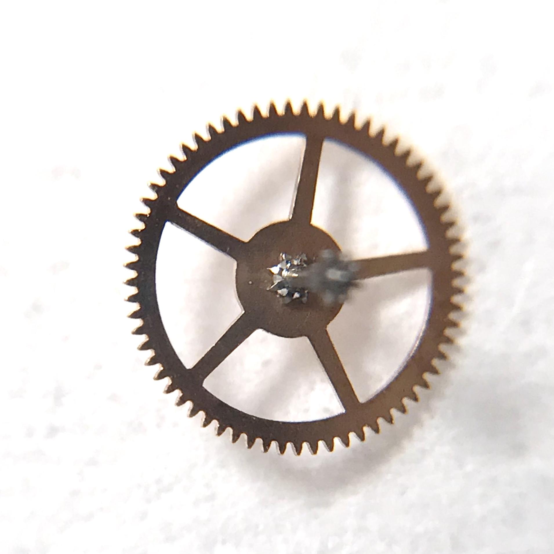

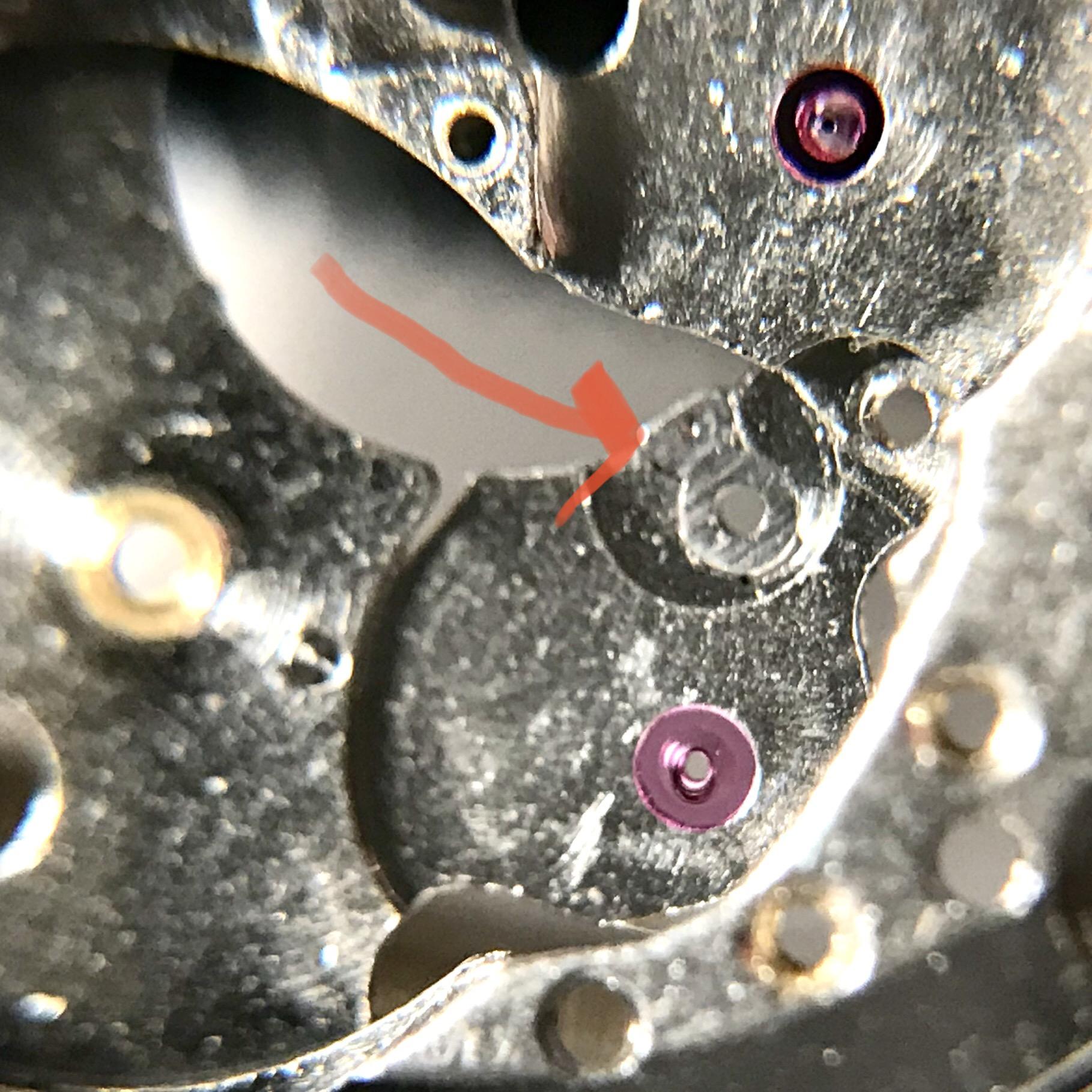

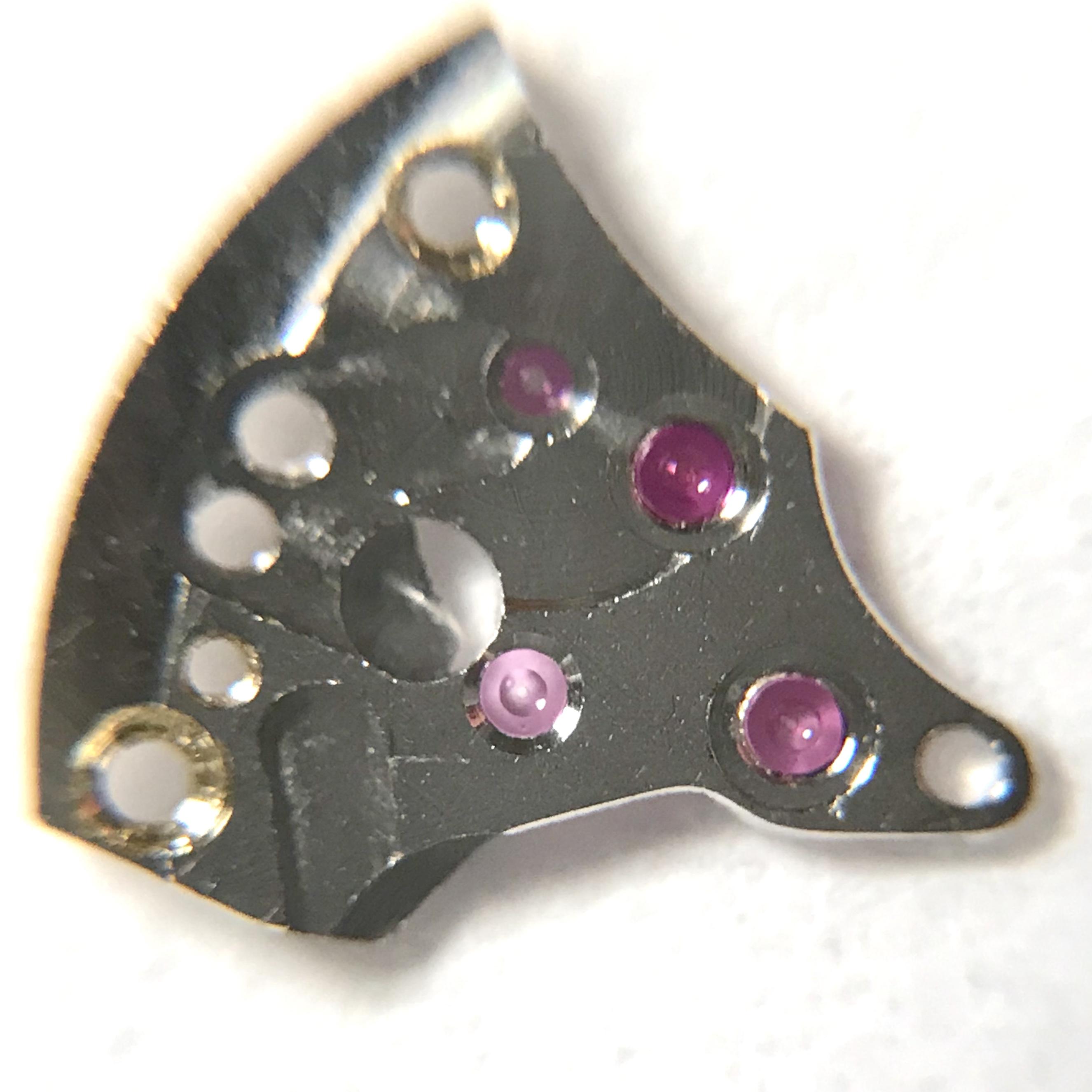

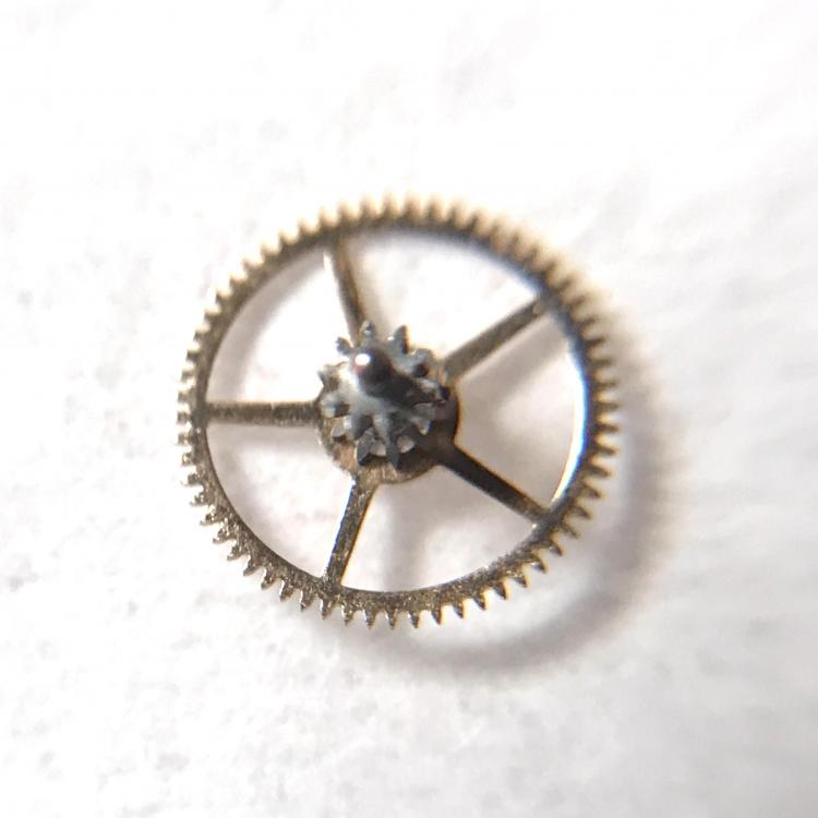

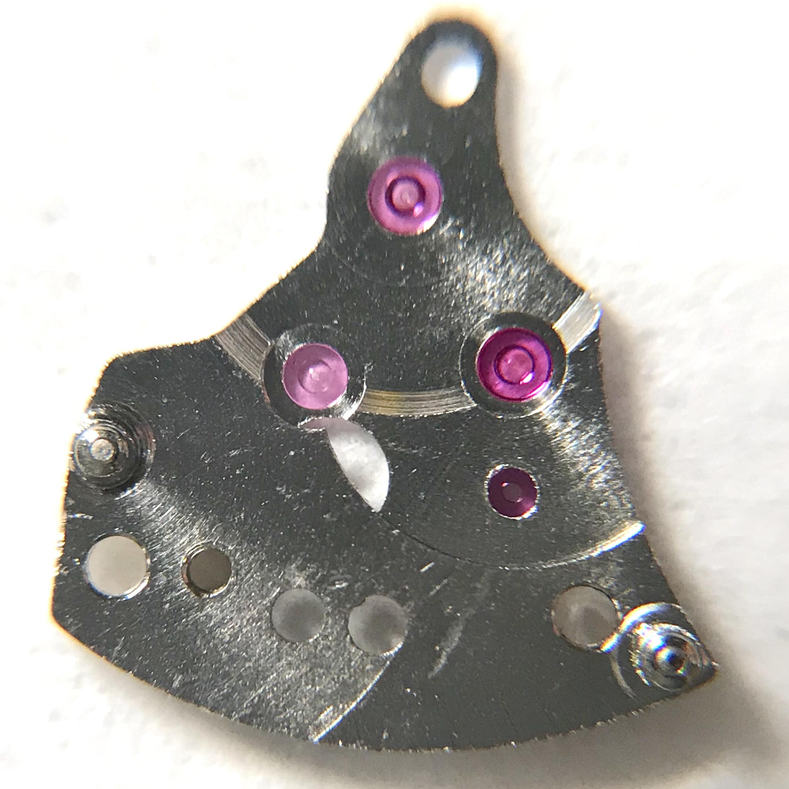

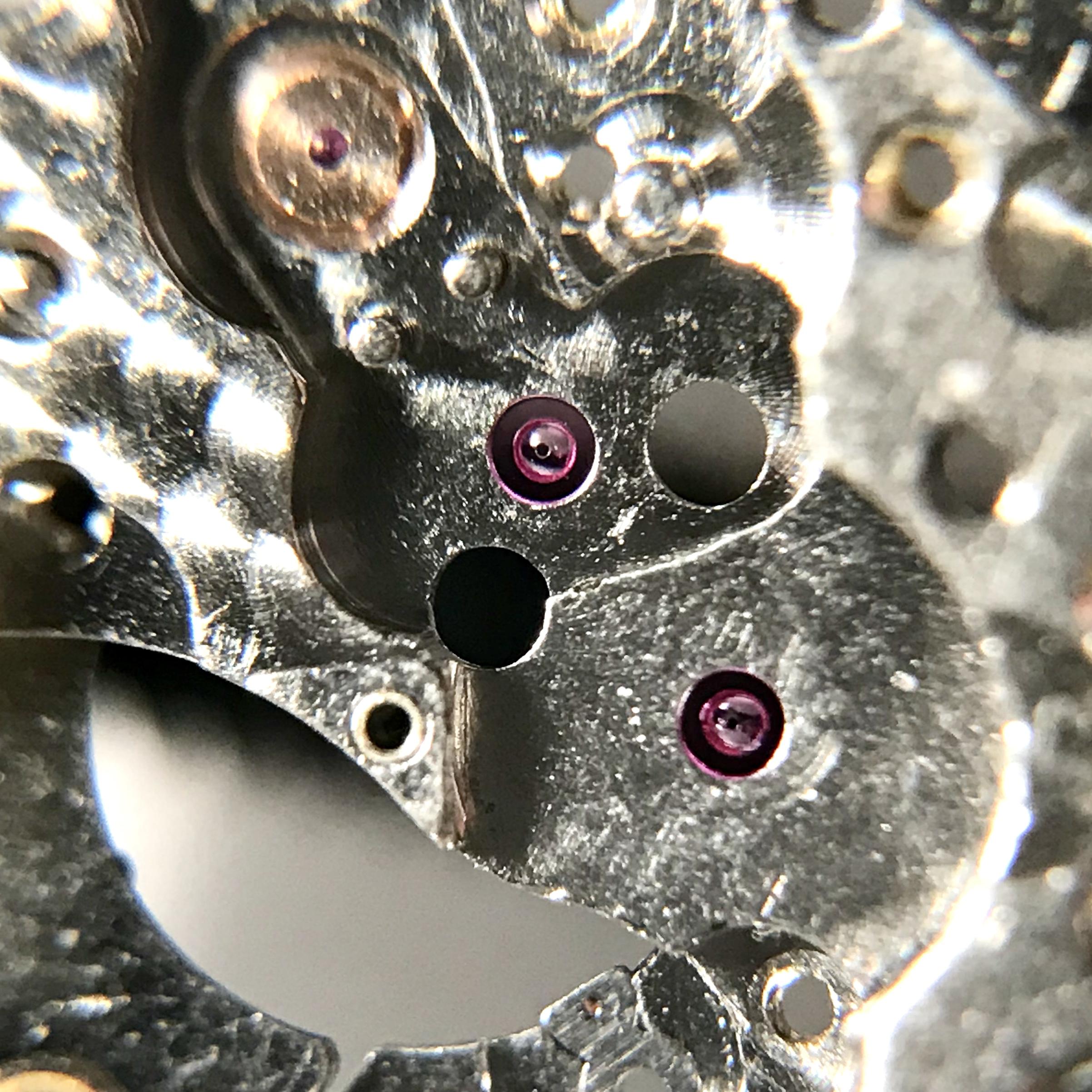

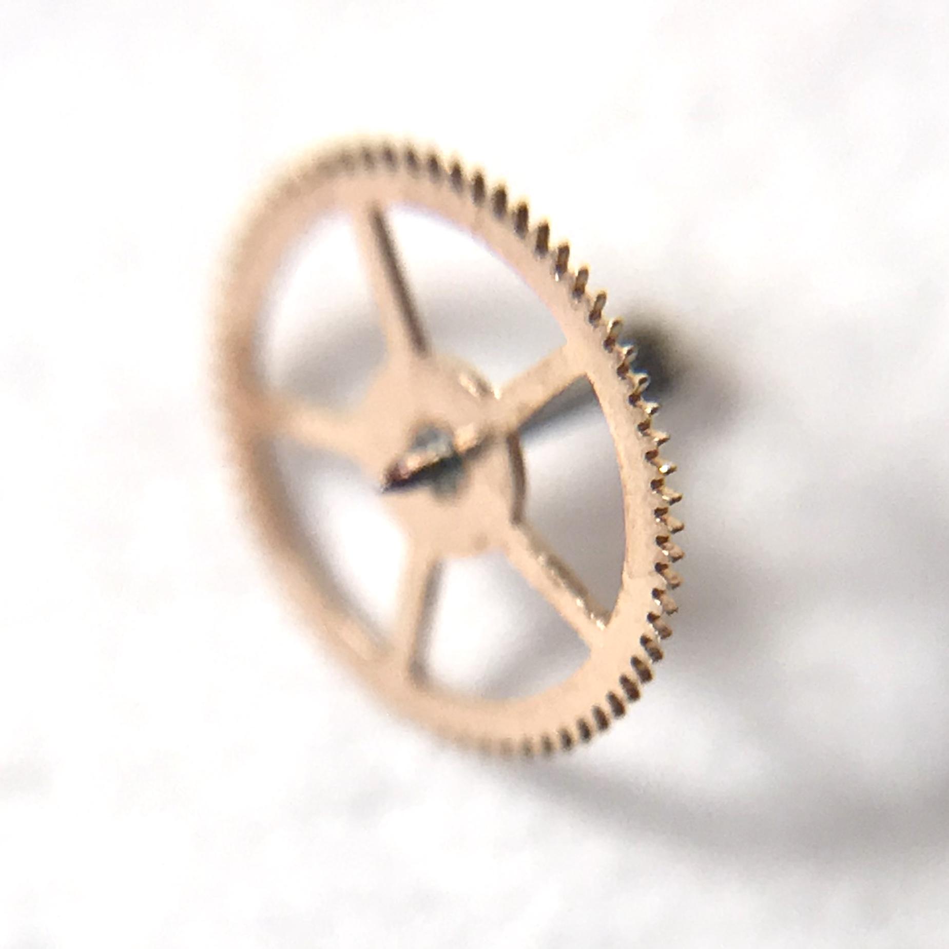

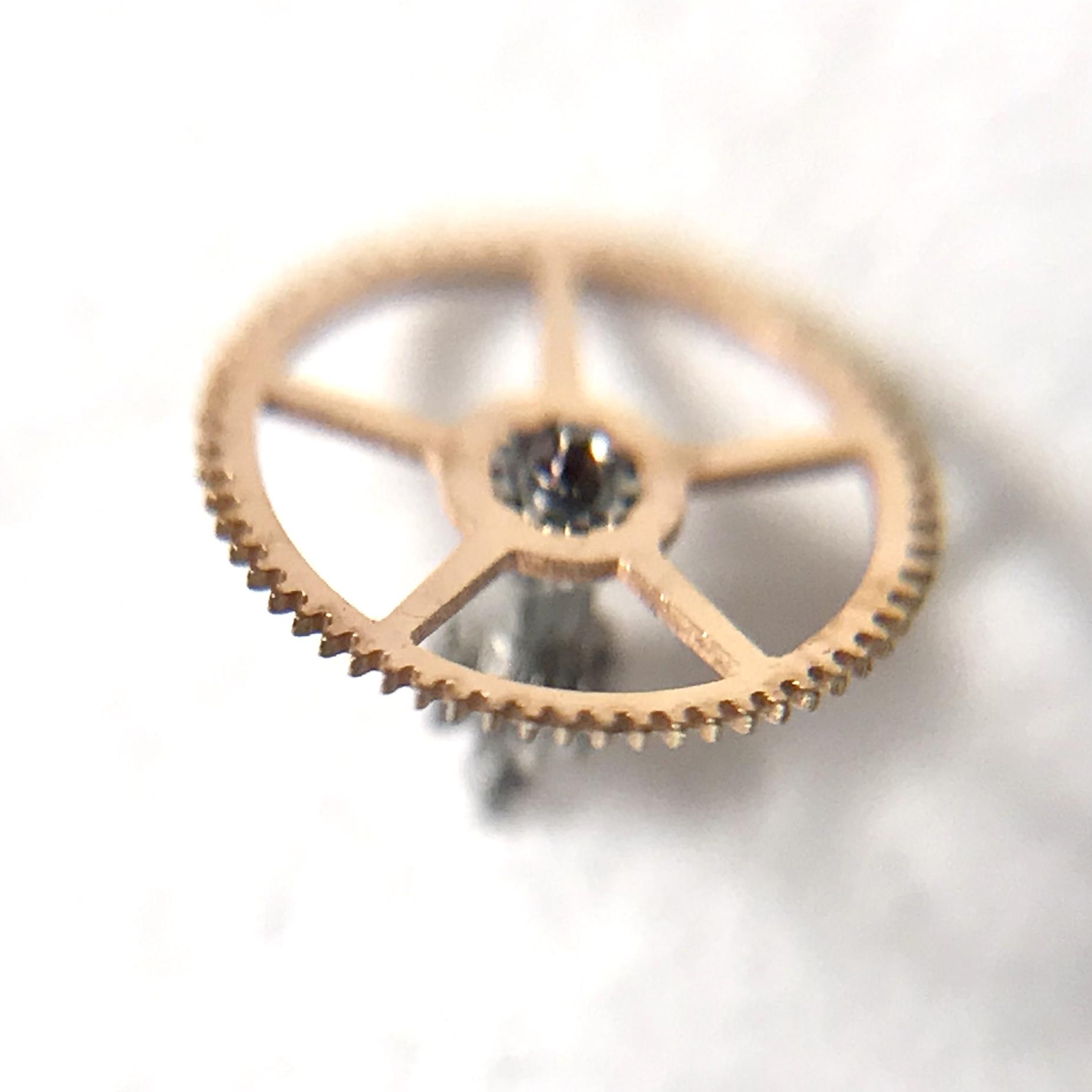

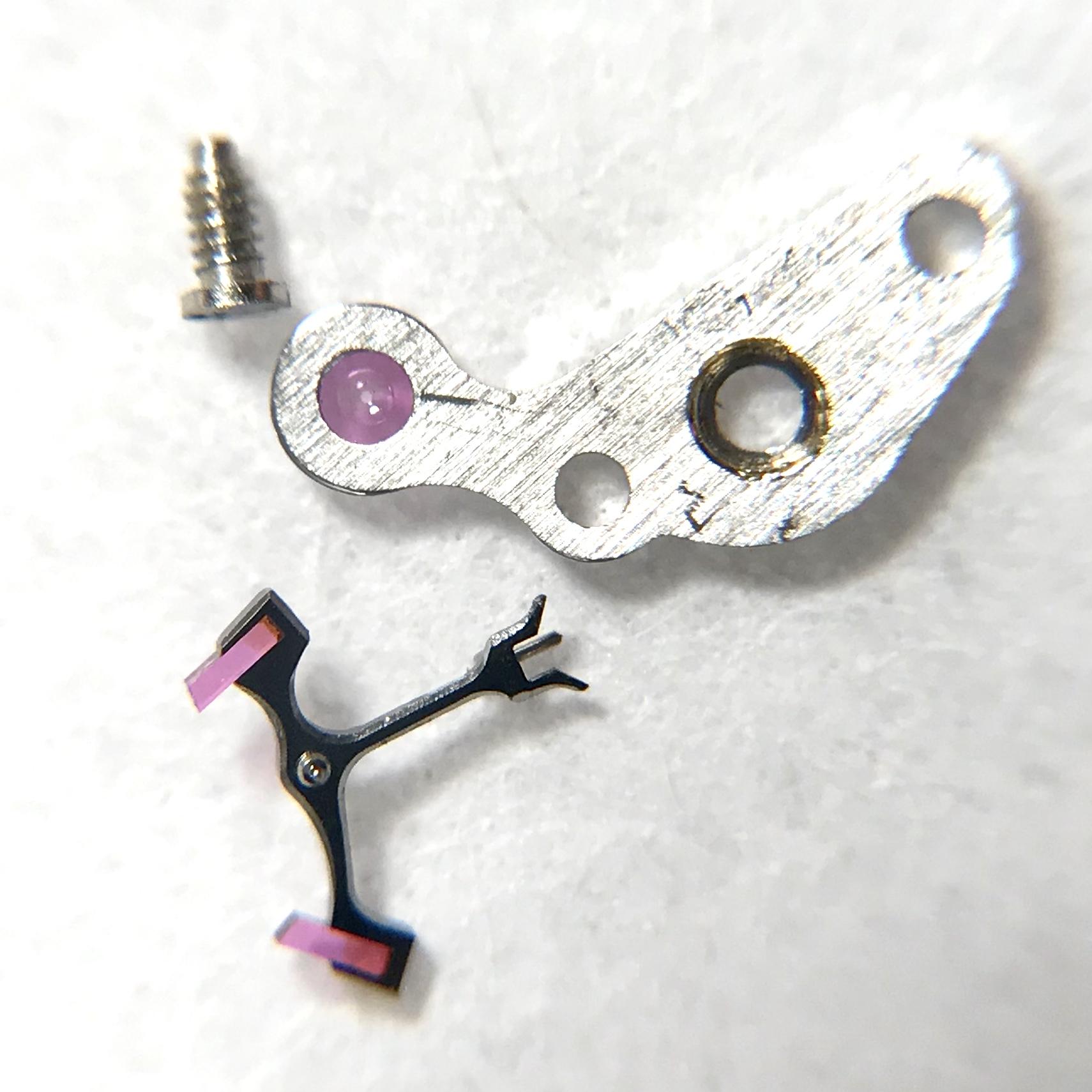

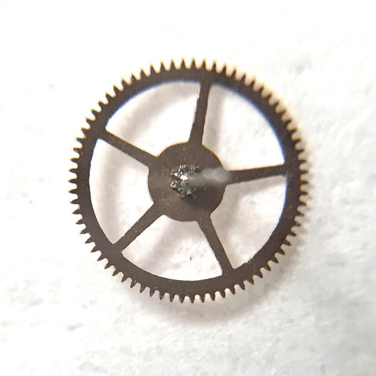

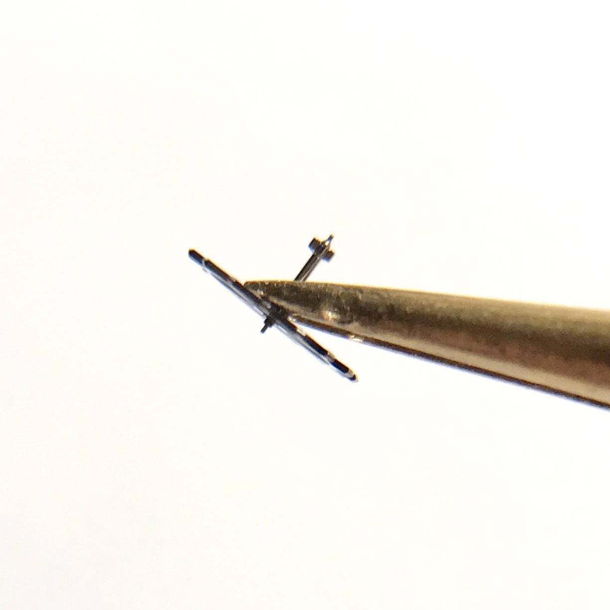

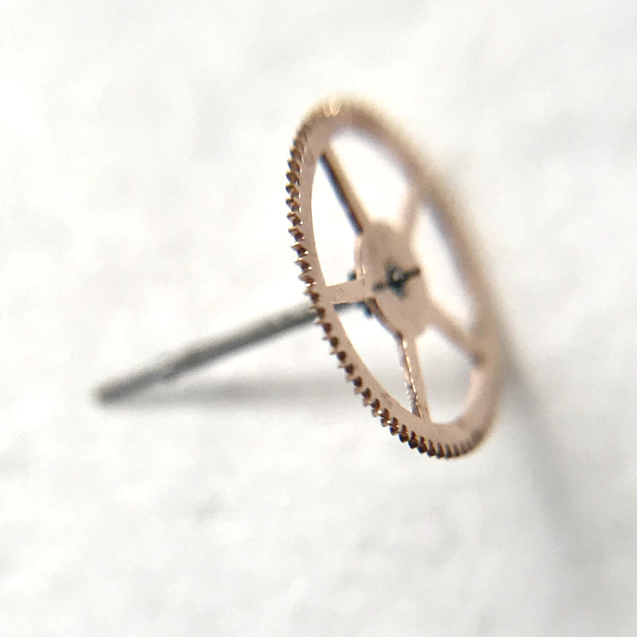

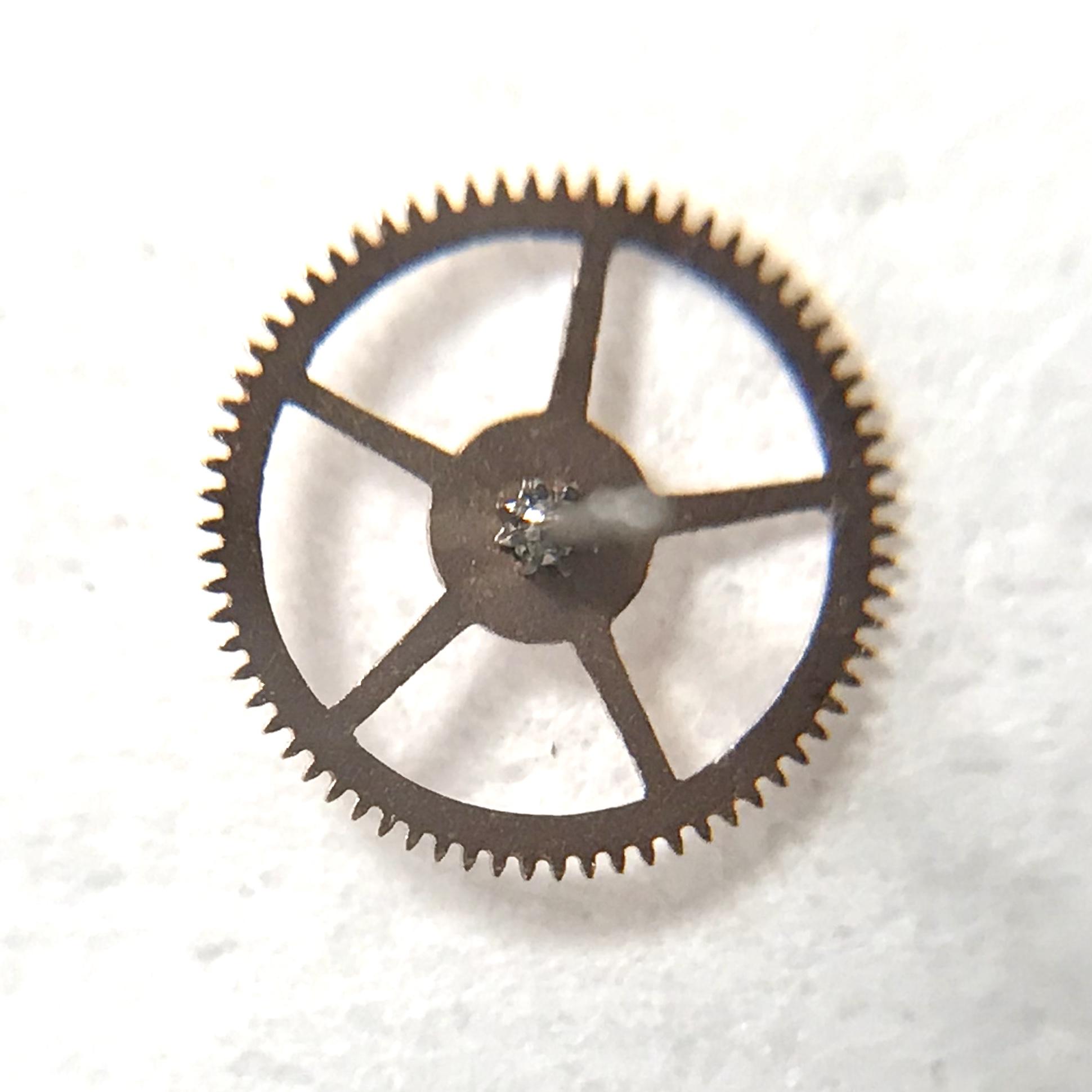

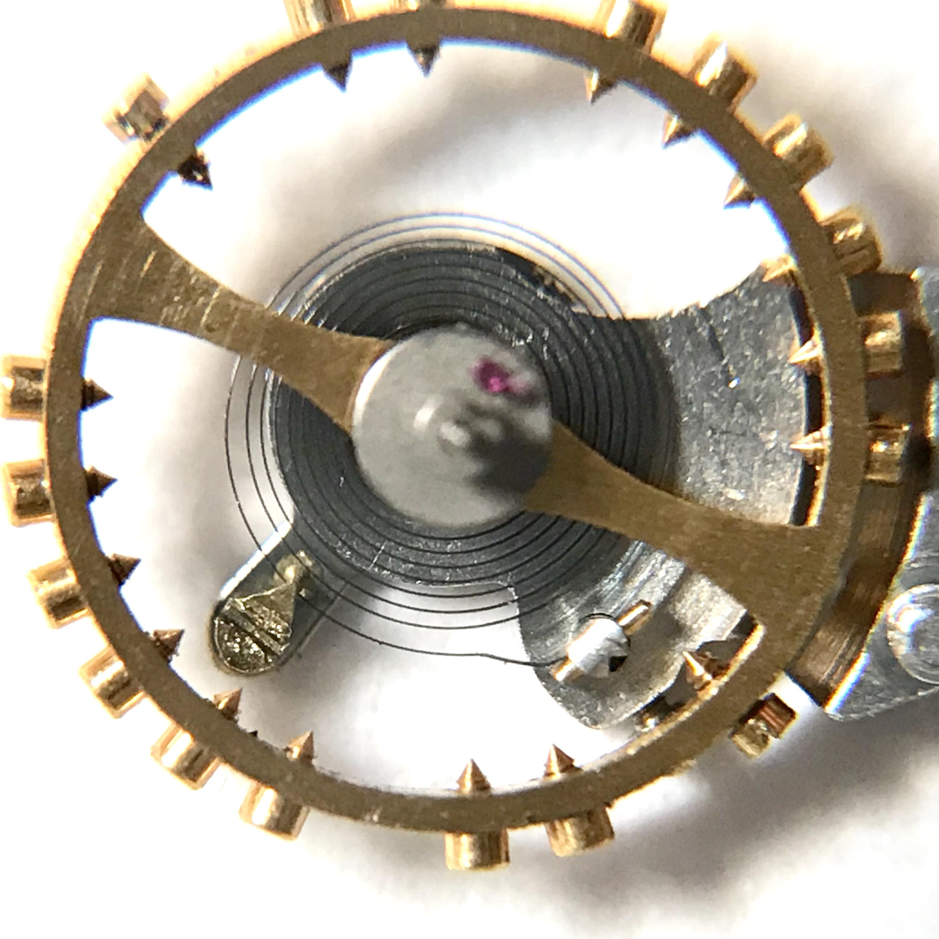

Okay, so here’s what I’ve got:
- Took a vídeo slow motion of the balance wheel in action. I don’t notice any sticking but I will figure out how to post and link to it shortly for thoughts.
- Hairspring appears to have a nice shape.
- Each wheel in the train has a small amount of end shake. Nothing excessive. None lack a small amount of movement (or are tightly in there)
- Wheels all seem to have their teeth in tact
- Jewels appear clean, full, and with good holes. However i do wonder about the bottom pivot for the 3rd wheel  it looks like it’s a metal one. I’m having trouble seeing if that one is clean and structurally sound (see pic with the arrow)
- Clean, free movement of the train
- Listened to the movement - with my ear as I don’t have a proper rig to listen. To me I hear a pretty consistent ticking with the oddball double click. I also note I believe I’m hearing it tick strong to weaker to strong again. Not sure if that’s in my head or real...
Please take a look at the attached pictures. Let me know if you think I missed anything. I’m going to clean these pieces again, lubricate, and reassemble. I will test the free movement of the train as I go, try to achieve some recoil, and see what that gets me. I plan on also re-cleaning the Mainspring. I wonder if I over lubricated and it’s now slipping - would that be a possible culprit?
I will post new timegrapher pics of dial up and down once I get thru this.
Im happy to post more pics of any part you’d like to see more of if it helps.
Thanks again!

Are you sure that isn't a missing jewel.
How many jewels do you count?
How many should there be?
Expand
The movement indicates 21.
I count 21.
4 - balance staff
1 - impulse
2 - pallet fork
2 - pallet
2 - escape wheel
1 - second wheel
1 - third wheel
2 - intermediate wheel
6 - reversing wheels
All accounted for.
Waiting on new Timegrapher to arrive. Update will be forthcoming once it arrives.
