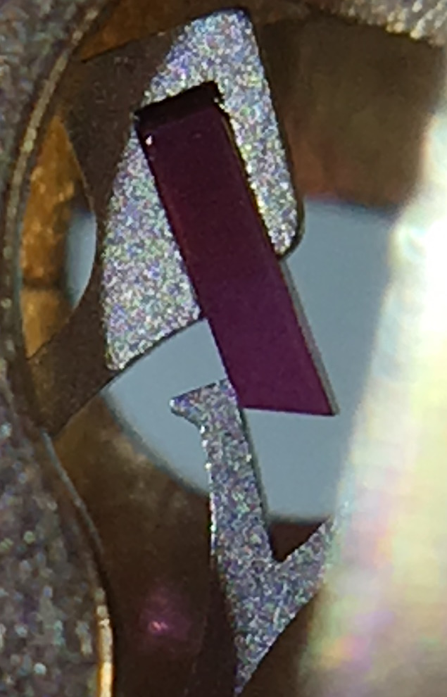

This newly serviced Unitas movement calibre 6380 suffers from too low amplitude. Dial up about 225°, dial down about 245°, and about 200° in all other positions. I’ve went through my list of possible causes but couldn’t find anything obvious. Then I remembered that Mark Lovick in his watch repair lessons mentions that “too much lock may reduce the power available for impulse” and I suspect this could cause too low amplitude?
I don’t have enough experience to determine if what I see in the pictures is too much lock, but I assess that the amount of lock to about 1/3 to 1/2 of the width of the impulse face, and I believe that could be too much even for this calibre?
So, if there’s too much lock and it affects the amplitude, two questions arise; what could have caused it and what would be a practical remedy?

Hi  Probably been like it from the day it was made being acceptable at the time, as the escape wheel and fork position are fixed the only movable part is the fork jewels, and that's job and a half getting them right.
The lock looks very heavy. Whether it's due to the jewels being too far out or the bankings being too open is impossible to say just looking like that. Does it have banking pins? Are they straight?

Fixed banking! So, would you assess that the heavy lock is the likely culprit for the low amplitude? I would assume so but I want to make sure. Any suggestion for a solution?
If you've eliminated other causes then yes you will increase amplitude by decreasing lock.
You have to check it to see if the stones could/should be moved, or if the only option is closing the bankings.
This is something you spend weeks on in school, I would suggest checking something like the Chicago School of Watchmaking course or Bulova School course (both can be found for free online I believe) for insight.
You could of course try a different fork and see if that has any effect.
I don't see any evidence of other damage that might cause the fork to be out of alignment, but I guess it is possible that the fork is either out of tolerance (though I have never heard of shellac swelling, but I guess that might be a possibility), or the fork and/or balance and/or escape wheel have been replaced at some stage with a defective part, and the movement hasn't run correctly since.

Ideally your dial-up and dial down amplitude should be the same. If it is not it can be an indication of pivot problems. Then from your pictures of the fork it looks like there's a little room behind each of the stones you just have to move them back a little bit.

Escape wheel and pallets look unlevel to me.     QUESTION:     Can such unlevelness be the cause?
First, the shown deeper lock (esp. 2nd photo: too deep) seems not very likely to reduce the amplitude so much.
If it is a pallet or a banking pin issue, is not difficult to find:
essential is the point, where the wheel tooth hits the pallet jewel. The pallet fork must move a bit more then for security, until stopped by the banking "pin". If this movement is considerable, the banking pins (hrer: gap) are too wide else the pallet jewels are too long.

This pallet fork comes from a Unitas calibre 6325 that I recently serviced. It has perfect amplitude.
This pallet fork comes from the Unitas calibre 6380 with the inadequate amplitude.
Searching CousinsUK.com for this part it becomes clear that these two calibres (6325 and 6380) share the same pallet fork (restricted, of course). However, as you can see, the guard pins differ. That makes me wonder if the pallet fork of the 6380 (having the poor amplitude) has been replaced at some point, or if the different guard pins are of no importance?
At this time, I do not have the skill or tools to relocate the pallets, and for that reason I haven’t even investigated if that would be an option. However, a new pallet fork for the 6325 is available on eBay. So, what do you think, would it be worth taking a shot at, hoping it would solve the problem?

From your observations its imminently possible the pallet/fork has at some time been changed in the past. If the replacement supplied by Cousins is the same as the one which gives you correct readings ie (guard pin) and depending on cost,  myself I would change the fork/pallet, that being the logical thing to do as moving the jewels is an art and could lead to further problems. I am afraid the choice is yours,

It does look like quite deep locking, but I wouldn't assume that it isn't normal without a comparison. Don't compare it to any Chinese copies as I tend to find that these have a very shallow lock.

Hi, Generously apply kerosene or diesel fuel to escape teeth like you do lubricants. This will dilute the oil, reducing drag, you are very likely to see much enhanced amplitude.
If you see 280 degree amplitude you can conclude the deep lock was,nt much of impedenace.
That the easy part. The tough part starts if you accept to grind the pallet to shorten the length using my approach. :chainsaw:
