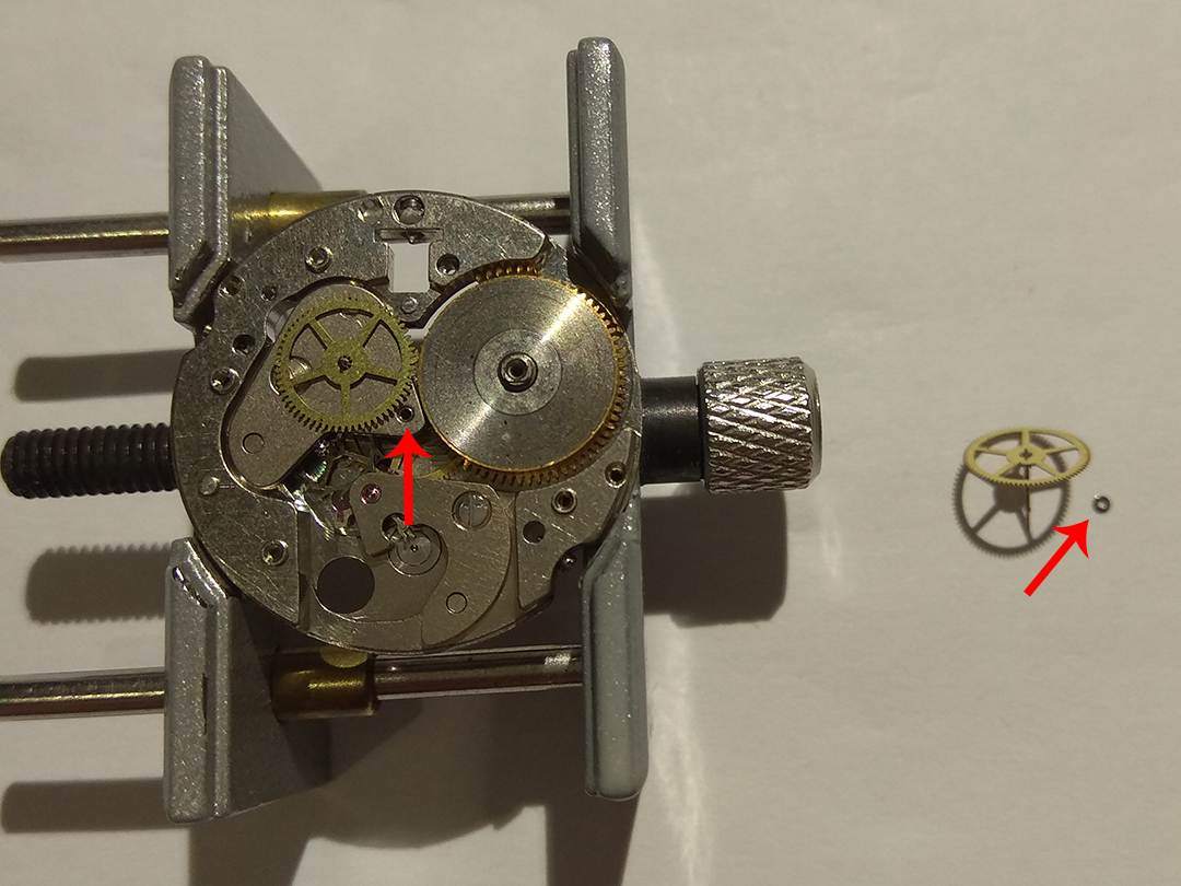

  9. If you haven't work on a 66 previously, remember when disassembling it that there's a tiny washer between the 4th wheel and the center wheel bridge. It can be easily forgotten and get lost in the ultrasonic or in the cleaning process.
    1 point
  10. Thanks for the responses. I took all apart, installed just the third wheel and train bridge - it looks and feels like it's as it should be. Thanks for the details Nucejoe, this is all a bit of a learning curve. I'll take it apart again and try that sequence watchweasol, see what it looks like. I've got my best technician checking it for me now as you can see in the photo, will see what she says
