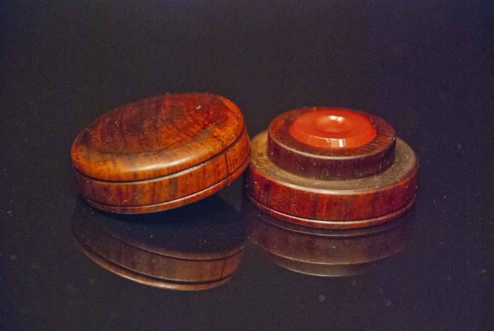

Hi there, friends of mechanical movts,
for cleaning oil pots I use brake cleaning fluid, a mixture of different hydrocarbons. The same can be applied to clean watch parts and solve debris from aged oil, grease etc. But don’t forget to open the window :crazysmile:
Oilers: I use several of the coloured series but for the escapement I made a “special tool”. A grinded sewing needle. To concentrate very small amounts of oil I fell it is helpful to apply epilam on the tip of the needle.
Regards
