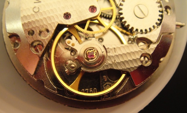

Thanks for all the useful tips and tricks. I will try these for sure. Sounds like I am not the only one that struggles with these. I notice as well there are many different systems and I can not find their names. I just generically refer to them as Incablocs although this is not correct. I am working on a CWC mechanical movement ETA 2750 and on the balance it has a broken spring that looks like this https://www.bing.com/images/search?view=detailV2&ccid=es6%2ft9NH&id=45A43BDCF8672559FE9B0BCADC38815172195B5F&thid=OIP.es6_t9NHOVRRNSes09R7TQEnEs&q=cwc+mechanical+watch&simid=607999746927035395&selectedIndex=106&ajaxhist=0
I need to get a replacement but it is not Inca so don't know the size or name to search for a replacement. Can anyone help please. Seems my shock spring nightmare is set to continue.

 Been working at those a lot. They are a nightmare and i am afraid i am going to break one every time i open one.  But not sure what type they are? looks like a inca but has a different shape?
Hi Rogart63
Yes that is exactly how the spring looks. I ordered the ones for an ETA 2750 as listed on Cousins and parts pages and the ones that arrived were Inca block ones and they were far too large so ordered a smaller standard Inca style and have proved a nightmare to fit so assume the inca and the ones shown above are very different in dimensions and design etc? Do you know what they are called style wise and where I can order replacement springs and the best way to fit them?

Never seen them in any other movement then the CWC ETA 2750 watches.
Have a ETA 2750 somewhere here i think. Will take a look. If you can't solve it you can take a complete balance bridge from a Certina 25-... or ETA 2750 . Done that. but it's annoying not to now and it would help a lot. See if i can ask around on some forums. Like MWR maybe?
That 2750 i had used normal inca bloc springs of some sort. Did put a question up on MWR forum. As it is a military watch i am sure they now. or i will find out somewhere else. I did a shock spring thread on this forum . But not sure where it is.
@Andyworks i think i solved the mystery? It's a lubrifix 66 shock spring . They sit on a few other movement. like the ESA 9157 and ESA 9200 . Take a look at http://www.ranfft.de/uhr/index-e.html
Roland Ranfft help me in the right direction. Thanks Roland :) Not sure you are here on the forum .
I can take a look as i have some old ETA 9157 and 58 tomorrow. Maybe they have that spring.
That's great Rogart.  That is brilliant detective work. I have tried searching for suppliers and even on Ebay for spares but no luck. It is a mystery. Let me know how you get on with those movements you have.
Andy
I will. Found a 9157 that has the same kind of springs. Don't want to remove the spring from the balance bridge. But got a complete unit from the mainplate. That i can send to you if you want. I bought a bunch of ETA 9200 from ebay that has the springs. So a few more is coming in. I think you need at least one more. They aren't the easiest to replace.
