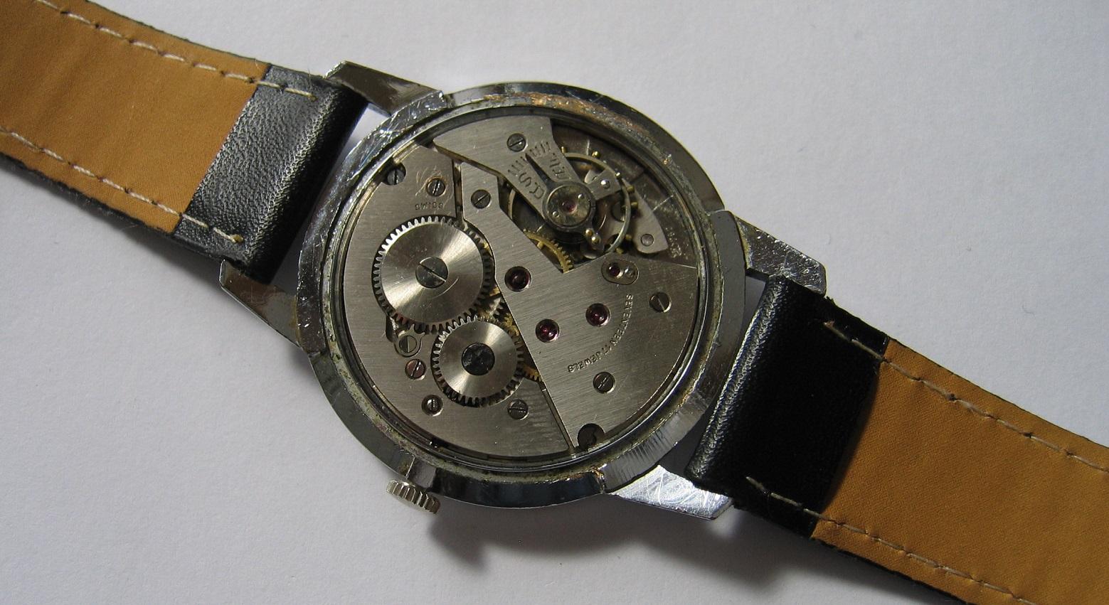

An escapee from my watchmaker’s bag of Horrible Dead Things, the only polite description for his parts stash of old broken pin-levers which he’d hoped never to need again until, to his undisguised horror, I introduced him to my old nonsenses some years ago. I always tell him that instead of just sitting there changing batteries and re-sizing bracelets on fashion watches all day, he should be grateful for my helping him maintain his traditional skills. By way of witty riposte, he tells me to “@&*# off”.
So, a forlorn Ostara which, although having lost the jaunty looks of its youth long ago, was willing to run with a little encouragement. The display back looked as time-worn as the rest of the watch so may well be original as I somehow can’t imagine anyone retro-fitting it to proudly exhibit its 15j EB 1344. The case and bezel topsides had lost their plating but have now been brightened up a little.
With that and new crystals fore and aft, new crown and the missing seconds hand replaced, it now looks almost presentable.  Oh, and it’s also had a new balance staff, because when it fell from Mr Grumpy the Watchmaker’s grasp, he expertly managed to dropkick it the length of his workspace whilst attempting to cushion its fall with his foot. Cue Mr Even Grumpier the Watchmaker.
The watch was by Walter Ris of Grenchen, founded in 1945, with the Ostara brand following in 1950. They were making watches certainly into the ‘70s before liquidation in 1997 and eventual dissolution in 1998.

3 hours ago, watchweasol said:
Hi  How is Mr Grumpy ?
Mr Grumpy G. McGrumpy's demeanour never changes. It's his default position and similar, I suspect, to most of his dwindling band of fellow-professionals.
We know each other well, with him having worked on some hundreds of my old nonsenses. I've never been inclined to use the smiley "watch repairs" guy who would also cut me a new key, fix a shoe, and charge me 2x what my watchmaker does before it goes to him anyway.
Regards.
That's actually very nice. Surprised that no Asian has bought the name yet, as commonly happens, maybe the holders ask too much. Even re-making it verbatim would sell in the lineup of a microbrand or Kickstarter.
