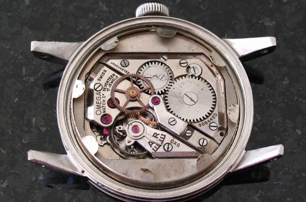

Not one to sit on my rear end doing nothing i thought id start back with a good old Omega ( one of many to finished ).
Newly finished and back to health ( like me :) ) 1943 - Omega 17.8 SC Early Waterproof Casing - All original
The balance was almost beyond repair but after many hours work she back in business.
Next  one on my hit list is a 1966 Seamaster Cosmic :)

I'm curious ,...what did you do to repair the balance ?
Good news to hear that you overcame the virus issue .  I used to get bad virus's on my PC , so I switched over to a Mac....yuk yuk...
Clean looking Omega . Which caliber is it ?

The calibre is a 17.8 SC or otherwise known as a R300 i believe ?
The balance was stripped down completely, the upper cap jewel was treated for rust, regulator boot adjusted, the hairspring was carefully formed back to correct shape which took most time. The whole assembly needed a thorough clean and a careful hand, but the watch runs within a minute or so and only a 0.3 beat error. I will likely never wear it tbh as i like collecting this type and admiring it :)
I noticed also the original lume still glows quite well for the age ha ha

Nice watch MrBeat , ...I did a quick search on it and it seems to be from the late 30's early 40's .
It seems that it's a rectangle movement in a round case . I read that the OXG stamped on the balance cock had something to do with a US import , or something of that nature .
"in A. Kreuzer's 'Omega Designs' book he only mentions cal. R17.8 as having 17 jewels (all 300-310 cal. are 17 jewels)"
