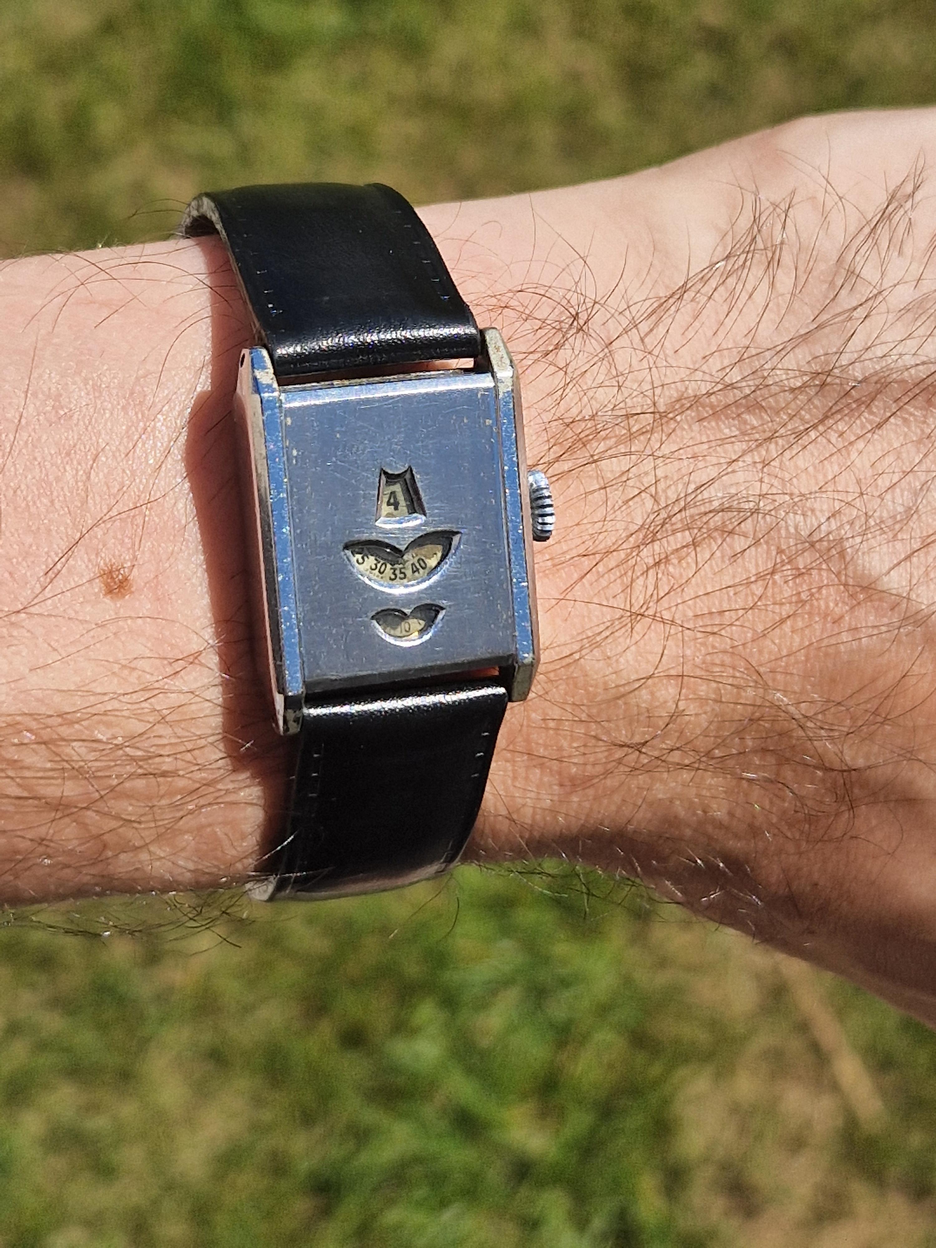

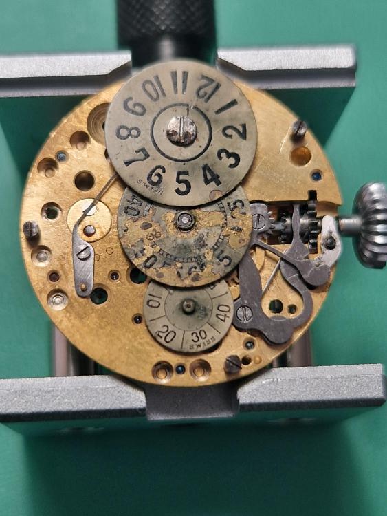

Hello everyone!
This 1930s non-branded jump hour watch has been my project for a month or so.
The balance spring was broken and the balance wheel wasn't staying in place. One of the old-school cap jewels was broken. And DIRTYYYY!
During cleaning, the plating on the movement parts came off... I then had to clean it again several times to the get it off completely.
Another non-running donor AS 574 movement helped with the broken cap jewel, but the hairspring also wasn't doing so well... I managed to get another balance replacement from the UK -- which arrived today. So this afternoon was the big moment to finally put the last elements together!
And it runs well!
To be honest, the timegrapher screen looks better than it really is. It fluctuates quite a bit over the course of a few minutes. The amplitude goes up and down between 280 and 315 (dial up, fully wound) and rate between +40 and -30. Must be a bent pivot (where the second and minute discs are directly attached). But I think it averages out. I'll wear it a few days and see.
Not sure if I'll tackle the beat error. Since I have manipulate the collet of the balance spring, it feels too risky. I doubt that I'll find another replacement if I slip...
It's a funny mechanism, I must say. The seconds disc is directly stuck onto a prolonged seconds wheel pinion. The minute disc is directly stuck on the canon pinion. And the hours disc is just screwed on without any connection to the movement --- it is moved by a tiny "thorn" on the minutes wheel and stopped from spinning by a special spring. When the "thorn" of the minute disc engages with the hour disc, the movement clearly struggles a bit with the resistance -- for about 1min, the rate goes down to -300sec/day and the amplitude drops by 50°. But as soon as the hour "jumps", the movement recovers quickly.
Next will be an effort to restore the minute disc.
