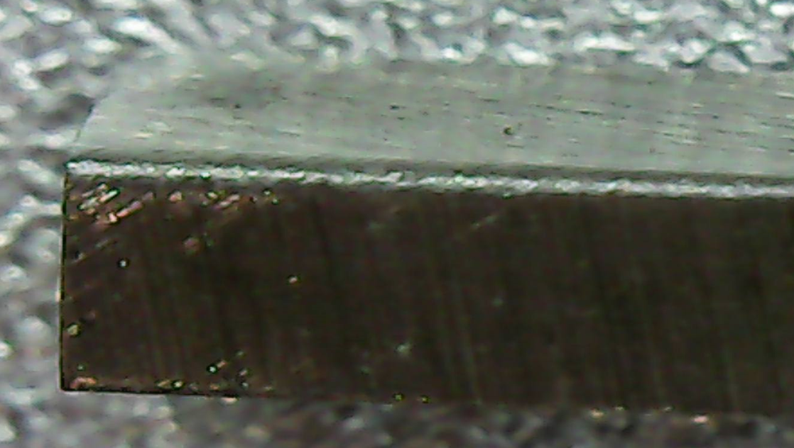

I have the Bergeon burnisher and so far I've only done some pivot rounding. The problem is there's not a lot of space to operate the rather large burnisher. After all there's just a small part of the pivot showing through the disc and when I rotate the burnisher it tends to hit places it shouldn't. I'd be happy with a smaller and more nimble burnisher. Should I work on my technique or would I profit from a smaller burnisher? Any ideas how to make one?

Yep lantern it is. I didn't remember the word. I'm talking about rounding the balance staff ends. I looked at valleyguy's links, sure I could just make a smaller version. Does anyone have experience on specifically making a rounding tool? Would that be even called a burnisher or just a file?

You do the end after the diameter. You want to pick a lantern that rests on the conical part of the pivot, both to avoid scratching and so that enough pivot is exposed so you can work on it. The cylindrical part of a typical wristwatch pivot is perhaps 0.3mm long.
The burnisher looks like the photo, and resembles the last image in John's post above. Whether one makes a flat pivot, slightly flat pivot, or rounded pivot, is a matter of discussion (isn't everything in this field?). I recall in school our instructor saying that when the Swiss started supplying replacement staffs for American watches, folks had issues with rebanking. The story is the Americans tended to make flatter pivots, the Swiss, rounder. A flat/flatter pivot reduces the horizontal amplitude somewhat, and can aid in equalizing rates between horizontal and vertical.
On the left is a Bergeon normal burnisher, the right the pivot rounding burnisher. It's essentially a flat escapement file with the teeth ground off, with straight grained lines just like the normal burnisher. It's really important to finish off by knocking off the burr formed when rounding the pivot; this does take some practice and a bit of a knack to get it to break off cleanly without scratching the cylindrical part. Basically, you come around with the burnisher until it's almost in contact with the cylindrical part. I do the pivot rounding in the lathe, with microscope, so it's clear when it lets go. Again, John's image actually depicts this, but it probably isn't clear the reason why the burnisher is going all the way to the cylinder like that. Also, I don't use a stone at any point in pivot finishing, it's all from the graver (cutting tool) then burnishers. That's how we were taught in school.
You can see the rounding burnisher isn't particularly small width-wise, but it has a very low profile, which allows manipulating it around the pivot in the small space around the lantern.

Thanks nickelsilver that was really helpful. Are fine escapement files fine enough or do I have to polish and refinish the surface?
 A file, even a 10 cut, is far too coarse. It doesn't have to be polished, but all the teeth must be ground off and the lined surface made. A coarse India stone is about right, or a coarse (about 280 grit, 45 micron) diamond hone. It takes a while to get the teeth off, so still best to start with the finest file you can find.
