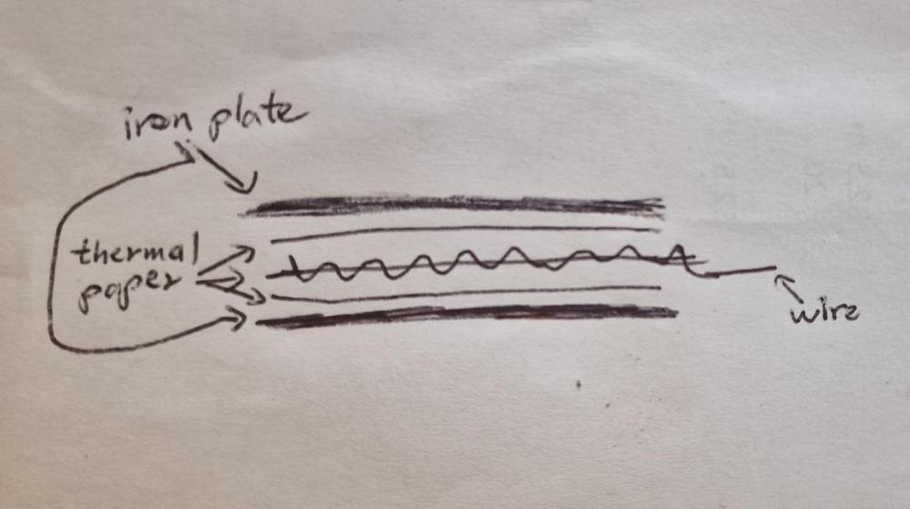

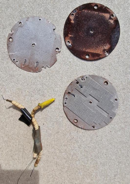

Hello,
I was renovating a Super Elite or Elite and unfortunately my heating element was broken. One time I ran into the same problem, in that case I resolved the problem with a PTC element but now I decided that I try to repair it.
If you want to refurbish an elma machine and get to the heating element, you have to handle it very gently.
The idea of the element that there is a spiral in the element that gives off heat that warms the plate.
The spiral is made of a very thin wire that can be broken after some small move or a delicate touch.

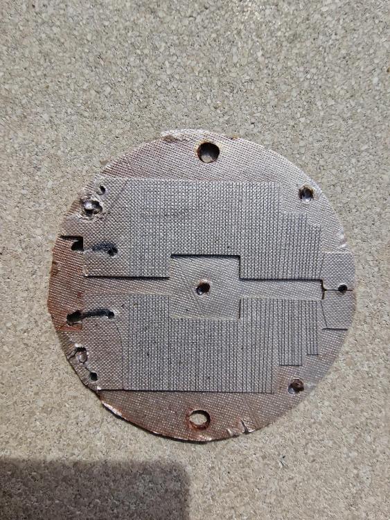

Between the two iron plates there are two thermal papers, and between these there is a thermal paper with the wire rolled up.
First I saw that there are 5 rivets that I drilled out.
Because of the rust the papers were sticked to the iron plates. I gently removed the papers.
In the middle layer I was expecting some soldering but finally I found on the "thick" wire that the heating wire is simply rolled on it.

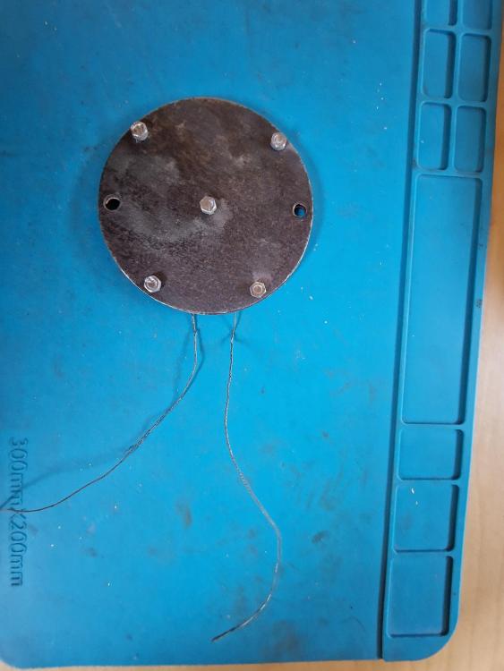

From the heating spiral I rolled off 2-3 turns so I had enough long wire that I could attach to the "thick" wire.
During the assembly I used antistat tape to fix the wires and the thermal plates.
Finally I fixed the plates with screws and nuts.
So, if you got a broken heating element, then you can disassemble it and if the wire it not broken inside, you can repair it.
If it is broken, you can use the original iron plates and attach a PTC heating element.
I hope this can help.

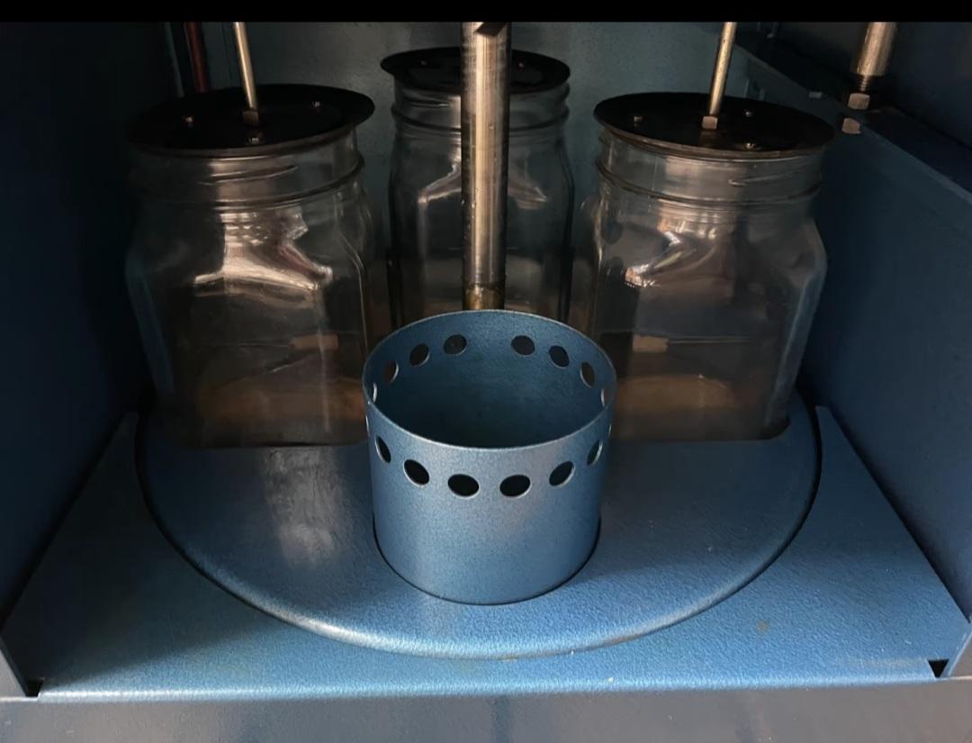

Regarding my Elma Super Elite MINIMUM SPEED CONTROL WHEN NOT DIPPED INTO LIQUID...
Hey, hope you are doing fine. Could you maybe help me with this. I have very tricky problem and I don't know what to do to solve it. I read all 26 sites and found partial answer to my problem but the problem is that it was woking totally fine also when not dipped into liquid just an hour ago (minimum speed set = minimum spinning speed) so there must be a way bringing it back to first mode, this is my question:
I know both are Elma one is just Bergeon signed, but I will call the old repainted one Bergeon and the newer original state Elma.
So Bergeon had a problem with speed, if dipped into liquid it was working fine but while running outside of liquid for rising, the speed on minimum set was almost full speed (I would say 75% of full speed).
Now I received newer Elma and I tested it and it was working fine so on minimum it was spinning minimum speed dipped or not dipped. As I had brand new Elma rotor and basket fame I changed it and here we go the same speed problem occurred on newer Elma.
But hey, I mounted that old basket frame to Bergeon and suddenly it is working totally fine.
So my idea was, ok maybe an old rotor is metal made and heavier and this is the trick with inertia speed so I changed them back as it was and Elma is still not working ok even if it worked fine before I changed it.
Second strange thing is that now Bergeon is working fine also with new rotor wich it wasn't working fine one hour before I changed it.
So now Bergeon is working fine with both rotors and Elma is not working fine any more with any rotor.
I didn't do anything else just changed rotor with basket frame and I don't know what happened and what can I do to bring it back to normal working speed.
Do you have any idea or maybe do you know who could help me with this problem?
I hope I wrote everything understandable as it is very tricky case.
Thank you for your help in advance.
