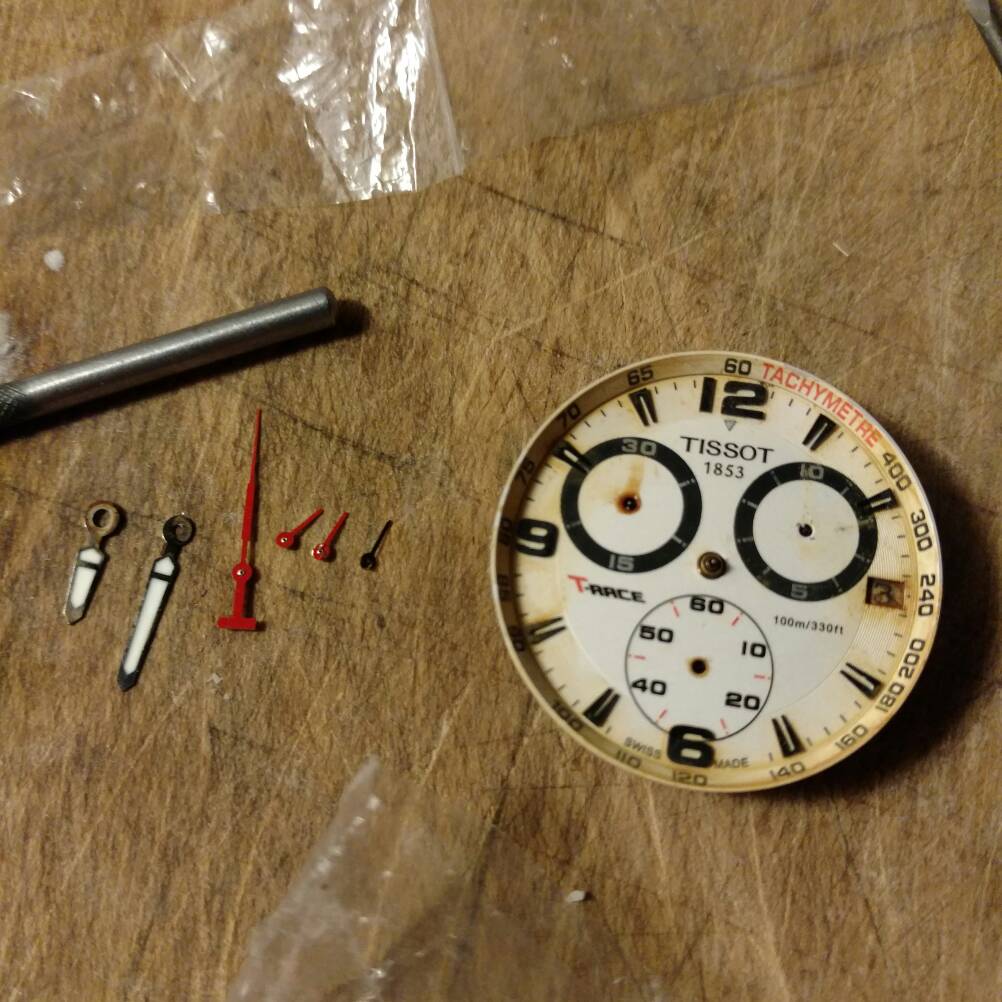

I'm going to post some photos of the latest watch that I purchased. It is a Tissot T-race. Brand new with water damage. I'll describe what I used on the dial and what I did to clean it. You can judge for yourself as to the results.IMG_20161230_230054_873.thumb.jpg.049e45
Here it is. Lovely and a nonrunner.
IMG_20161231_152847394.thumb.jpg.ea369d6
Here are the tools and chemicals. It turns out that the "cleaning vinegar" has a bunch of stuff in it that I didn't want to put on this dial. So, I didn't use it.
IMG_20161231_154722337.thumb.jpg.64ebc1c
Stripped down and ready to go.
Sent from my XT1585 using Tapatalk
IMG_20161231_174912_204.thumb.jpg.d42eac
Another pic before the bath.
IMG_20161231_174954_907.thumb.jpg.f519fb
The back of the dial and the date wheel on the movement. The quartz movement is obviously trashed, so I used it to basically hold the date wheel. The wheel was actually used as a guinea pig to see how aggressive I could get with the lemon juice and baking soda. You'll see the results of that cleaning.....Well, basically this is a rust staining removal thread.IMG_20161231_175146_958.thumb.jpg.5ec7fd
Here is the date wheel. I think it came out remarkably well considering how bad it was to begin with. I did rub off the number 3, unfortunately. But it took a lot of scrubbing to do it. I wanted to see the limit because I didn't know how aggressive I could get with the dial.IMG_20161231_175359_609.thumb.jpg.fffa1aIMG_20161231_175359_609.thumb.jpg.fc42c2
The dial in lemon juice and baking soda. This was done several times with very light scrubbing in between. When I say "light scrubbing", what I basically did was to let the baking soda contact the dial and NOT the cotton bud. There as a buildup of baking soda under the bud, so I did a swirl pattern without touching the dial.

IMG_20161231_175506_939.thumb.jpg.2bcdd2
Here they are together. I am pleased with the results overall. But, I will still look for a dial.IMG_20161231_175724.thumb.jpg.ff9f3bd150
Here it is recased.
IMG_20161231_180559_130.thumb.jpg.e2e162
And, of course, the before and after.
now, a few things....
when i started to do this, i considered what others have said about using liquids on a dial. i did use water as a rinsing agent and a neutralizer for the lemon juice. but, i did this because i figured that this dial was ALREADY under water at some point and the only damage to it was rust stains. going along with that, i also made sure to NOT touch the dial with the cotton buds while cleaning. i figured that the baking soda alone would be aggressive enough. the date wheel was another story: i did scrub that aggressively to see how much it would take to do it some damage. it took a LOT of abrasion, i can tell you. but, i did wear off some of the number "3".
now, the tachymeter ring did suffer some damage. the numbers "200" and "240" are partially removed. and also the paint near the number "70" has flaked off.
i went into this rust removal knowing that all of it would not come off - and it didn't. i had resigned myself to look for a replacement dial in any event.
one of the chrono hands did suffer from bending while removal because it had rusted to the pinion. all of the pinions did remain intact.
also, i did break the stem while removing the crown. when i pushed the release for the crown, it was frozen and would not release the crown. i pried it off with a screwdriver. the remaining part of the stem remained in the crown, but came out readily with pliers.
one of the disappointments with a watch of this price, is that it has a snap on caseback. i cannot believe that tissot would not provide a screw on back cover. you can get $12 chinese quartz watches with screw on rear covers! why not this tissot?!
the gasket is missing and i CANNOT get it to snap back on. i put a replacement gasket on the cover to create some friction to hold the cover in place, but i cannot get that cover to stay on. perhaps it needs a full diameter gasket to hold it.
overall, i am glad to have won this beast. i love it. i plan on getting a new movement and (hopefully) a replacement dial. it's a keeper for me......well, until someone offers me the right price for it.
