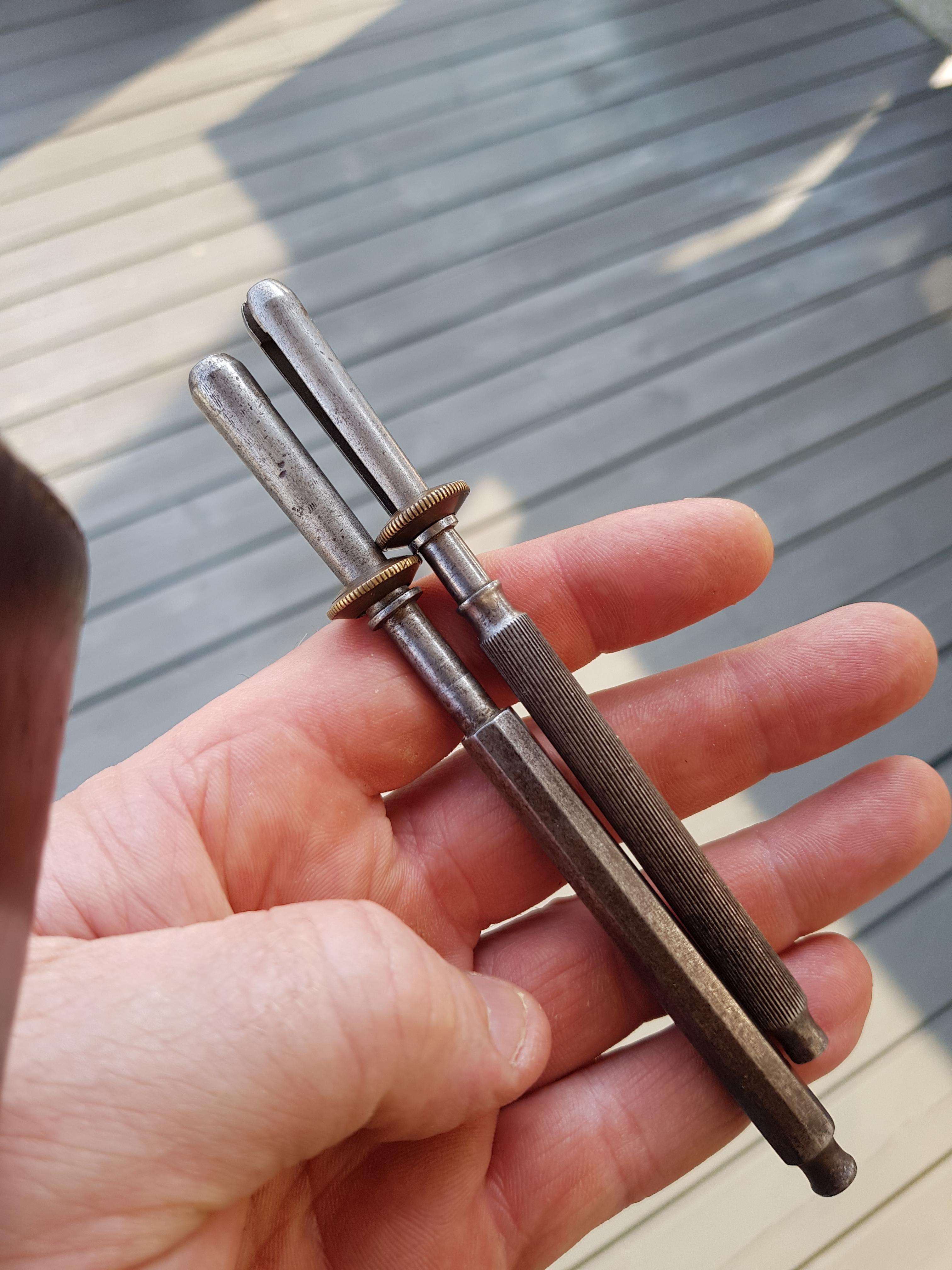

  5. Are these also called sliding pin vices? I got mine from Cousins for £3.50, but needed to refashion the last 5mm of the jaws from 90 degree sharp corners by removing 0.5mm at a 45 degree angle. The gripping surfaces are therefore flat (not ideal but better than sharp corners). The "cutting" was done with a fine diamond file. Spreading the jaws out was done with a shard of hardwood. The hardest part was holding the workpiece. I'm a novice watch butcher, so please feel to ridicule.
    2 points

  22. I have one of these - excellent pin vice and worth the money. I rarely use it on barrel arbors - I find stout tweezers usually do the job
    1 point

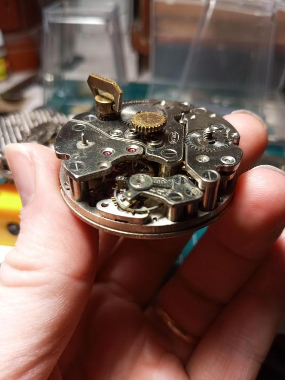

  30. For the last couple of evenings, I've been working on an Amida 15 Jewel based on the Amida 500 movement from sometime around 1950. This is a slightly odd mechanism, as it has the initial appearance of a jewelled lever arrangement, but is in fact a pin lever. The movement is well made, and pretty easy to work on. After a little swithering, I did change the crystal. It looked original, and I would probably have left it alone, but it had yellowed somewhat, but the thing that sealed its fate was the crazing that became evident if the light struck it from just the right direction. As you can see, it made a marked difference to its appearance, although some might argue that the yellowing gave it a warmer look. I'm in two minds also regarding the hands. I suspect they might polish nicely, but the nagging voice in my head is saying, they might also end up looking uneven. It does run reasonably well all things considered. It doesn't quite qualify for the 404 club, as it came in at a rather too hefty price tag of £4.99 GBP. but since I've made a few other exceptions to the rules recently, it may just get an honorary membership. There are a couple of other issue I need to address. The first is the fixed pins and rather small lug width, which measures at a rather odd 15.3mm. I'll either need to source a strap, or perhaps use this an opportunity to make a custom sized strap for it. The second issue is.. do I dare set fire to the old crystal, just to see if it is made of nitrocellulose? If you hear a loud bang and detect the smell of singed eyebrows, then you will know the answer.

  35. These are super. With brass or bronse jaws.
    1 point
