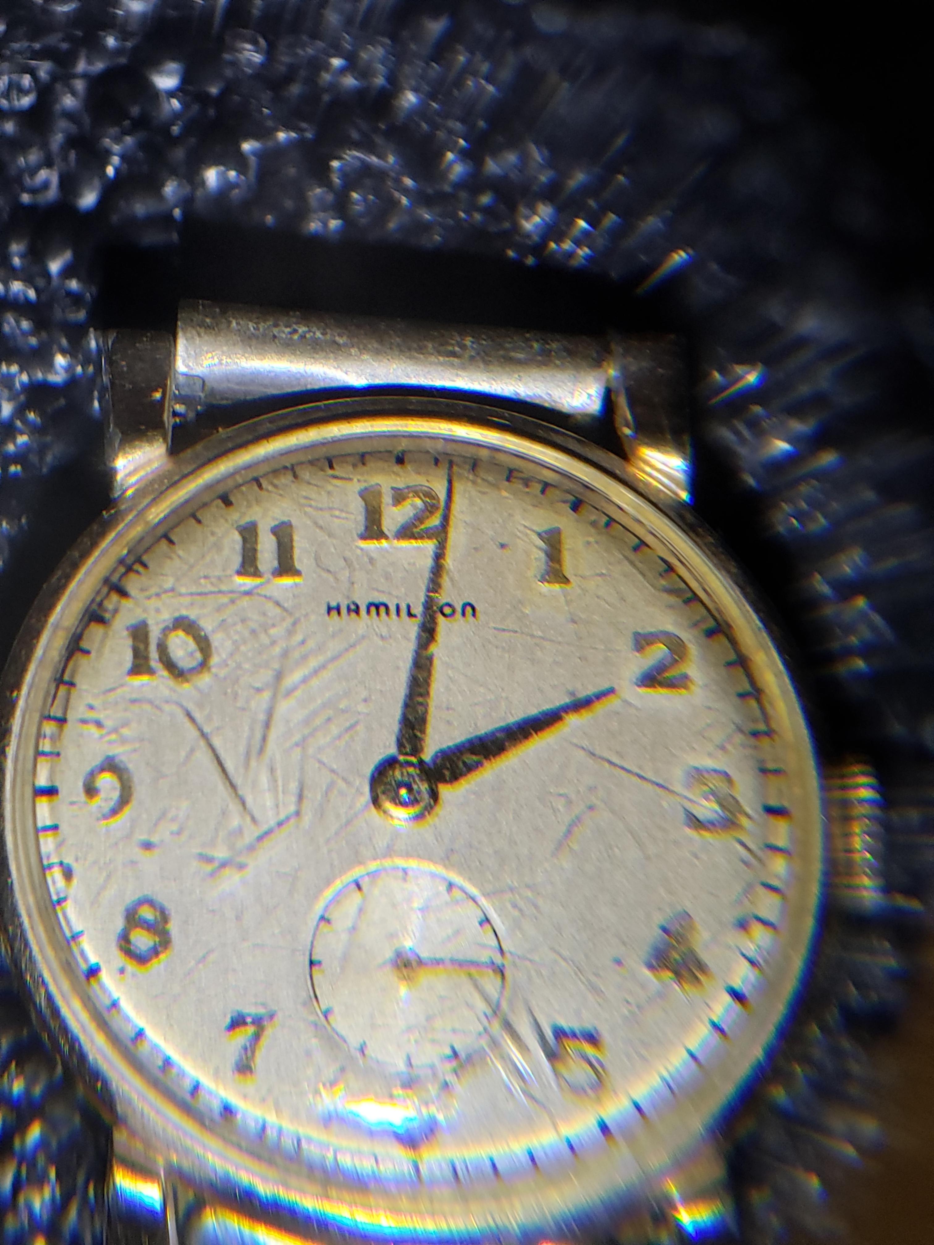

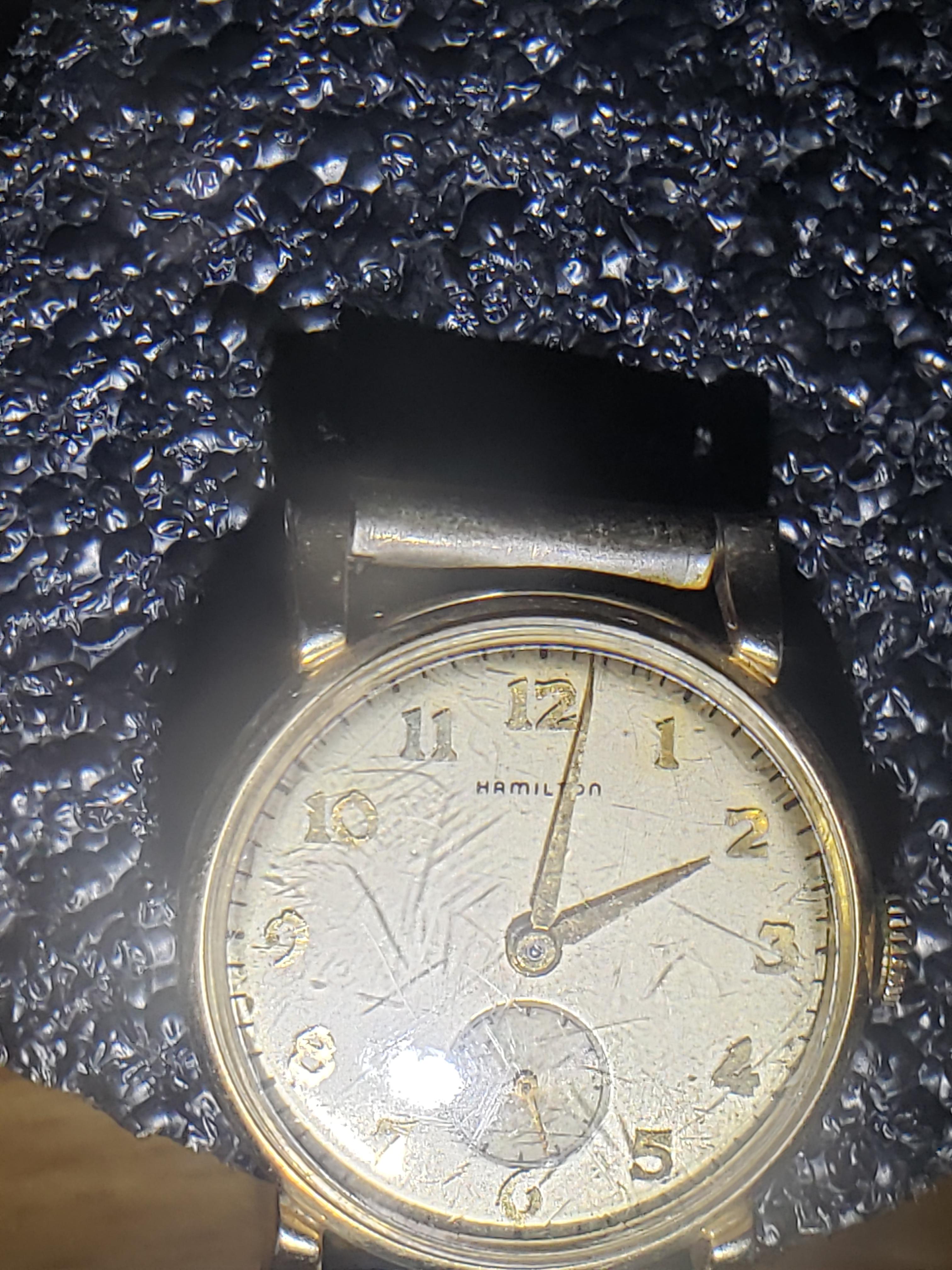

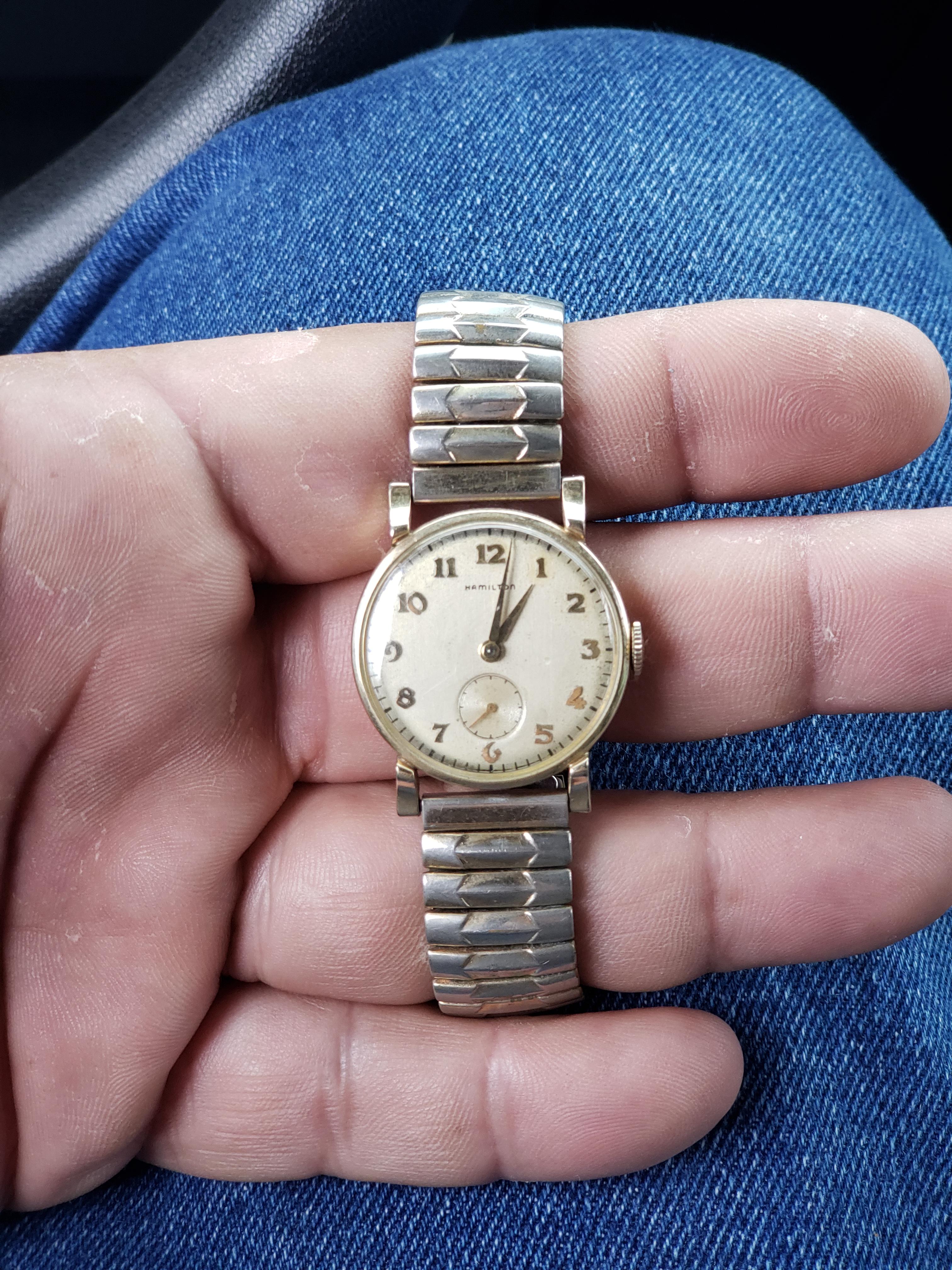

  11. Hello everyone, this is my new find today! It is working, actually keeps good time so for! I actually think its gold. But heck for 30 dollars, if it isn't, its still still nice looking. Has a 30mm and Is a Hamilton 747 movement. What are your thoughts? Thx!!!

  14. Thats my plans, clean her up, oil, and leather straps! I do think it is gold plated. Thanks alot, I'm a beginner, and appreciate the help and encouragement.
