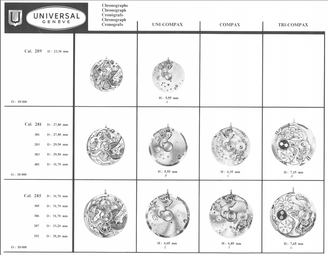

  8. Yes all these 28X has a close likness since they are based on the same movement. Your movement is 16"' (Ligne) in size. To convert this to millimeters one has to divide the ligne meassurement with the magic number 0.44326241134752. So, 16 / 0.44326241134752 = 36.096 mm. So it should actually be a bit over 36mm when you meassure it. Then we have the UNI-COMPAX, COMPAX and TRI-COMPAX, here it is probably easier to see a picture of the differences on the dial side. Hope this helps.
