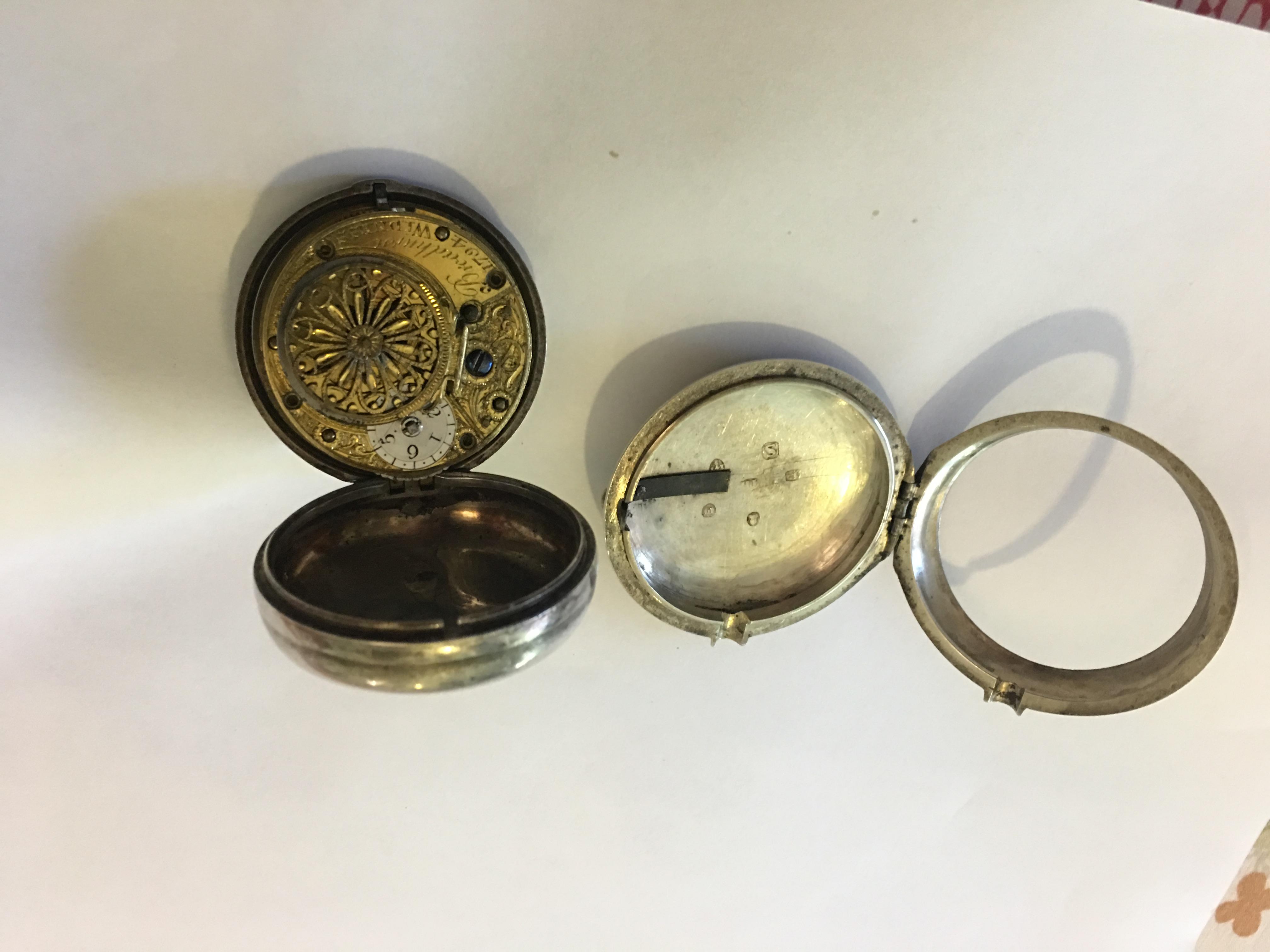

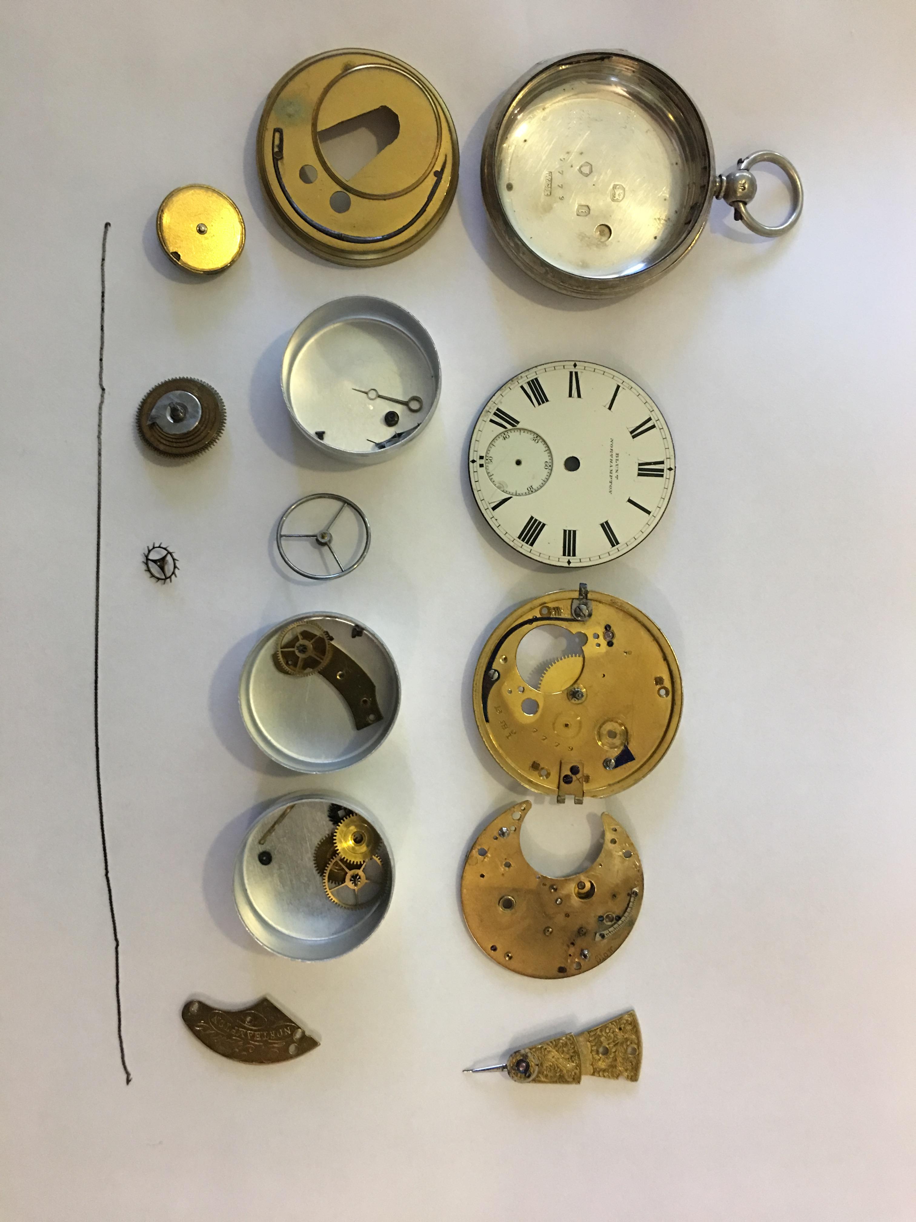

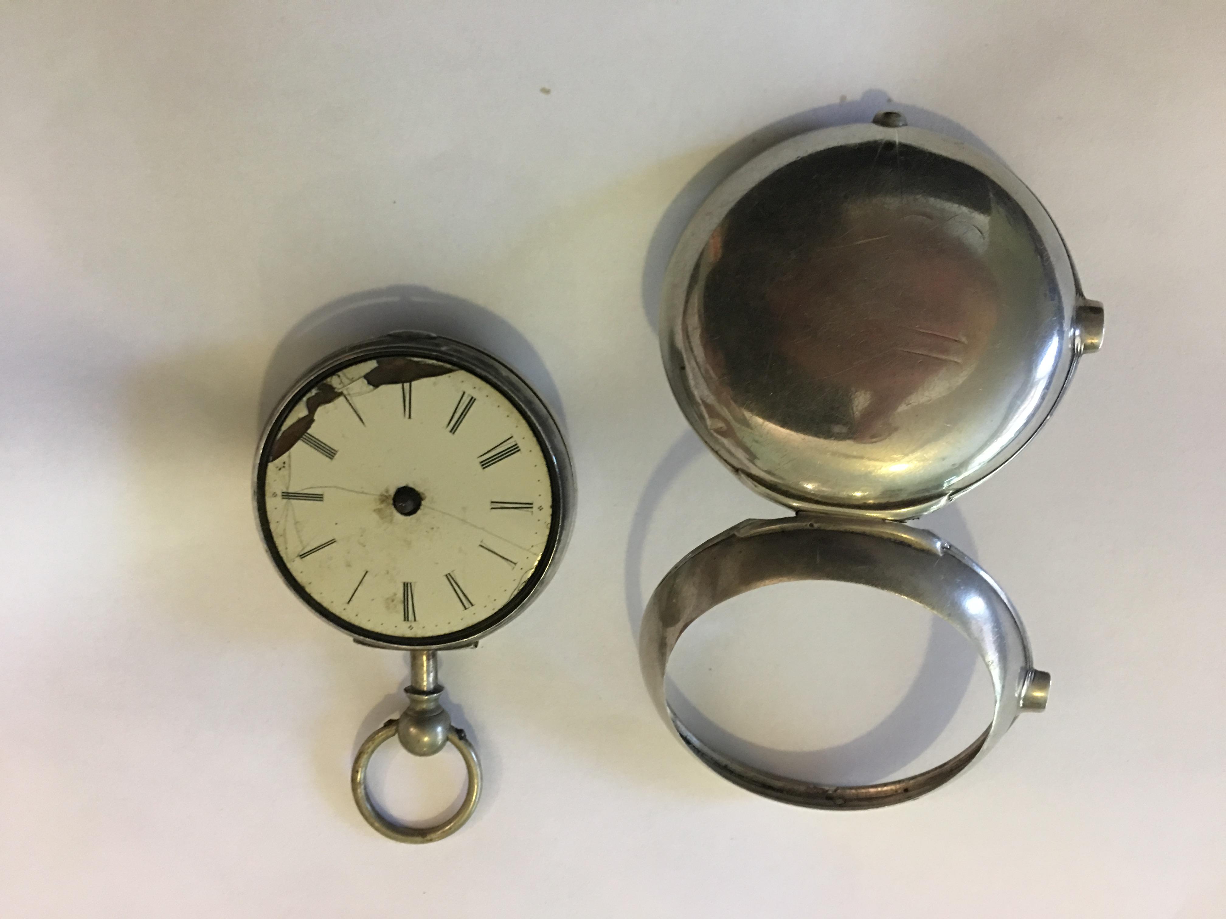

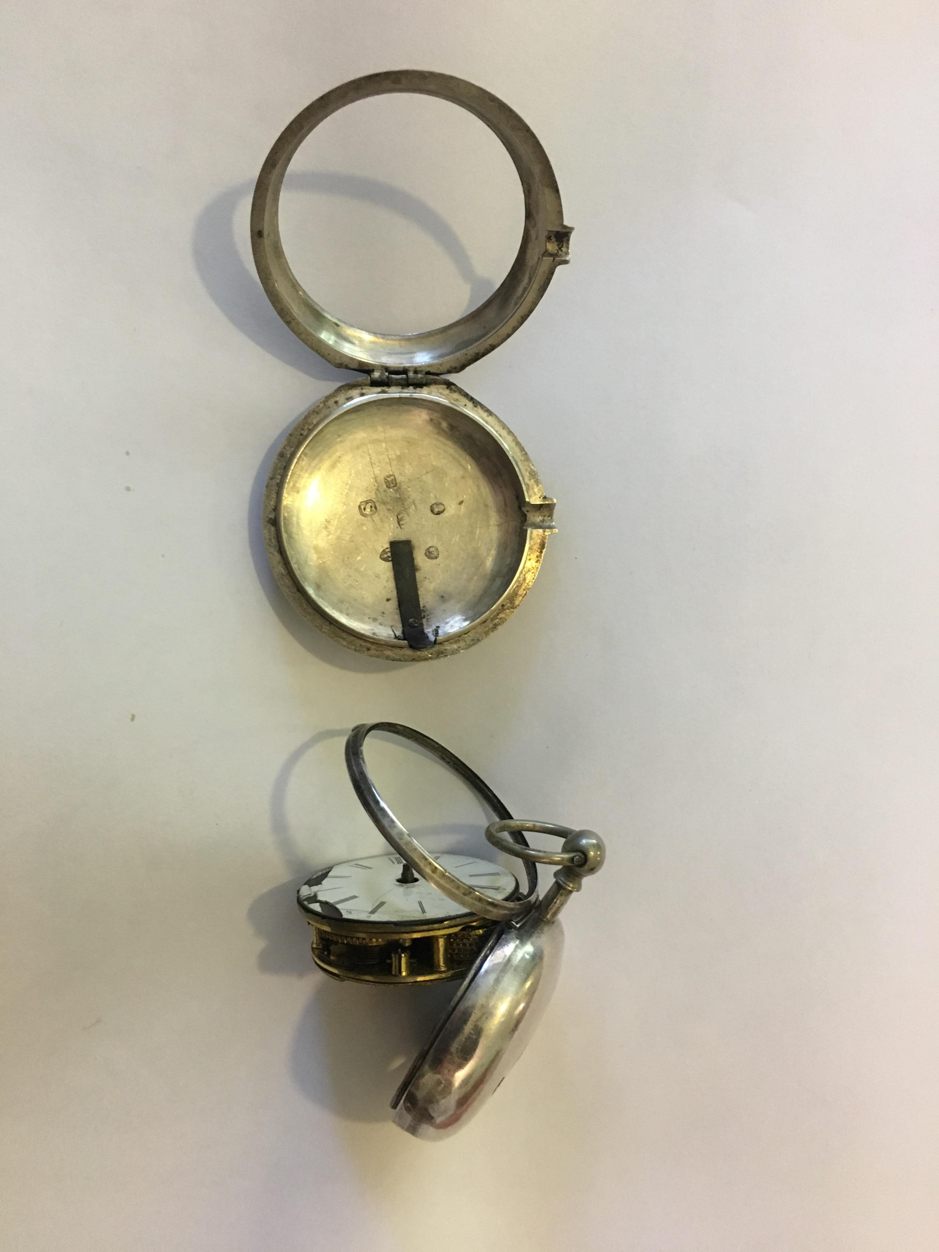

  24. Hi everyone, I have an old verge fusee watch for repair with separate outer case. The bottom pic and on the right is an early English lever, again chain drive and fusee. I have cleaned it and repaired the MS and made adjustment to what I still call the potence cock bearing to set the balance free with a touch of end shake. Need a HS and collet now and then we will see. The Verge will be the next job between customers. Why do I bother ???? Interesting ?? Pics herewith. Both gifted to me.
