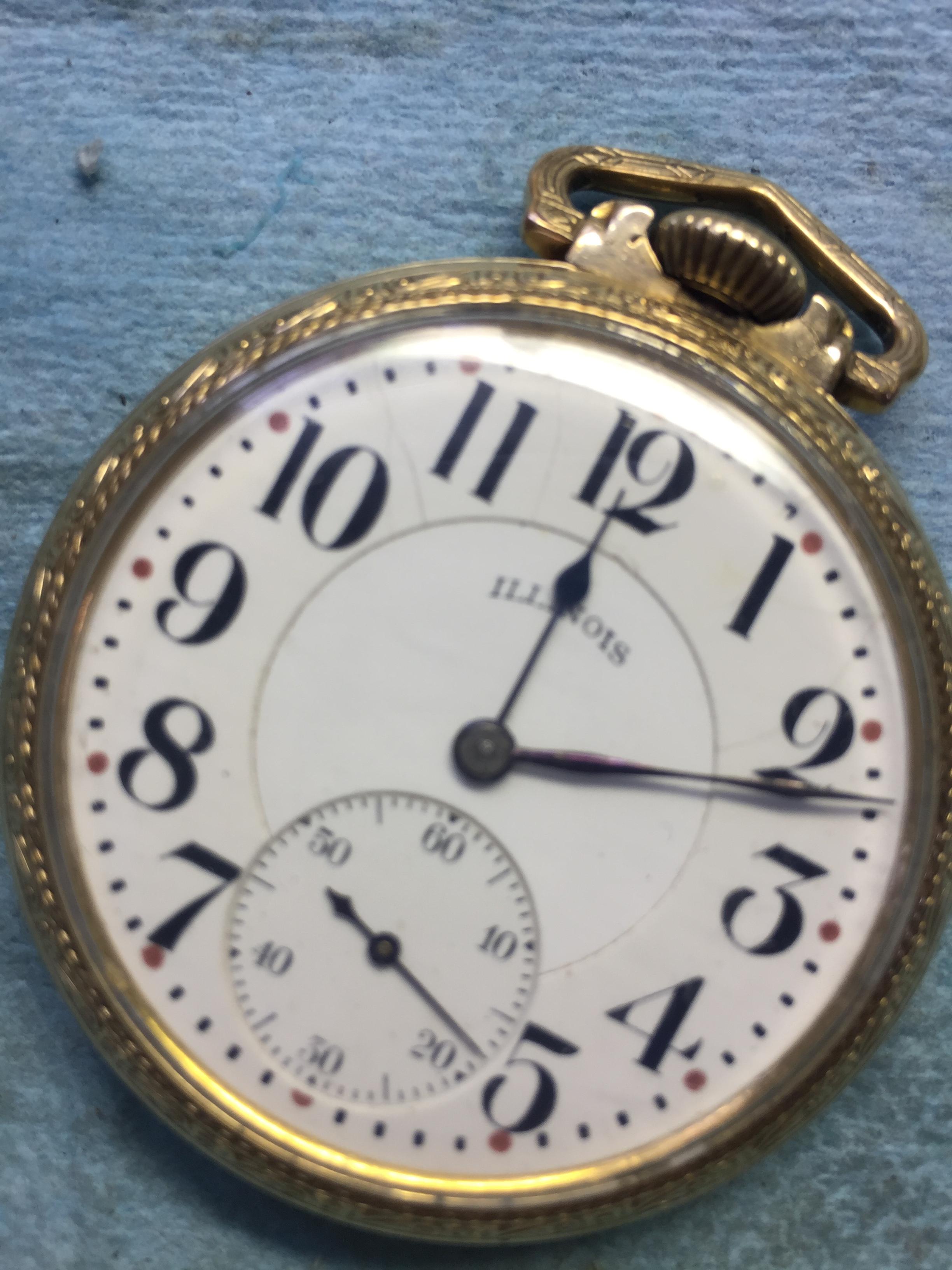

Once again I am asking for help.  I cleaned an Illinois pocket watch.  It was running well, but had a lot of lint and other debris inside.  I cleaned the balance wheel and hair spring without taking the hair spring off.  Cleaning was done in lighter fluid in an ultrasound machine.  The movement was cleaned in an ultrasound machine using watch cleaning fluid followed by two rinse soakes.  Everything went back together well.  When the balance cock and hair spring were placed the spring was not parallel to the plate.  None of my manipulation could make it so.  If the balance wheel is manually the escape wheel moves normally, but the watch will not run.  When not in the watch the hair spring is parallel to the balance wheel.
I have included pictures.  The one from the side was meant to show the h.s, but is hard to see.
Thanks in advance for your help.
I can see the hairspring is not correct. It is to near to the balance and could be rubbing (red arrow) You will need to free it from the regulator. if you need to adjust the hairspring, bend it down a little here (yellow arrow) it is a trial and error so be careful. You might need to drop the stud a little here (blue arrow) You need to have the hairspring level all the way round. See how un-even where the red arrow is pointing to the green arrow.

I am still trying to get the Illinois pocket watch to work.  Because the trouble centers around the balance wheel and hair spring, I have removed them and done a closer examination.  When out of the watch the hair spring is flat (all in one plane), but the plane of the hair spring is not parallel to the balance wheel.  I have included a couple of pictures.  If anyone has suggestions, they are welcome.
