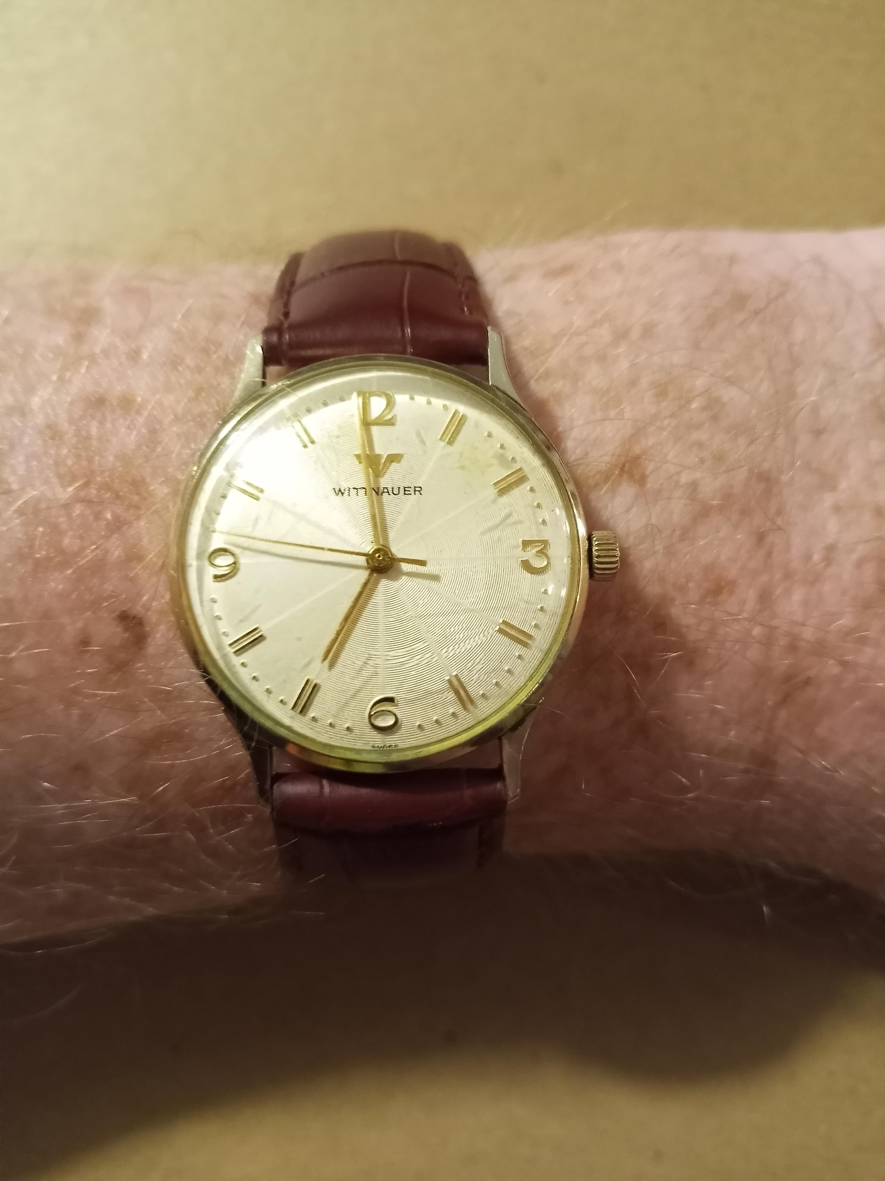

51 minutes ago, KarlvonKoln said:
I just snapped up this Wittnaur today, for all of $75 and change.  (A bit high for the 404 Club.) It was dirty and sluggish, but I had all of Sunday off, and cleaning watches keeps me out of trouble.  It came with no strap so I fitted it with an oxblood-colored leather one.  It runs smooth now.

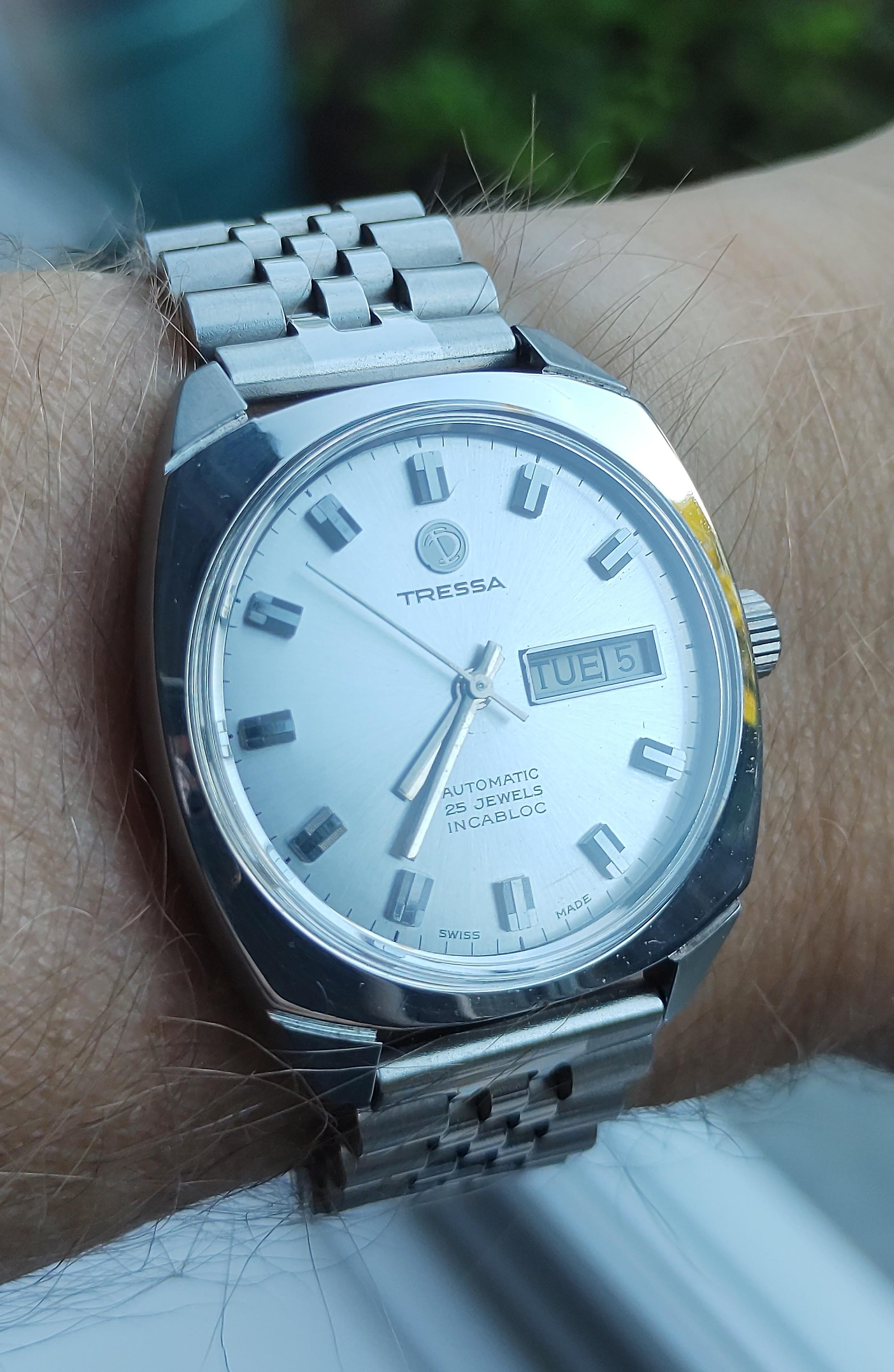

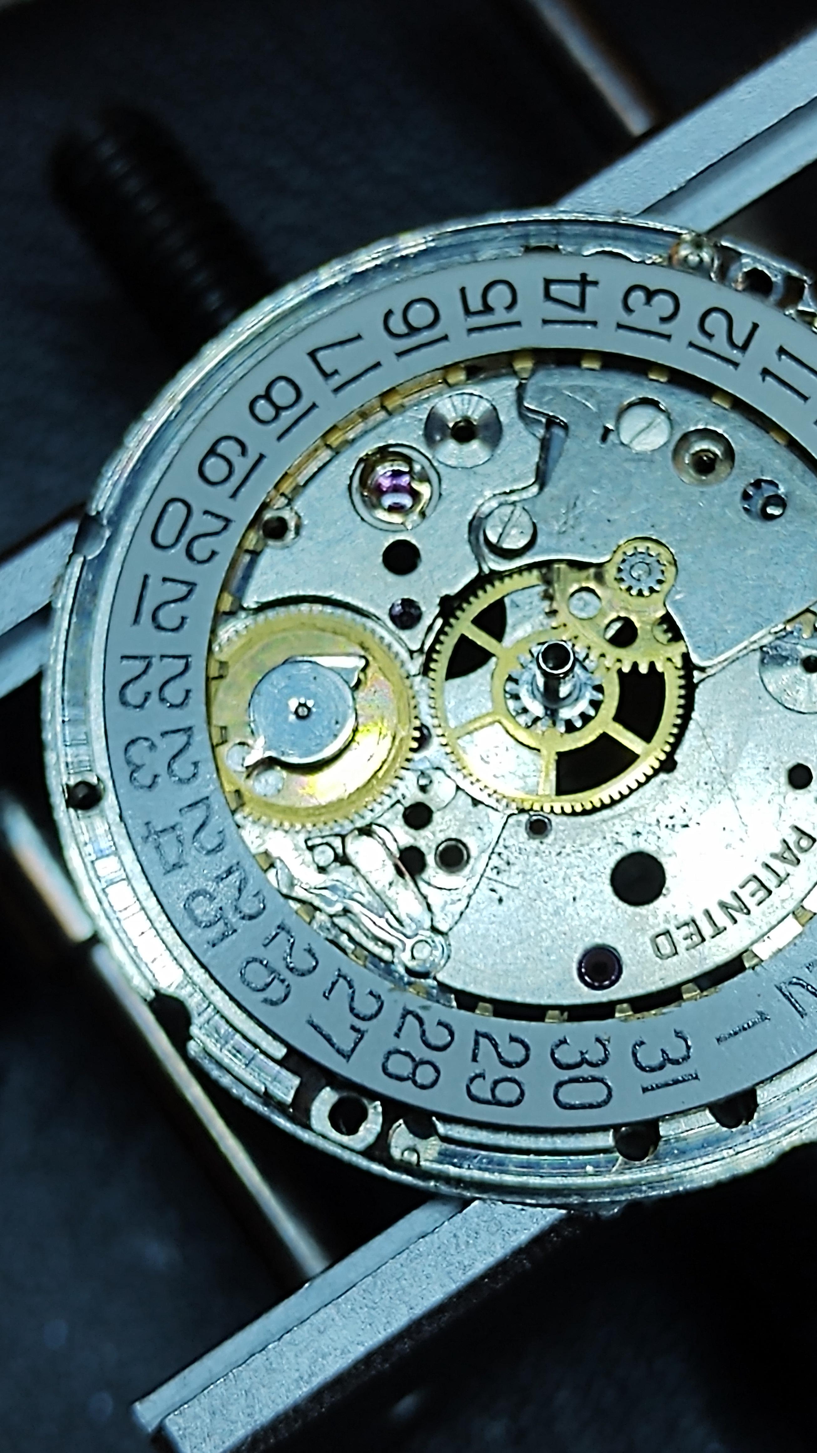

Tressa Automatic 1970s ETA 2788
Running at 0 to +0.5 SPD in wear.
Replaced crystal, crown (original crown worn and too small to wind effectively) and day wheel (plastic had gone very crumbly on the underside). Also badly chipped jewel on train wheel bridge (replaced entire bridge as easier than changing the jewel).
Very good movement running at over 300 degrees DU/DD. All positions 0 SPD except PR, PU +2 SPD.

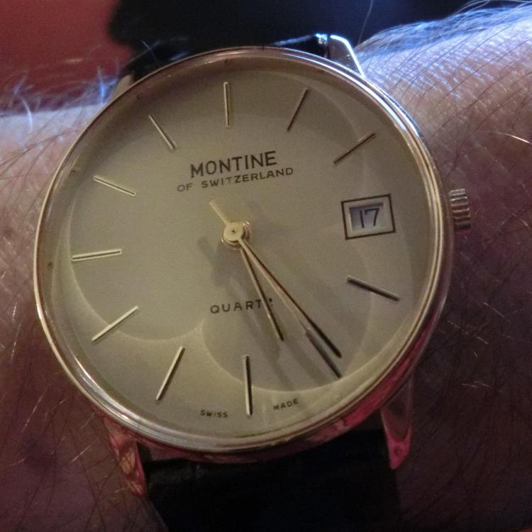

The two jewel ISA 1198 based " Montine of Switzerland" "Swiss Quartz" arrived, and It looks completely unworn.
However the original battery had destroyed the lower battery contact. Bizarrely it hadn't corroded, in a conventional manner, but rather it had split into a number of thin strips. I fabricated a replacement (from a 10K ohm resistor leg, flattened in the vice), and now it is running perfectly.
