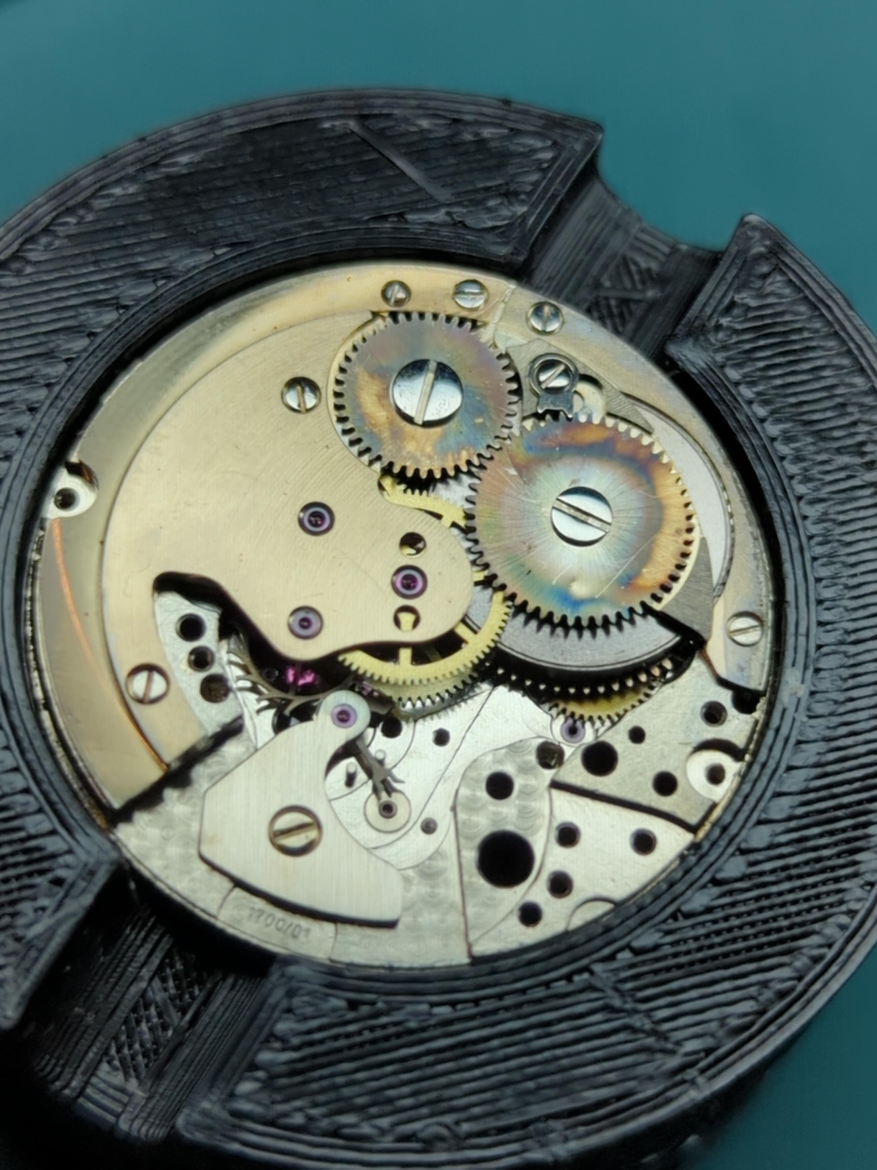

1 hour ago, Waggy said:
Not sure it was hard to make out, I think its printed just below the pallet cock below AS 1700/01 ??
Looks like it. Automatic according to Ranftt and you can match the pictures to confirm.

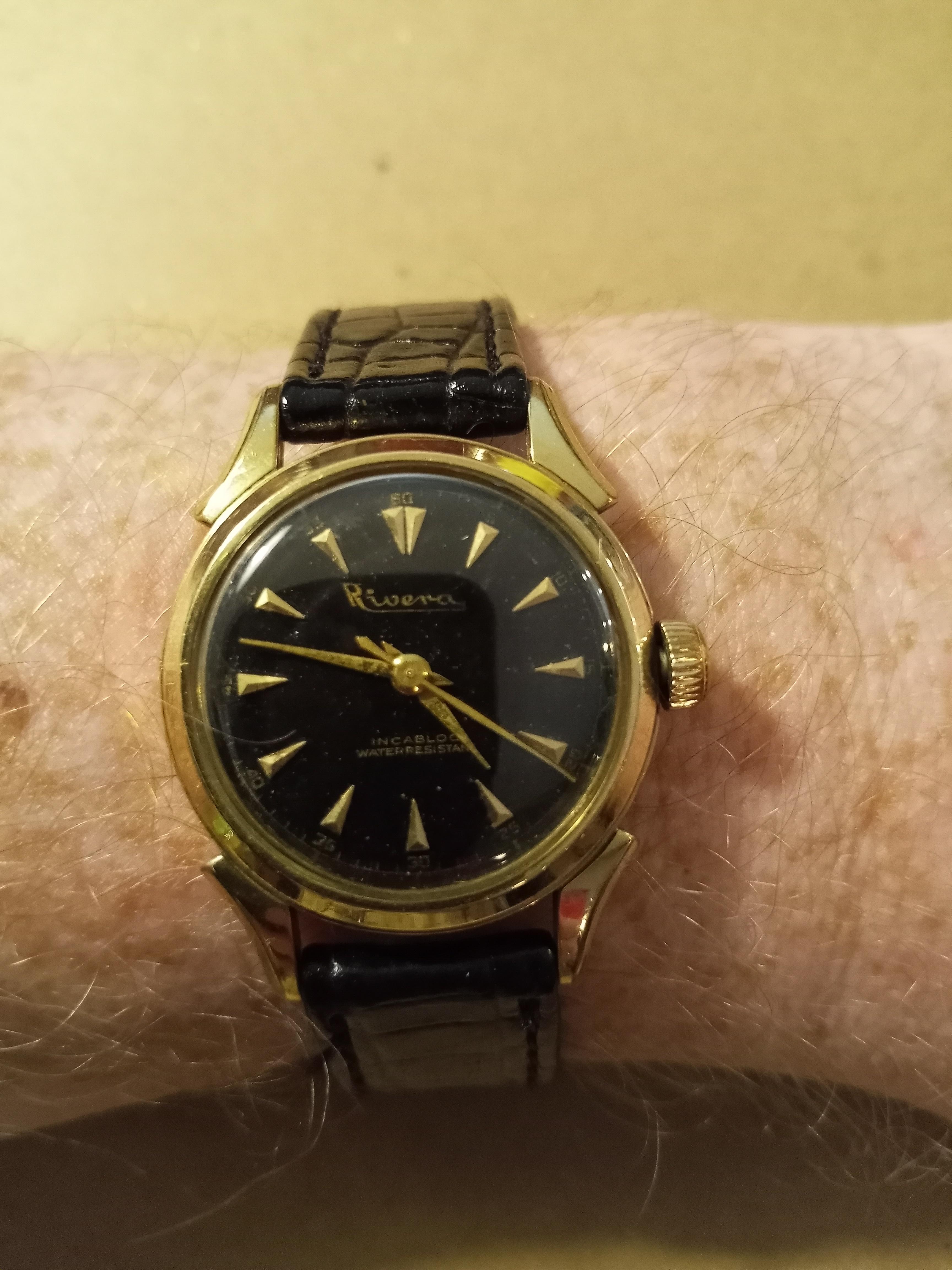

I cannot recall if I have posted this one before: I was in the mood to wear black today.  And I've always liked the color combination of black and gold with a black dial.  This is an uncommon one these days; an Avalon "Rivera", from sometime in the 1960s, with the usual 17 jewels, incabloc, & water *resistant*.  I do not remember off the top of my head which Swiss ébauche is in here, but it is Swiss and looked pretty sweet.  Fairly accurate as well.  And makes for decent eye-candy also.

That watch (which I am pretty sure I have, plus a couple of other Avalons) is awesome; cool lugs. I collect 60s non-brands, intentionally - at first they just were sort of leftovers in lots bought at auction. But I know so little about them, I can rarely find them in searches anywhere.
I also notice you like pocket watches, as do I. Most of my watches are pocket watches. I collect only American ones, and those are of course very easy to ID. I am getting a drawer-full of Swiss ones just collaterally and I don't know how to figure them out.
Advice for me? Thank you.
