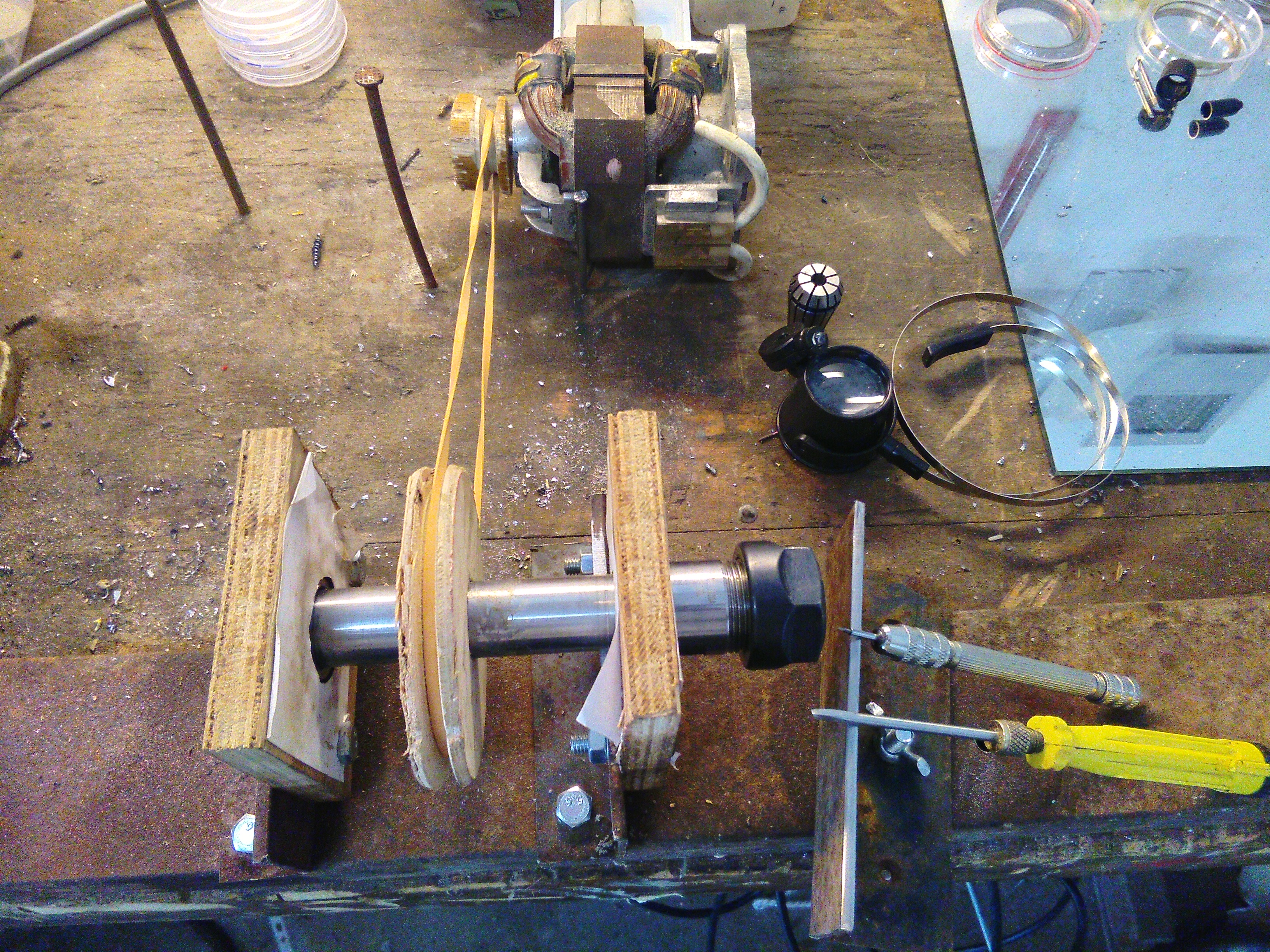

I was drilling and grinding all day long and my Frankenstein lathe is born :)
Now i can mount the barrel arbor for turning:
First i will try to turn out the remaining screw with my graver. If it wont work i can make a center hole for drilling. Or sgould i make a 0.2mm cut in the arbor head and with that in the screw and try to screw it out? What method would You choose?
Managed to drill through the screw with a 0.8mm microdrill. Surprisingly, it had only 1-1.5mm long broken piece and many empty threads under it.
Now, how can i get the remains of the screw out from the first 3-4 threads?

I did it just like that :) Unfortunately it didnt came out. Finally one size bigger microdrill (0.9mm) did the job. However, the first 3-4 threads are now about half hight. Bu who cares, there are a lot more under it, i just need a longer crew.
