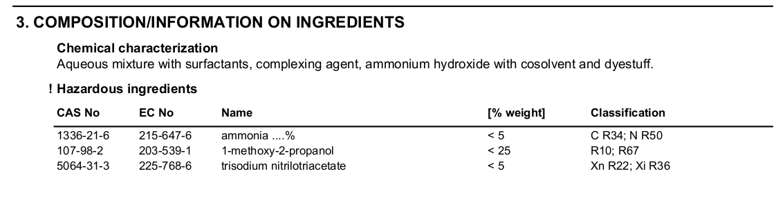

I am getting to this point of trying to make my own here as right now all the ammonia based cleaning products are on back order. No Elma Red anywhere at all. There is an aussie local made ammonia based but having stock issues too and not sure how good it is.
@Paul80Weird the MSDS is different to the Elma Red one I just looked at regarding formula. The product is the same for overseas markets and not a different formula perhaps? This MSDS is for the Aussie market.
