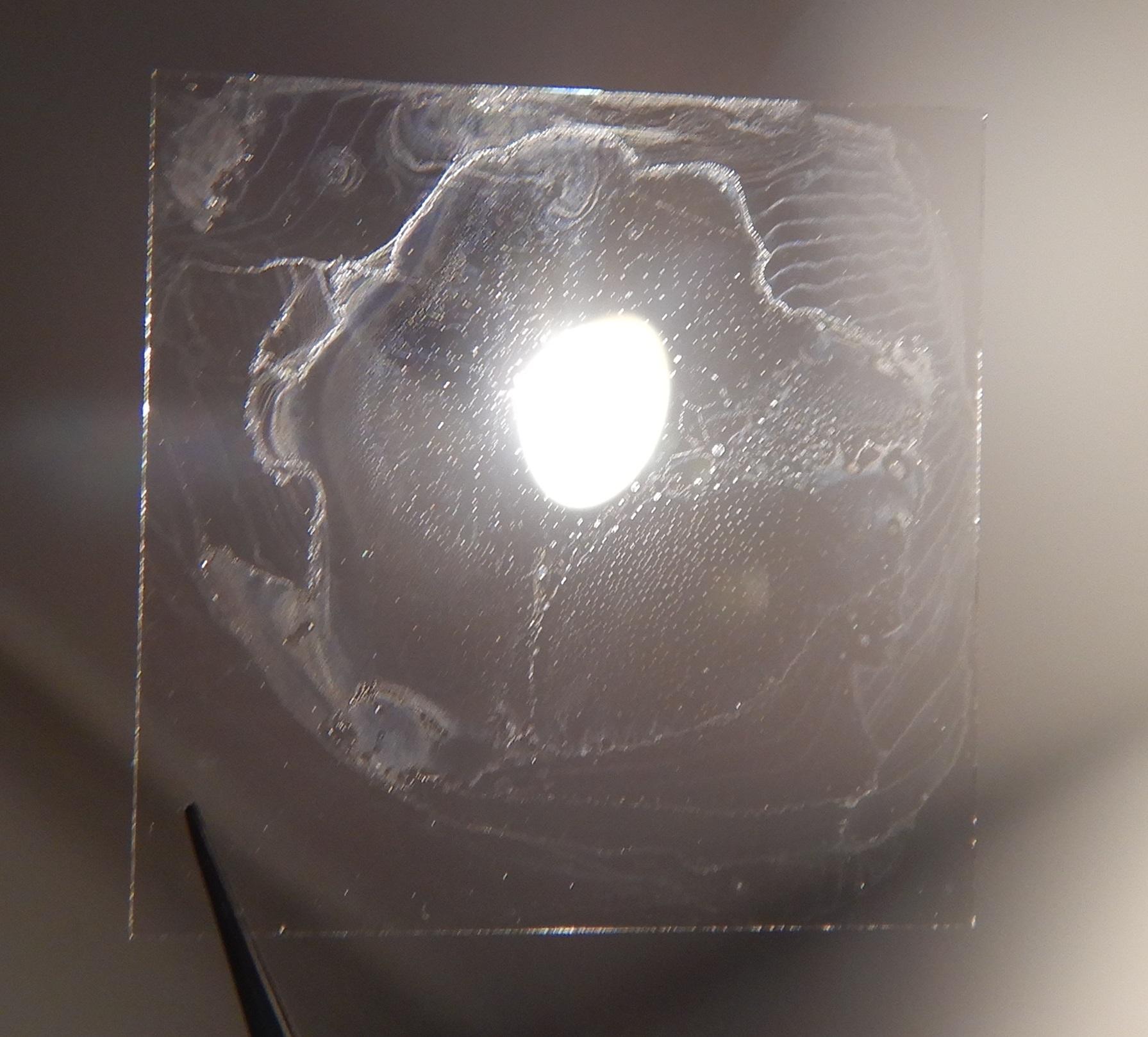

Hi,
I find this test and conclusions a bit strange...
The residue seen on the glass is what’s left after the solvent has evaporated i.e. It’s an indication of the level of impurities in the solvent, not a property of the solvent in itself (that’s not there anymore)
As such this test can be used to determine if your solvent (benzine, alcohol, acethone ...) is as clean as you want it to be.
But to determine if your solvent as such is good or bad, I see no guidance here.

It's a very useful test for final stage rinsing. A popular cheap way to clean is to use lighter fluid and then rinse with %99 IPA to get rid of the film that it usually leaves behind.
So you use the test (solvent on glass sheet) to ensure the IPA is clean (= no residue ) whereas you don’t expect that from the lighter fluid that is primarily intended for burning and can be contaminated ?
That makes a lot of sense to me and I will try that next time with the benzine I use for cleaning and rinsing.
