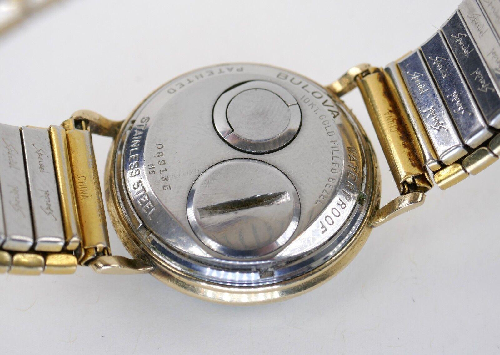

Another Accutron 214 found its way into my shopping cart. Not sure how that keeps happening...😇
I've always liked the railroad dials, and I'm a sucker for the blued hands.
This one was sold as running, for a nice change of pace.

You've been bitten by the Accutron bug!

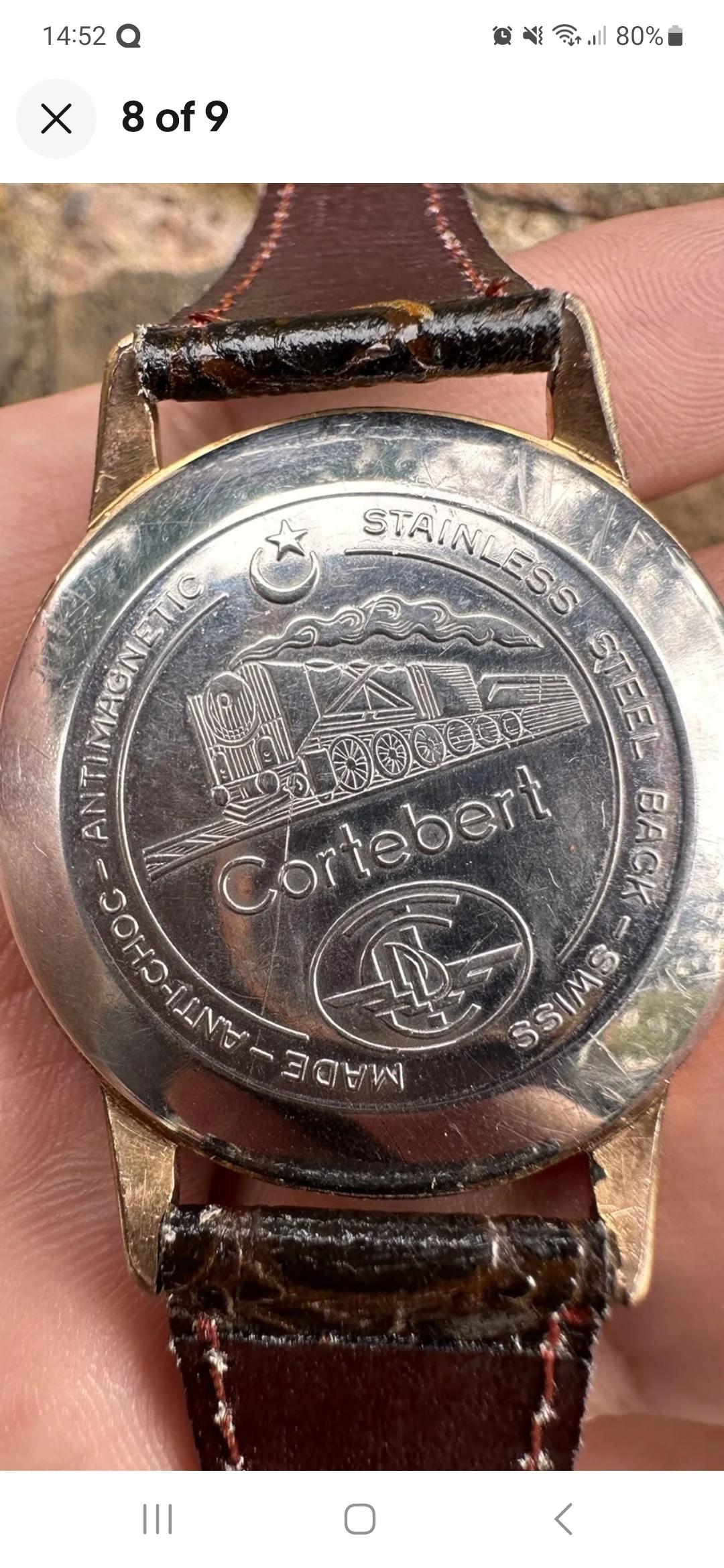

9 minutes ago, Neverenoughwatches said:
Nice, I've been looking at these since i bought a Cortebert. It has a nice big dial like yours .
The printing has worn off but the dial should clean up nicely.  £60, I didn't expect to win. Any guesses on the movement?
It's here, and not only does it look great, but it's running out of the box! It's such a weird experience after all the busted watches I've been buying 🙂
Seriously, I'm such a sucker for the blued hands.
4 minutes ago, JohnR725 said:
As it's running out of the box can I assume that you're not going to service it?
Let's not get ahead of ourselves here. I'm not one to leave well enough alone.
That said, if it looks nice inside and keeps good time, it'll go down on the list and I'll just enjoy wearing it for a while.
May I make a suggestion? Why don't you just enjoy your watch and not worry about servicing it. Then if you lose your mind to decide the service make sure you invite me to the discussion as there's something you don't have.
Interesting timing for this somewhere else in the group I'm still composing a response that part of it has to do with updates to documentation which never find themselves down to the original documentation. Or basically technical documentation is generated at the time the watch came into existence. Technical documentation does not cover all of the variations changes updates etc. although that documentation may exist it doesn't necessarily find its way back to the original documentation.
For instance as this is a railroad grade watch did you notice when you're setting the watch it has a hacking feature? Typically in the railroad grade watch 214 version the hack is they are so that you can set the watch to the exact second. As this watch I believe would've been a railroad grade certified and hacking would be a must.
I did know that RR grade watches generally hack, but the seconds hand continues to sweep while setting on this watch. Come to think of it, I did notice the second hand jumps a bit when you start to set it, so maybe it's trying to hack but something is missing/out of alignment/broken.
I just opened it to check, and it is the correct 214H hacking movement, and has the same M5 date as the case, so I'm guessing it's right.
Also interesting that the movement plates are silver (steel?) and not the brass color of the other movements I have. I'll have to do some more reading on the history.
There was a lot of organic matter, so at the very least I'll be de-casing the movement and cleaning the case.
Anyway, I don't want to hijack this thread, so once I get things apart and cleaned up I'll start my own.
Yes I'm trying not the hijacked the discussion we can look at pretty watches technical can be somewhere else
the date codes as far as the case goes isn't always clear because sometimes I think the factory used whatever cases they had versus movements but yes if they're the same that is a good indication versus dramatic differences.
As far as the colors the plates go I've seen both of them I don't know why they change the colors.
Probably not broken and no you can't see the hack it's on the other side.
Tactical I'll give you is remember the case back as the crown and if there's a lot of dirt and grime under their it's spacing conceivably could change a little bit but the biggest changes spacing would be those back gaskets the original ones that we can't get anymore. So for the hack to work the back gaskets and exact location of the stem is extremely critical. Did I mention pain in the? Yes it's a pain the setup and delete something that you don't have any way so I wouldn't worry about it.

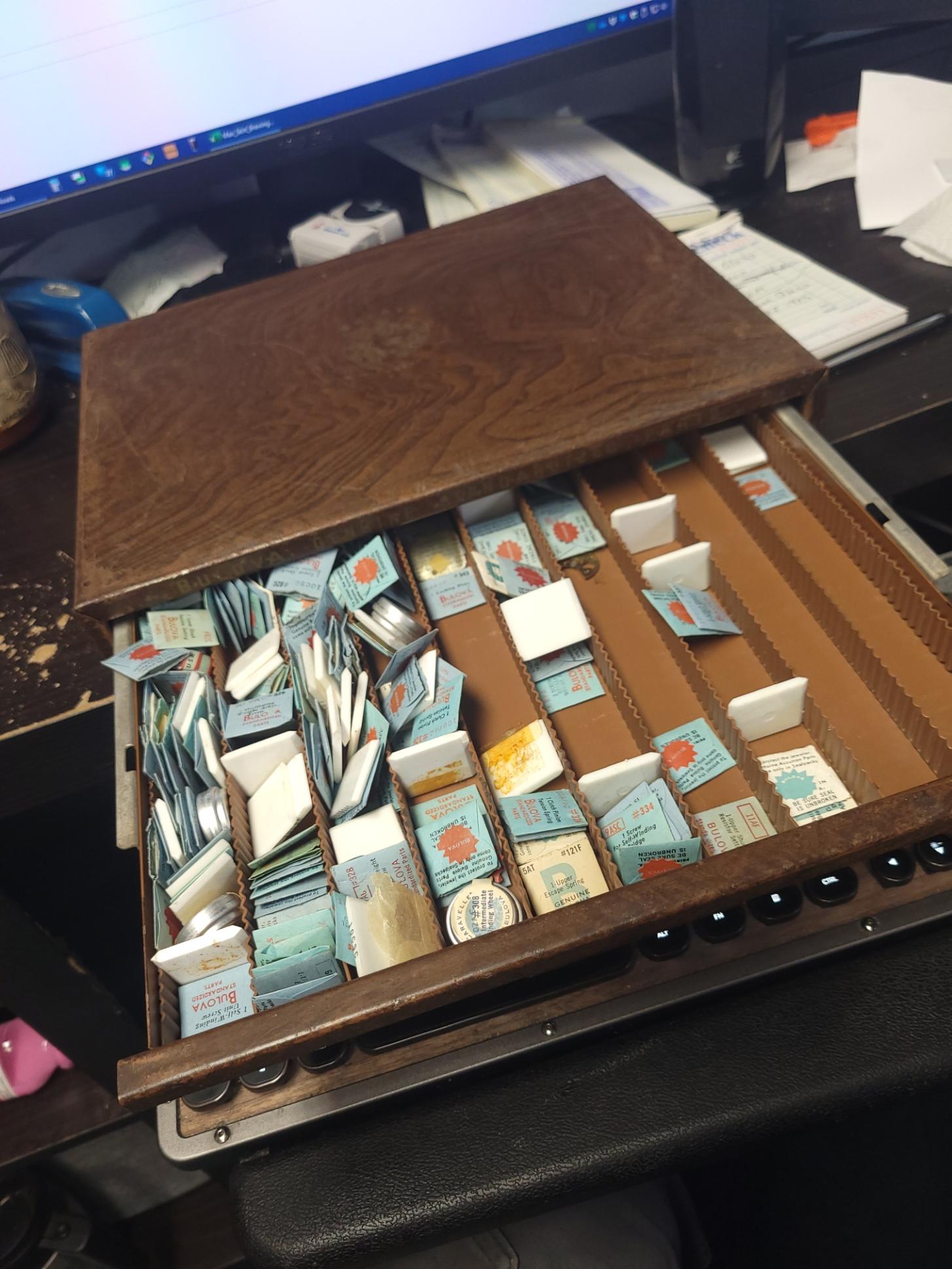

Not a watch, but still pretty exciting. I've been looking for small parts and tools storage solutions, and I found these nifty Bulova "Repair Master" stacking drawers on eBay. I got two of the two-drawer units, and one that's full of parts! The single drawer just showed up and the other two should be next week.
They're a little small to hold larger movements, but will be great for my drawer o' random tools and small parts. I have a bunch of tiny zip-top bags on order for corralling small parts.
