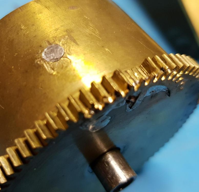

On a separate note, I thought you might enjoy this (In a macabre sort of way). Apparently serviced and repaired a while ago but the clock, a wall mounted Junghans, stopped soon after. They then moved and have since given it to me to look at......my first thought was "yikes"! The whole thing needs bushing, there are worn pivots and generally the poor old thing needs a lot of love and attention but I'm not too sure what to do here. I may just use it as a training exercise to practice teeth repair.

What a bloody mess. I don’t think I have ever seen such a disgusting poor bodge up as this. Whoever did that they should be ashamed of themselves? I hope they don’t think they are clock repairers.
With all the hammer marks looks like the part that the mainspring hooks on was at some time loose.
I thought you would like it lol. This is the Chiming barrel. The going Barrel has also had repairs - but of a better quality - like the ones to the left of the picture of the bodge.
