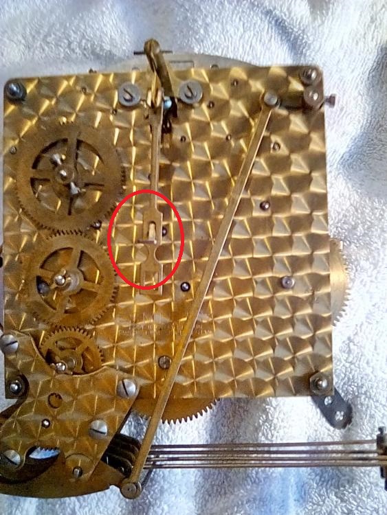

I wonder if I may ask your advice vice on something which is probably a very simple answer but has left me scratching my head in disbelief!
I have attached a file for information which shows the Smith’s Westminster chime clock after I have cleaned & serviced etc.
The clock was brought to me in an awful condition. It belongs to an old lady who had it off her mother. She said it hadn’t worked for years and she hadn’t even got the key, but it would be nice to hear it ticking again now she had retrieved it from her shed.
The clock was understandably awful. It was as black as can be and full of years of grime dust and gunk. I very much enjoyed cleaning and serving it and was pleased to say that all of the parts are intact. Even the key was there - it was jammed between the front of the case and the movement!
However, I have had it running on my bench now for about 3 weeks (allowing time for setting down etc), but the clock runs and chimes excellently but will not slow down. The Bob is extended so it is hanging on by barely a thread and yet it still gains about five mins a day???
I would be grateful of any advice you may have?
Kind regards
Nick
Looks like the wrong suspension spring. As you can see I have pointed it out. The crutch part should be about half way in that slot and not at the very bottom. Looking at the photo it is causing the s/spring to buckle, it should be straight. The clock cannot be regulated properly with the s/spring like that.

Hi oldhippy.
your genius appears to have worked once again. I have made the necessary adjustments and all seems well so far, clearly I’ll need a couple of days for certainty but I’m confident and eternally grateful to you. It was one of those things where I couldn’t see the wood for the trees!

Hi
I apologise for the delayed reply - I’m not used to talking on a forum.
However - I’m certain you will have guessed by now, but your advice was spot on and the clock is now running beautifully - when I returned it to the 87 year old owner, she cried and told me that it was a present for her 21st Birthday !
