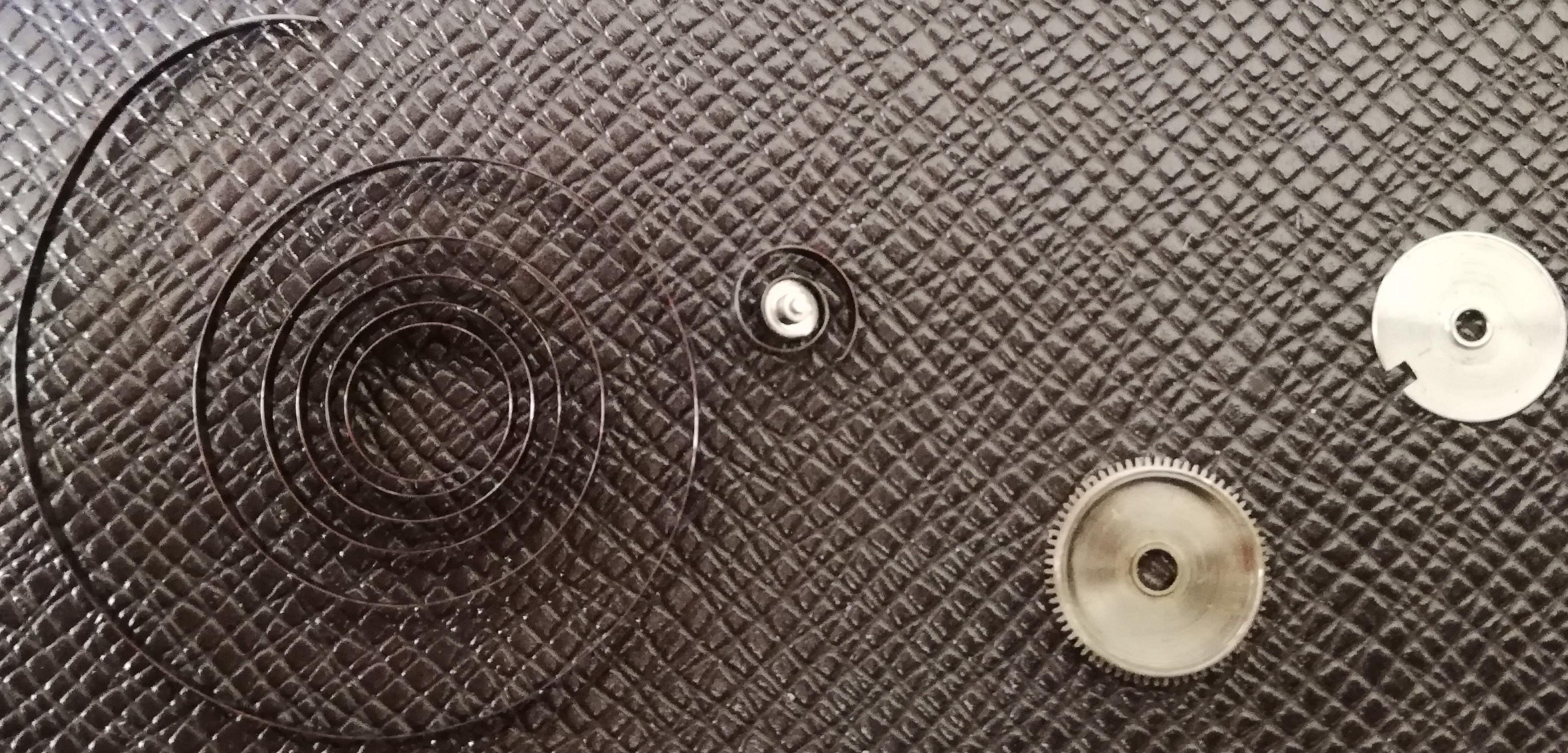

Well I'm back in the game. The screwdriver set has arrived and I've been able to get the movement out of the case.
The markings show it to be an MST400 - is there an easy to find repository to grab the datasheet from? I'm going to be taking plenty of pictures as I go along but every last scrap of information will help!
This evening will consist of trying to work out how to get to the mainspring to take a look and commandeering the wife's ultrasonic jewellery cleaner to give the parts a good scrub.
Well, I've managed to take the watch back to its component parts and there's two things which need fixing. As expected, the mainspring was snapped in two and the top of the screw holding the crown wheel was sheared off leaving the thread of the screw firmly lodged in the barrel bridge.
I've done some research and it looks like alum powder and patience is the best way to get the screw out of the bridge - I'm open to any other suggestions which may provide better results.

5 minutes ago, Kuppatea said:
.I've done some research and it looks like alum powder and patience is the best way to get the screw out of the bridge
You should try going at it with a small screwdriver first, as it normally happens it was sheared by someone using force counterclockwise. It can be quite lose in the post.
Mainsprings can be bought on Cousins UK, and the crystal looks like it can be perfectly polished.
I put some penterating oil on the broken screw , let soak over night and go at it with a needle or screwdriver, if it doesn't want to come out to a point the bridge is getting scratched then I try alum, apply alum only to what you want disolved.
While gears are easily accessible form both sides of the gears bridge , I check end and side shake on all gears and the fork.
