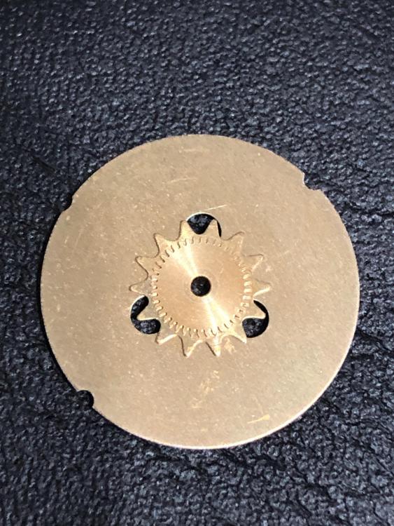

Hi all,
I managed to get my hands on a vintage 1972 Tissot Seastar Automatic with a 794 movement. It's given me a few challenges along the way with the calendar mechanism and no technical sheet to refer to but I seem to have overcome everything until the last part of the assembly. The date wheel is advancing fine now, as does the day disc when light pressure is given with pegwood when I rotate the crown. However, my question is, what holds the day disc centralised and in place? I've worked on an ETA 2836-2 date/day mechanism, and on this, a circlip held the day wheel on. The design suggests with this one that the dial alone will provide enough pressure to hold it in place though I'm not convinced. I've invested in a new date ring and day disc due to the originals being badly damaged.
Has anyone worked on one of these old Tissot movements before who could kindly offer some advice on fixing the day disc please? Photos of the job added.
Yes that is very common with Swiss mov.ts, a thin brass washer goes between the hours wheel and dial, otherwise the day disc takes its place.
Thanks JDM. So essentially I’ll fit a dial washer before fitting the dial.
Do you have the dial support ring.
Yes, I have the plastic dial support ring and (I think - see photo before disassembly)2c5f36697ee2cdc5e8632c0441fc813c.jpg&key=92754e33815abce315385fd210a14cf699700a430830210a653059b2b60128b8everything else , thanks Nucejoe. Unfortunately no dial feet so am fitting dial sticky pads https://www.cousinsuk.com/product/dial-spots-strips secure as recommended by someone. Then just the auto rotor to fit and hopefully I’m done.
Dial ring looks good.
Don't pads raise the dial plate higher?
That’s my fear now. The pads are 0.4mm thick so I won’t know till I try
Pads are always an agly hack, I try would find someone to resolder the feet.
I agree jdm. I do have a soldering iron for electronics but fearful of damaging the dial. Looked on eBay without luck for a flat one with diameter 29.5mm without success :(

It's a valid fear. Watchweasol has the plans for a machine, maybe he will post the details. You can try a dial washer too.
You could use JDweld to glue some dialfeet on. I guess Cousins has these, I bought mine at Boley.
Do you mean J-B Weld epoxy? If so, I can obtain it from Amazon. Sounds feasible.
Its quite difficult to glue feet back on but heres a tip.
I usually do it first  before assembling. What I do is fit the feet back in a bare movement so that they stick out a bit equally, then dress the tips so that they are flat, Next Apply some JB weld to the dial where you want the feet to go .. sighting thru the hole in the middle of the dial to ensure you get it really centred. Use blobs of rodico on the edges to ensure the dial stays level. If you like you can reattach the centre wheels, canon pinion/minute wheel to ensure that the dial is really centred. Leave it overnight or longer and then remove dial from movement .
Good luck
Anilv
