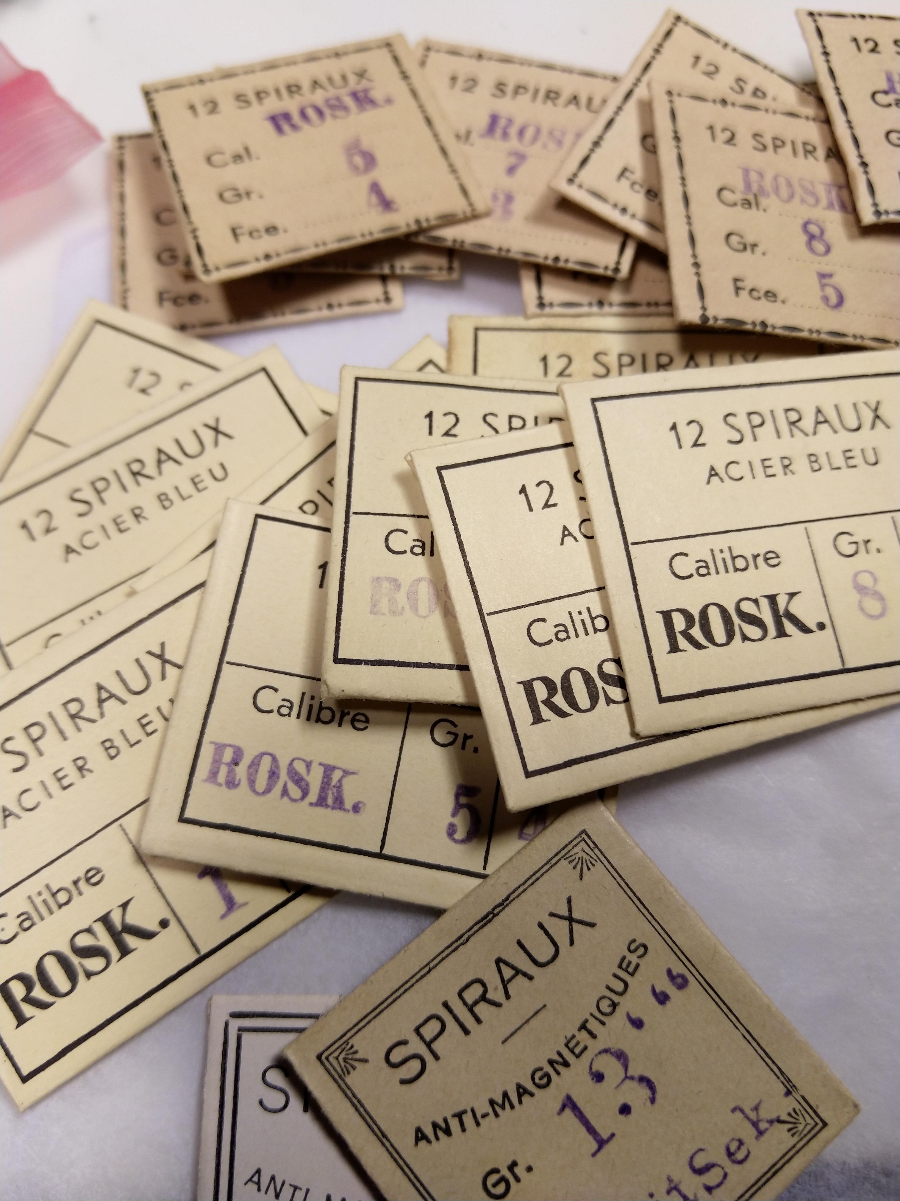

On the packages of the vintage springs there often are the markings Gr and Fce learning what they stand for would help people like me with less knowledge to choose the correct spring to vibrate faster. Was there any standardized system for this type of marking?
@HSL  are these colleted?   I read some producers graded their products in like 4 or 6 classes by strength, like Gr4  stronger than Gr3.  One just chose the right class and had to collet, vibrate, curve the end, stud.
A bigger headache are uncolleted hairsprings, an extra unknown.
