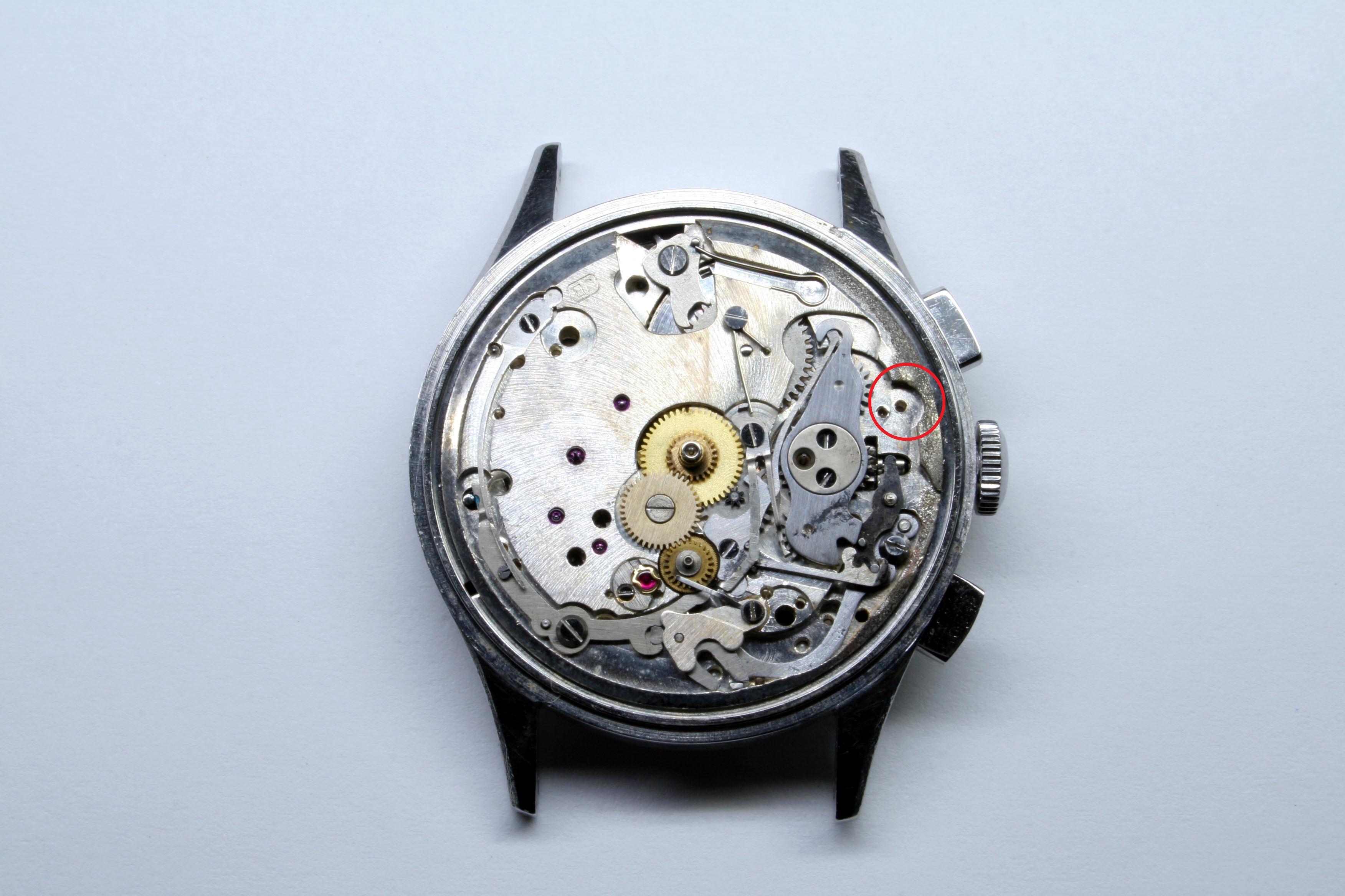

Well, I've pretty much wrapped up this project.  The replacement chronograph pushers (buttons) arrived last week and needed a bit of adjustment before they could be installed. As  you can see from the picture below, the shaft of the pusher which acts on the Flyback Lever was a bit long and needed to be turned down on the lathe then re-threaded.
The lot of Excelsior Park parts which I purchased earlier included replacement coil springs for the pushers which was just perfect as the spring for the Flyback Lever was quite rusty.  The replacement is pictured below.
I found it was easiest to case the movement first, then install the pushers. While doing this I noticed there was a part missing from the keyless works. Worried that I had lost something irreplaceable, I went back over my images taken during disassembly and discovered the missing bit wasn't there when I started. The missing piece belongs to the setting  lever assembly- although what exactly it's purpose is I'm not sure. Perhaps it provides stability when applying the clutch.  I noted the keyless works seems to function properly without the part so maybe it's just the appendix of an EP40 movement.
I've circled the area with the missing bit below and added a linked image from the  Watchguy's image archive which shows exactly what is missing.  If I ever do find the missing part, I'll probably have to give my right arm to purchase it.
