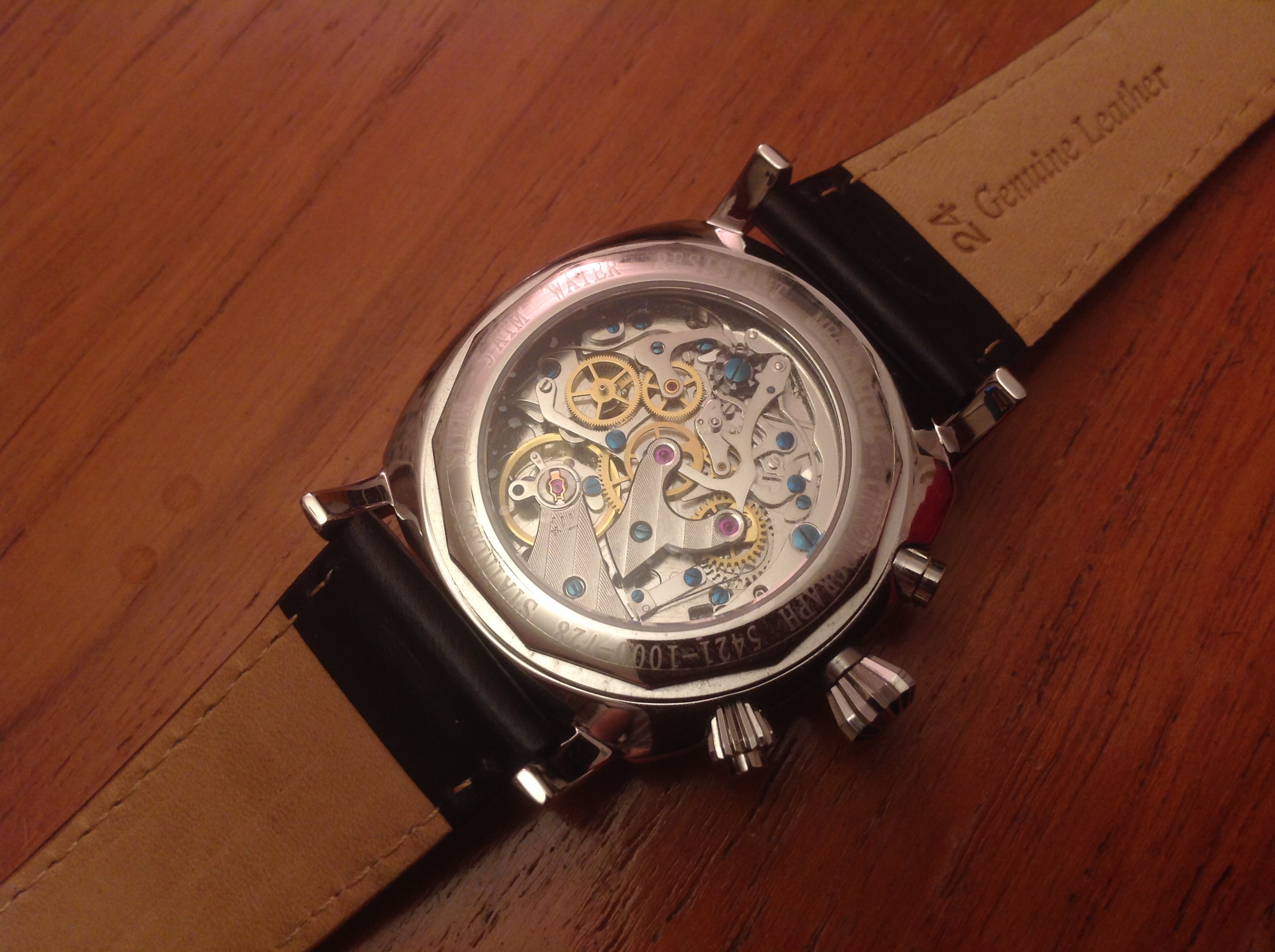

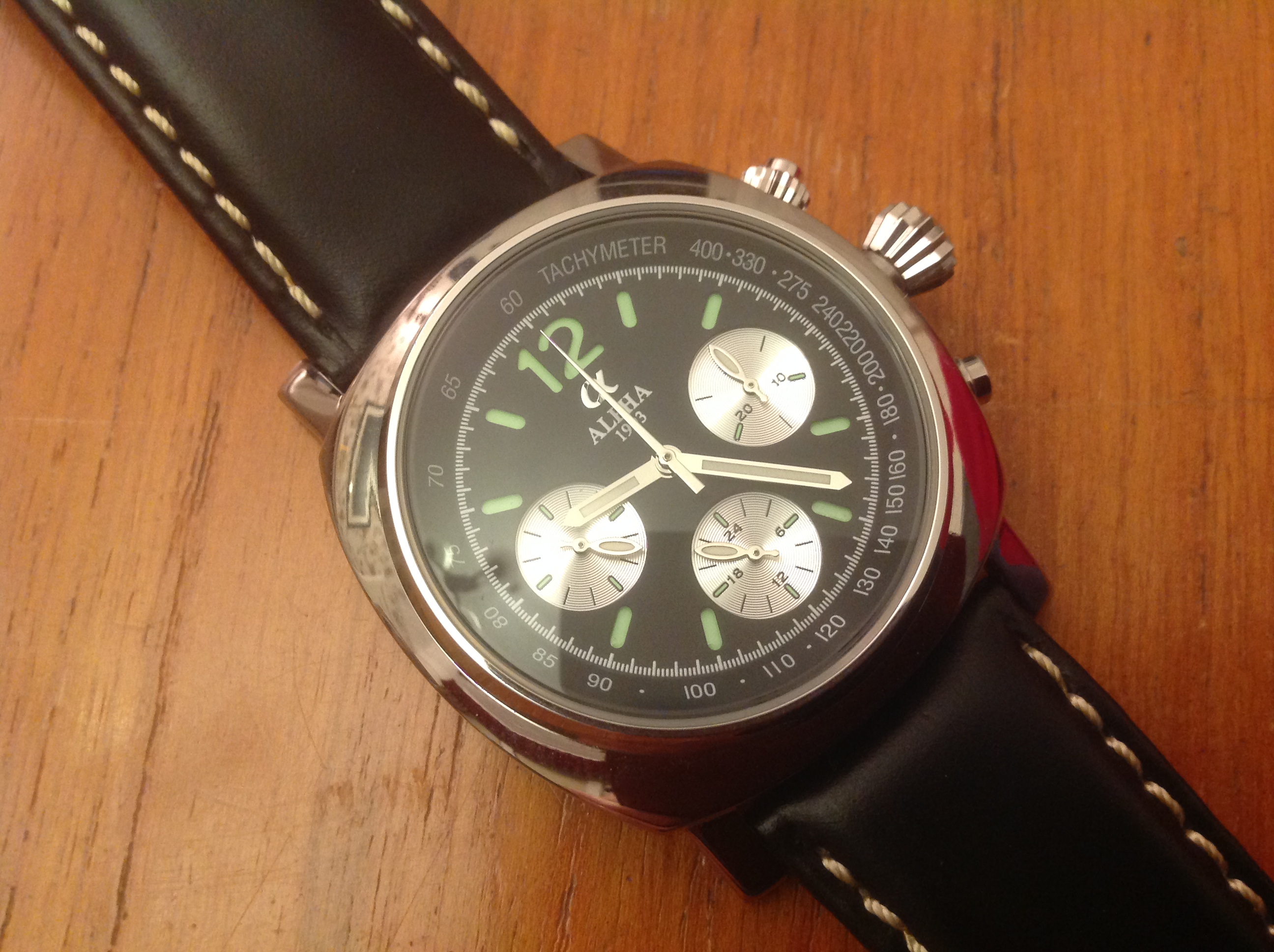

  1. It's an Alpha. Made as a homage to Panerai Radiomir Chronograph, but not labelled or dialled the same to keep it from being a fake copy.
    1 point

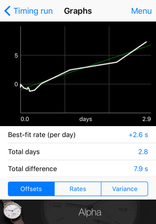

  2. I recently acquired a Chinese chronograph wristwatch with a Seagull TY 2903 movement. The finish on the movement is excellent it is keeping 2 - 3 seconds a day. The complete watch new was £129, a Swiss watch with the same specification would cost many thousands of pound. Do I like it..........no.........I love it! Here is a photo of the graph with daily rate.
    1 point
