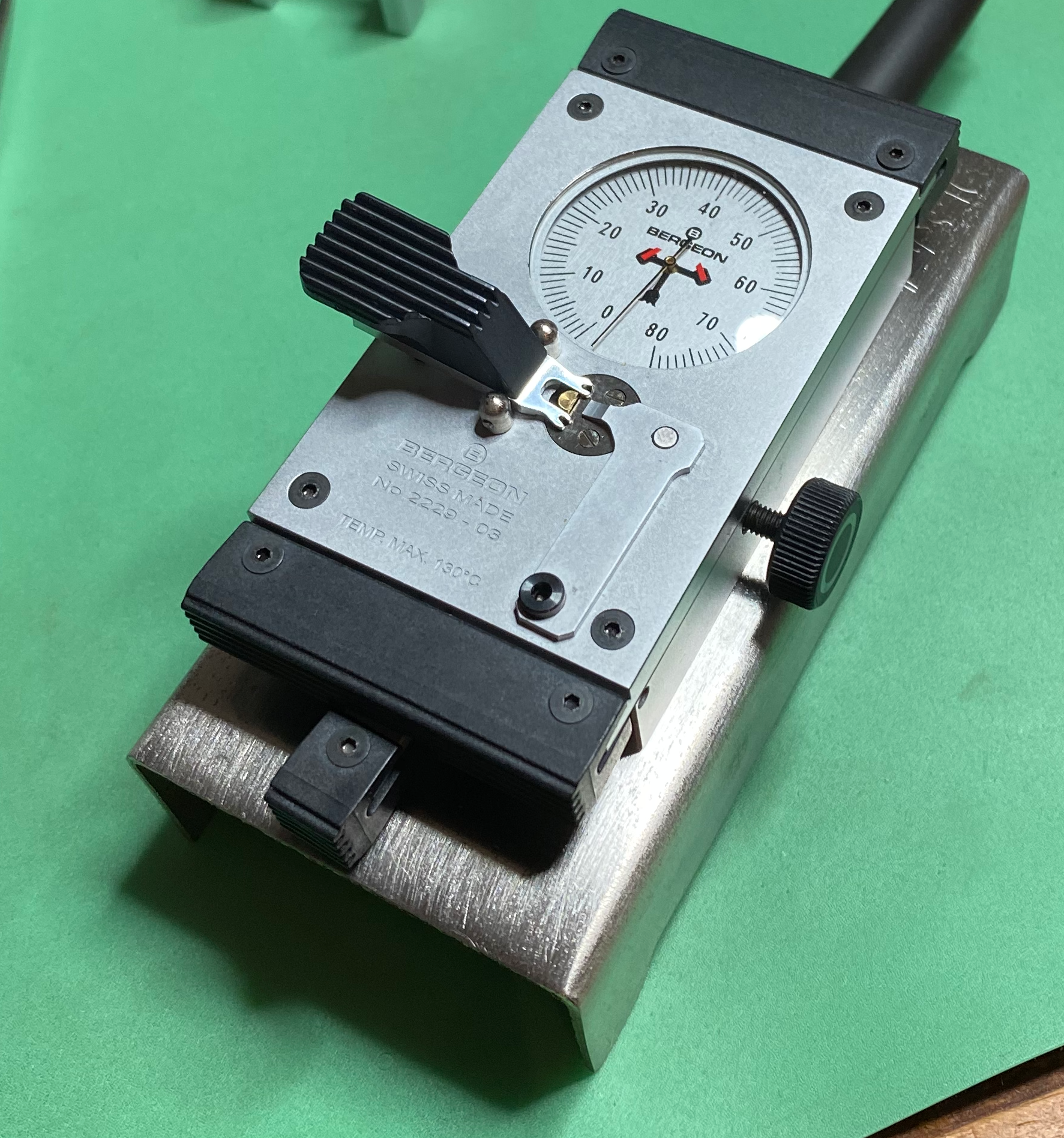

This arrived today. £500 on eBay which seems reasonable. I expect the buyer has upgraded to the new model. This is really going to help me with vintage watches. Such a beautifully made thing. It’a insane that you heat up the entire tool to 130 degrees. And yet it remains accurate. Clever those Swiss.

What does this thing do

Excuse the sideways picture before. It's called an escapement tester. But I'm not really sure why. It should be called a pallet stone adjuster. You can use it to very precisely move pallet stones in or out. You heat the entire thing up to 130 degrees. The pallet fork is secured in one of the lobster claws. The hammer shaped thing on the right is pushed up against the pallet fork. The stone is touching the brass half moon shaped bit in the middle. Tiny adjustments, 0.01mm, can be seen on the dial as you move the stone. It's really quite ingenious.
