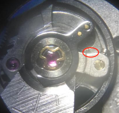

I know it’s me. I know it’s something I need to conquer. I always seem to struggle getting a nicely concentric hairspring when sitting on a balance to sit nicely and not bunch up the coils when I install the balance. Sometimes they sit beautifully, sometime not, and I’m annoyed with myself for not knowing why. Anyone able to point me in the right general direction? I know HS are a book or two on their own but this keeps happening and is driving me crackers. (HS and watch demagged and clean and dry).

Are these pics of the same balance wheel?
If the balance in the first pic (the one from below) is sitting with its pivot in the hole and the second is the same balance then I think the problem is with your technique in installing the balance wheel. Perhaps you could elaborate more on how you get the balance in place?

Yes, same balance wheel. It’s technique that I’m asking for help with Anilv so I’ll try again with yours. Currently I’m in the dangling club and I can struggle to get the impulse engaged a bit.
The first pic shows a hairspring & balance in good condition. The second pic shows a hairspring that is either contaminated, magnetised or just damaged.Where the last coil attaches to the end stud has been bent inwards see pic. I would remove clean with a de- greaser, de-magnatise and install again before any manipulations.
It's the same balance, the pics were taken about 5 minutes apart. Only thing that had changed was to move the regulator back towards neutral as it was pointed a little to one side.
It has been cleaned a couple of times (in lighter fluid and hung on a post with the HS dangling to dry) and demagged several. Maybe I need to buy a compass to check if my demagging is working.

Magnetism does not make more difficult to fit a balance.
Also, I recommend that you use petroleum ether or other purified chemical instead of lighter fluid, and do not let the balance dangle on the hairspring.
Take another pic with the balance sitting on top of the balance cock... If the gathering is damaged the pic won't be as nice as the earlier one.
The problem with the dangling balance method is that it's a bit fiddly for watches like this Seiko.  It's fine for Swiss handwinds where the balance pretty much drops straight in but on watches where the balance is partially covered by a bridge the potential to snag the balance is higher.
Anilv
I would say that the lighter fluid is just not enough to clean hairspring properly. At least rinse it in acetone and try again.
anilv is right, the dangling balance method is not suitable for watches where the balance is somehow covered. My method is to hold the cock and balance together with tweezers and put them where they have to be (approximately). After that I can manipulate with the cock only and put everything in place. For other watches the dangling method works just fine.

That's because the hairspring is distorted.
It takes a lot of magnetism or grease to make coils actually stick, even if these reasons are usually blamed first.

Pip, there is a checklist regarding hairsprings in regular watch service. I will not write it again you should do that first.
But if it is surely clean and demagnetized then i would check the end curve is following the regulator pin path. It looks like the end curve or the HS attachment point, or the start of the end curve is distorted making the HS off center.

No, that's not the reason. Seiko hairsprings are extremely easy to get distorted, and equally difficult to correct. read below:

With my small blue electrical demagnitizer. You know the standard type from china. Seems to work ok. I've downloaded the Lepsi Mag app that was recommended by @VWatchieand it's showing no magnetism present.
I think that I need to up my HS cleaning game. I can't seen anything untoward on it but that doesn't mean it isn't there.
